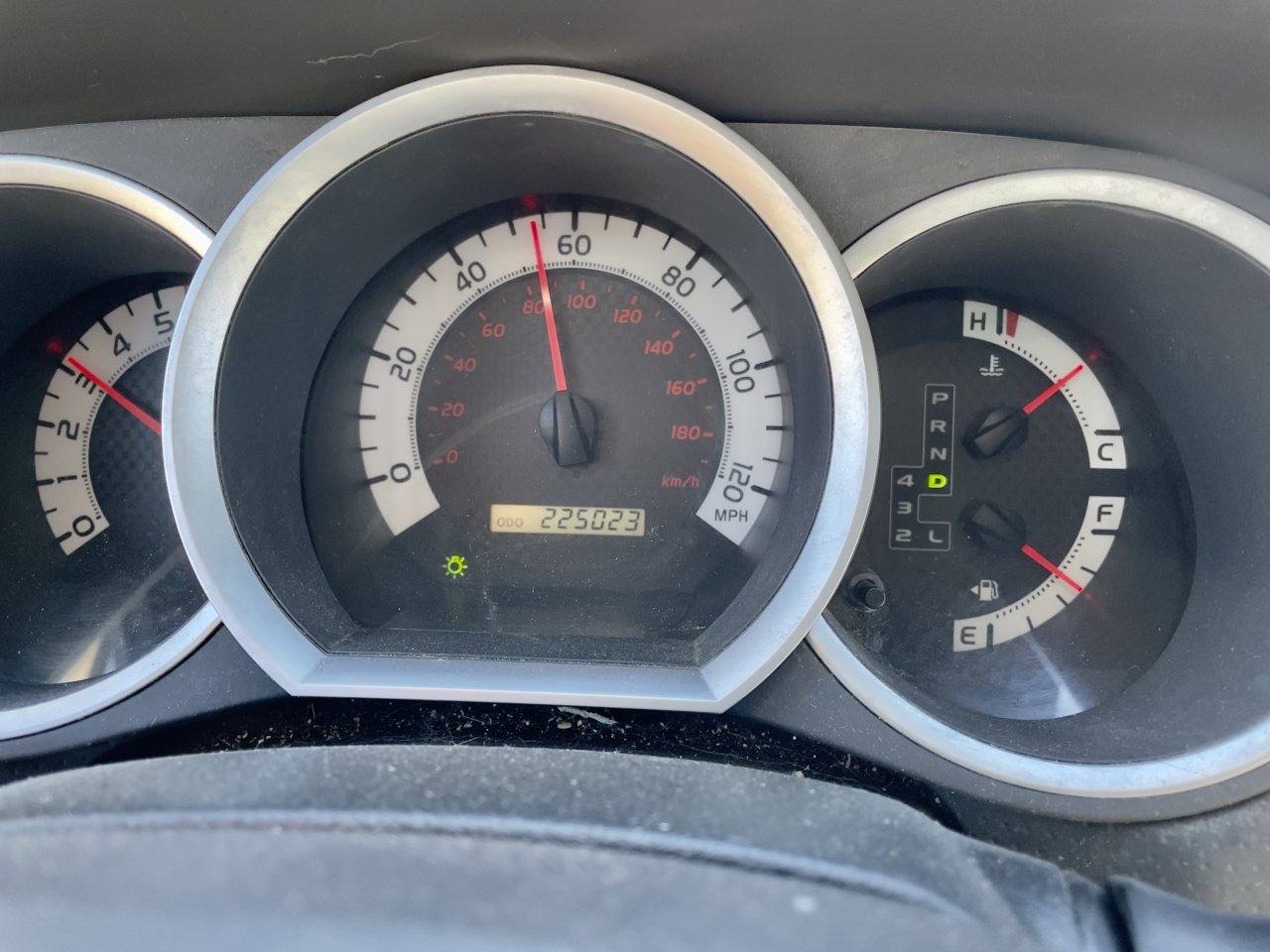

    My trans has had no service until 224,9xx miles (I have owned since new). Just bought a travel trailer and figured better late than never. I swapped out ~4.5 quarts of good looking/smelling used ATF following this procedure (had to wait ~5 minutes for the temp light to stop flashing as it was relatively warm out). I had about 2 days of normal driving (not towing) before we embarked on a 2800 mile road trip (Hood River Oregon-Page Arizona and back). You could say I'm bold if not very smart...but everything worked out fine!
    Like another poster above I'll be completing this task several more times over the coming months...
    Thanks for the helps guys.
