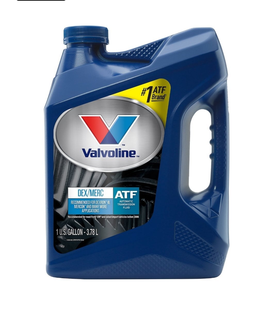

    This is what the store recommended

    @Bluefadedstars The label in the back does not show it is for Type IV ATF.
