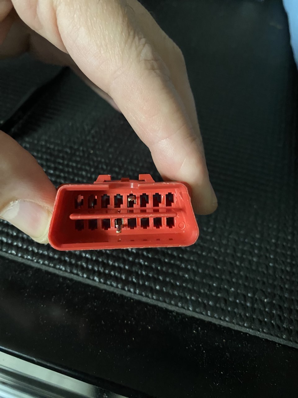

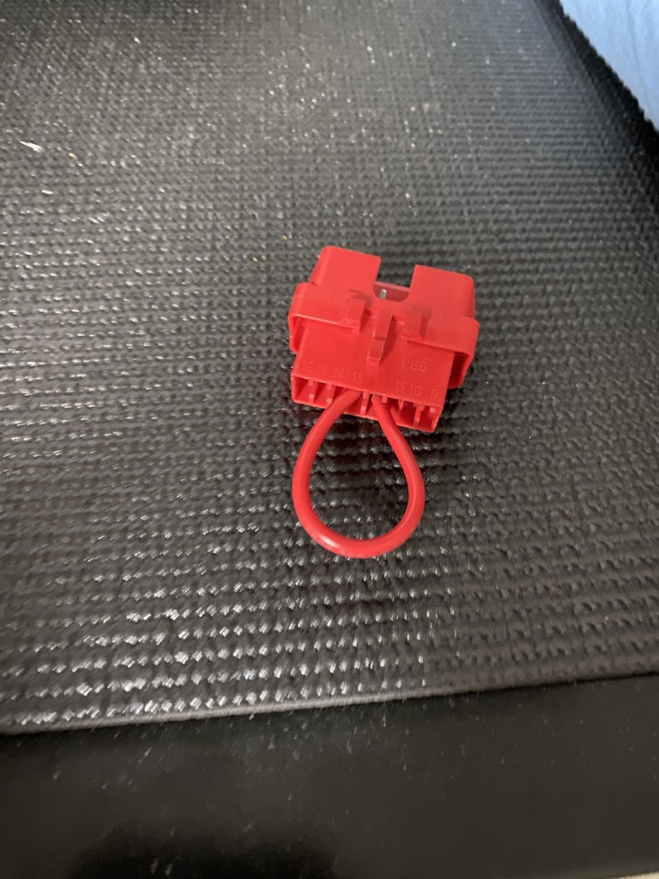

    To answer the unanswered question on this thread about 08 Tacoma Prerunner having the ATF light. It does. It does not light up during normal key on. If you shine a flashlight to the cluster in the area you will see the outline of it. It will light if you follow this procedure. Never knew it was there for 20 yrs.
    I am going to do this service. I practiced the jumper method and got the atf light to work. I bought a OBD2 connector from Ballenger to make jumping easier. My
    Jumper is in empty connector with jumper to pin 4 and 13. The last thing you need to do is damage your Obd2 port with repeated paper clip jammings. Plus it’s easier than bending over and counting the ports with your head upside down. For those of you doing this on the regular it might be helpful. The connector was super cheap. $15 including shipping.

    Thats the method I use with the dongle, thanks to TW I made one 2 or 3 yrs ago and it makes life easier.
