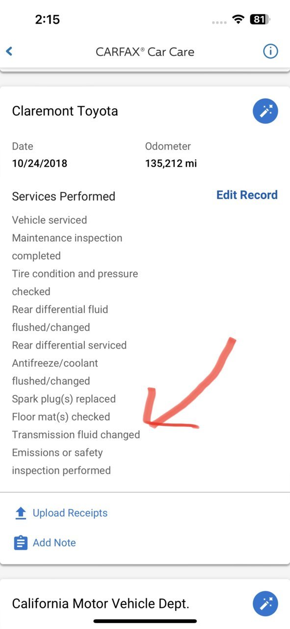

    Thank you for this. I figure that I would need to Drain/Fill a couple of times to replenish the transmission with the cleanest fluid possible after driving it for some miles? I know Toyota based on my maintenance log they provided recommends every 60k.
    what would be the best mileage intervals to get the most quarts drained and cleanest fluid?
