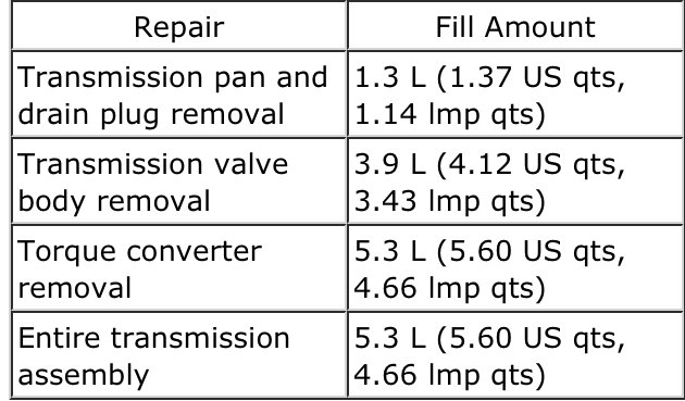

    Use the Valve body removal specs.
    Buy 5 qts. Take one back if needed.

    For a full change, 10.5 quarts without tow package, 11.1 with tow package. Easiest to just buy 12 quarts. Just a pan drain and refill takes about 4.

    Not exactly, first post discusses volume lost when draining the pan, but replacing the strainer requires a pan drop and will result in significantly more fluid lost. My experience is about 3 quarts for a drain and fill, 4.3 quarts to drain, drop the pan, and remove strainer. I’d refill with 4 quarts for the former, 5 for the latter, to ensure good overflow check and account for an under fill if never refilled before.
