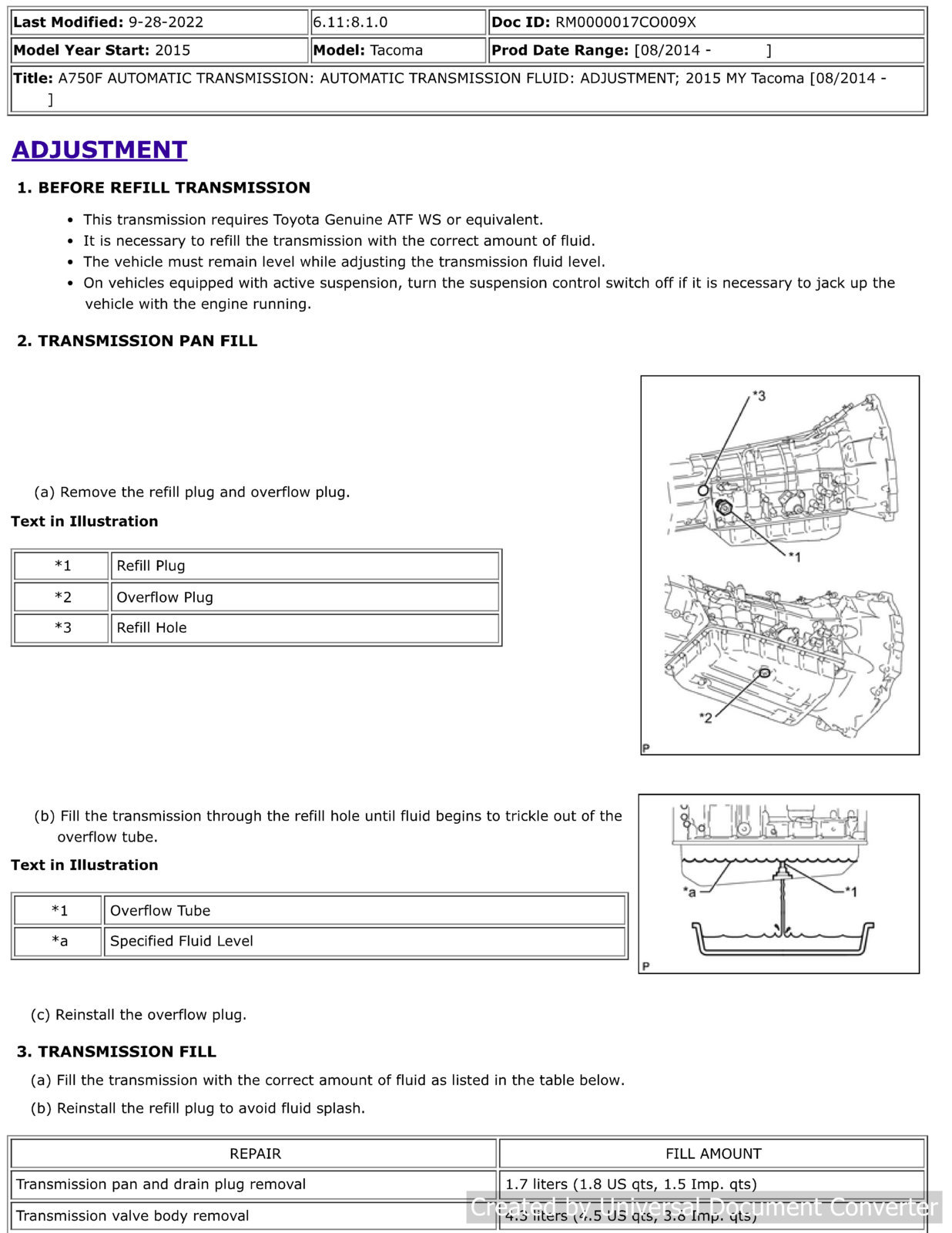

    The reason i ask is that I am going to use this to get as close as possible the correct volume of fluid back in following the dropping of pan, changing filter etc. And yes I know there are other methods including measuring the volume of all the fluid that is drained and I did those on prior drain and fills.
    Prior to draining (cold and not running of course) I am going to pull the overflow plug and measure the amount that comes out.
    After the pan drop and filter change I will then add enough fluid to just have it start to dribble out (again cold and not running) and put overflow plug back in
    I will then add in the volume of fluid I measured from pulling the overflow plug in the beginning plus a teeny bit more.
    Will then do the engine running , temp tested volume check.
    Just want to get it bang on while cold so i don't have to bother having to add more while its hot and trying to avoid the hot exhaust pipe and running or have to wait till its cold to add more.

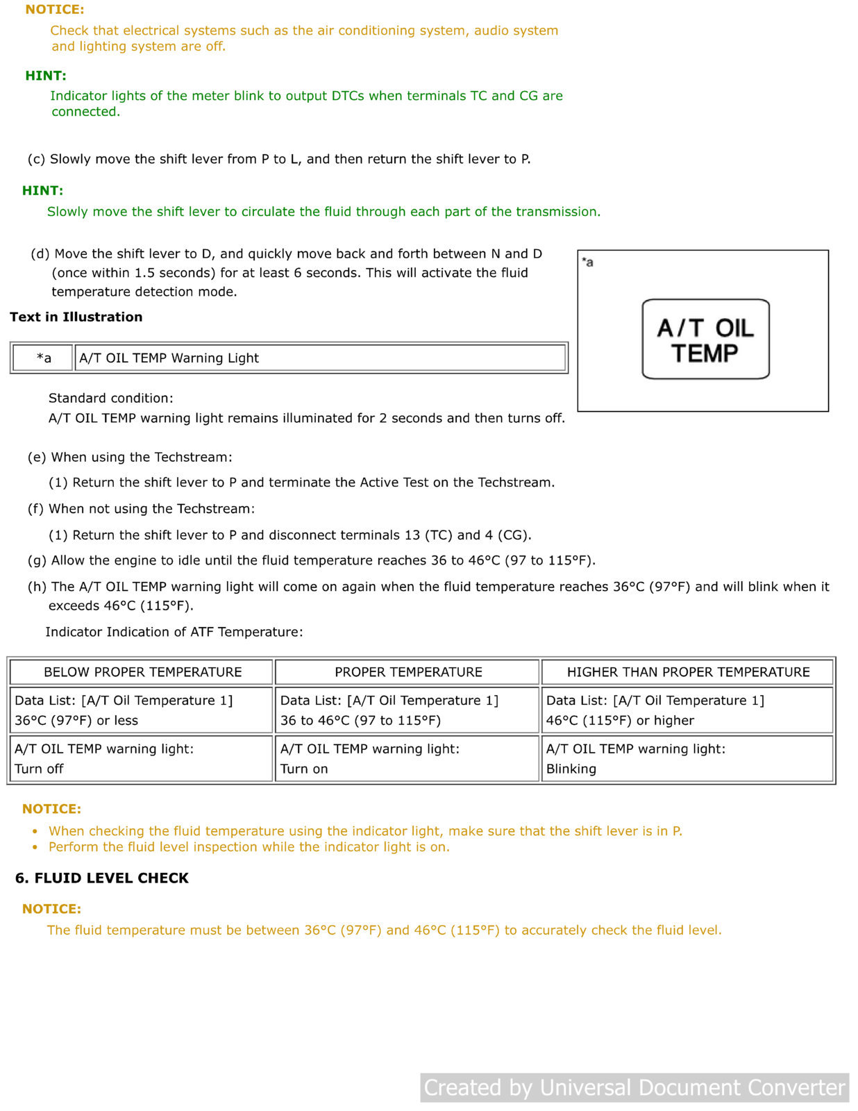

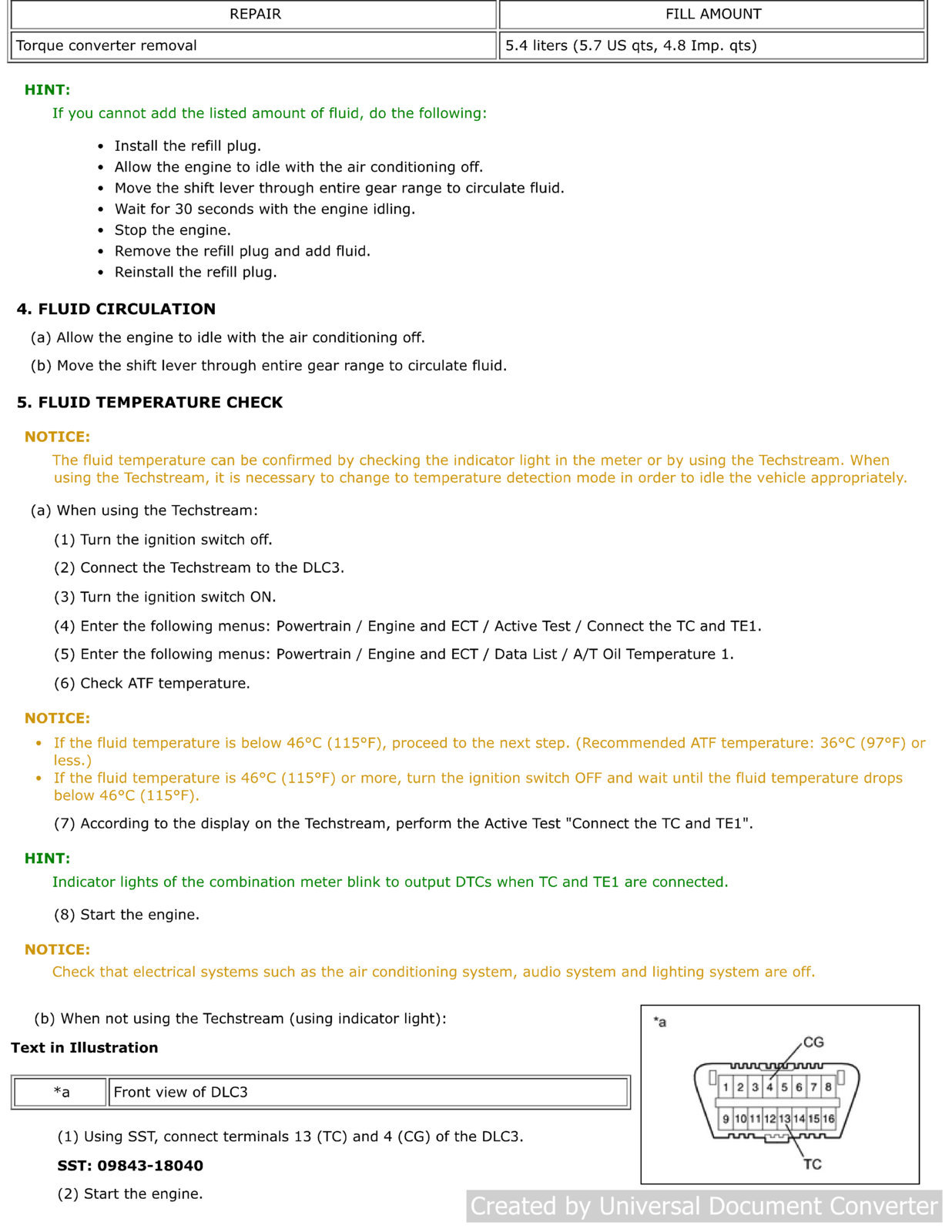

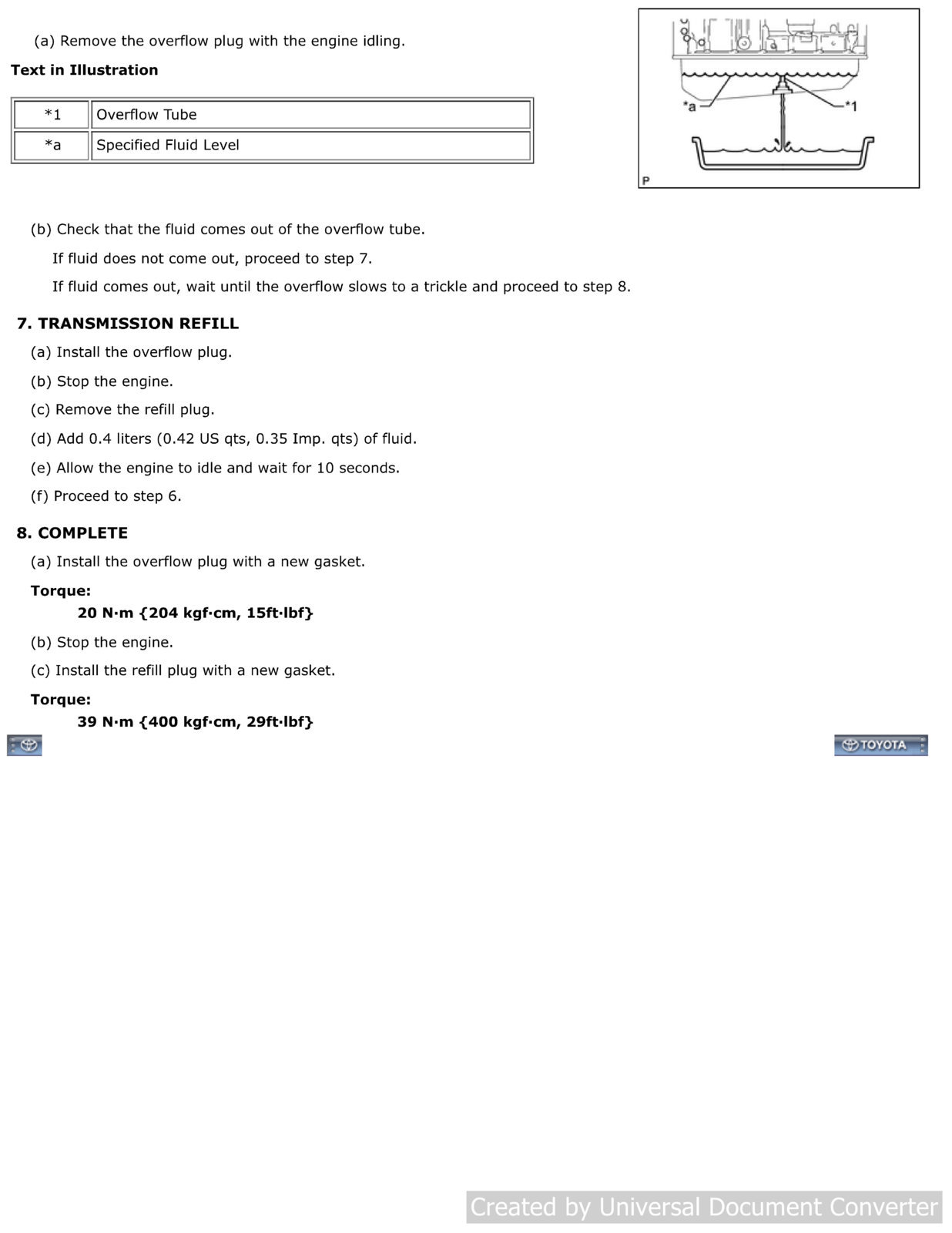

    The TSB really only applied to 04-08 vehicles with the A750 transmission that had the incorrect 115-130F in the service info, all later models the service info was updated to the correct 95-115F but alot of people on here go by the 06 FSM that is commonly found online and as such have the wrong info.
    From the 15 FSM.
    Micbt25 likes this.

    Predator tube steps, Ranch Hand grill guard, Magnaflow CatBack exhaust, Toyota tool box & bed mat, 2LO Module by @Up2NoGood, Rearview Compass/Temp Mirror, Tune by @JustDSM.
    The fluid temp stated in the OP is incorrect, per TSB-0129-08 the fluid temp must be 95-115 when checking. 09+ trucks had their programming for temp check mode changed to reflect this.
    Honestly it's much easier to just use a scan tool to read the transmission temp.
