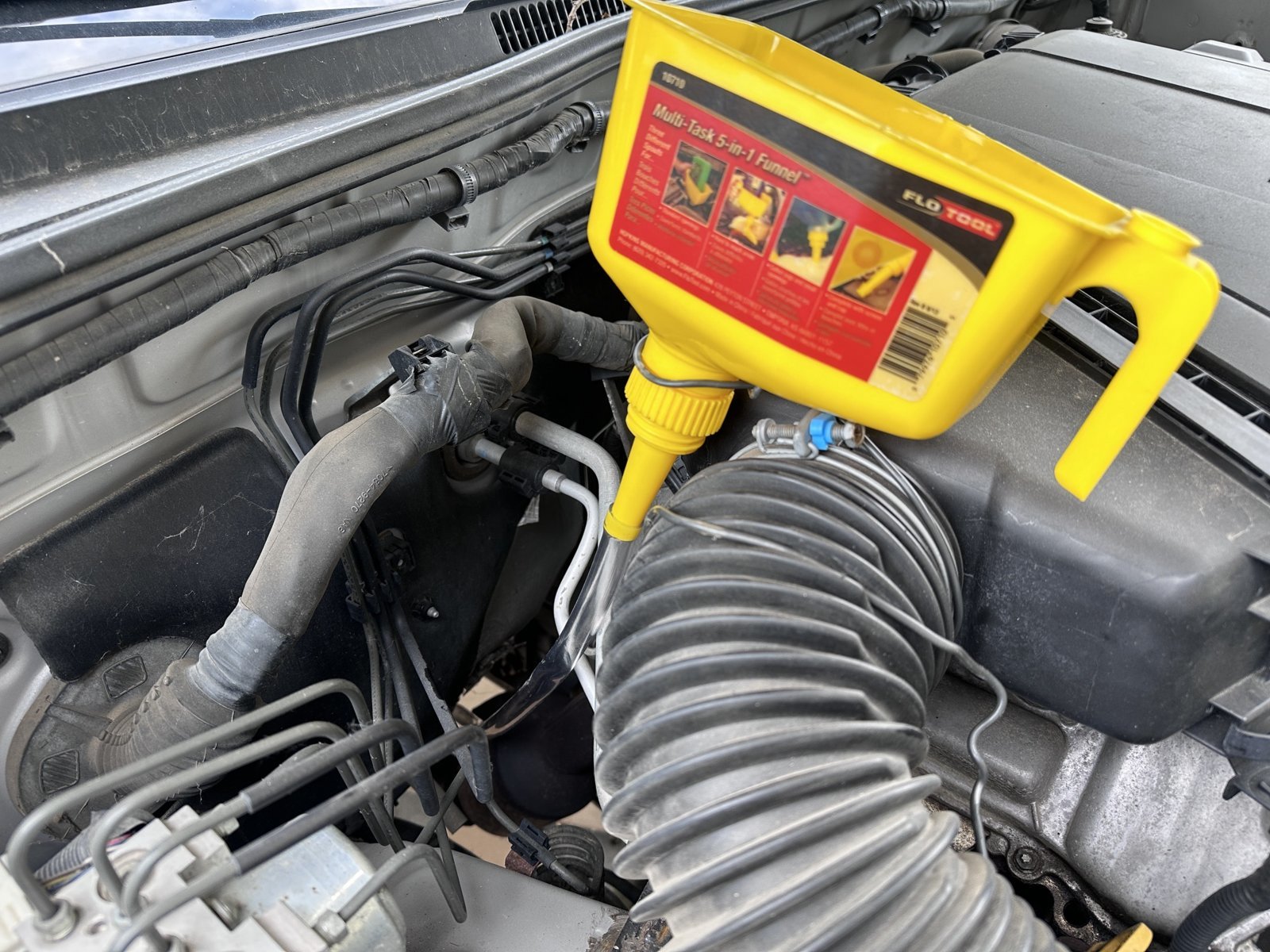

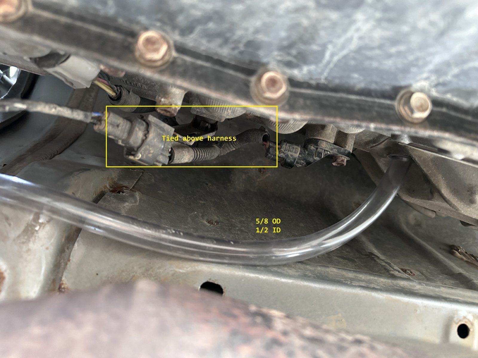

  15. Aug 13, 2024 at 4:49 PM
    #2255
    pipsqueek
    pipsqueek Member
    Aug 12, 2018
    #262562
    9
    Alf
    Sask Canada
    2008 Tacoma TRD DCLB
    2015 Bilstein shocks, Coilovers
    Finally got around to do a drain and fill. About 120,000 miles. Decided to see if it was possible to fill from above by the air cleaner. Bought 5/8OD 1/2ID clear vinyl tubing. Used a cork in the lower end of the tubing so no dirt worked it way into the tubing snaking it to the fill hole, removed cork and perfect snug fit into the fill hole, ran the tubing up to just behind the air cleaner. Tied tubing to harness by the fill hole so that the tubing ran above the fill hole. Measured new fluid approx same as what drained out. Poured it into the funnel and no gurgling. Will do this 3 times then set 115 temp and do fluid check overflow.

    Dm93
    Dm93 Test Don't Guess
    Mar 3, 2015
    #150066
    13,820
    Texas
    2014 DC OR 6spd 4x4
    Predator tube steps, Ranch Hand grill guard, Magnaflow CatBack exhaust, Toyota tool box & bed mat, 2LO Module by @Up2NoGood, Rearview Compass/Temp Mirror, Tune by @JustDSM.
    Nice setup.
    Note specified check temp was changed in 08 to 95-115F per TSB 0129-08
    The OP hasn't been updated to note this.
    pipsqueek[QUOTED] likes this.
