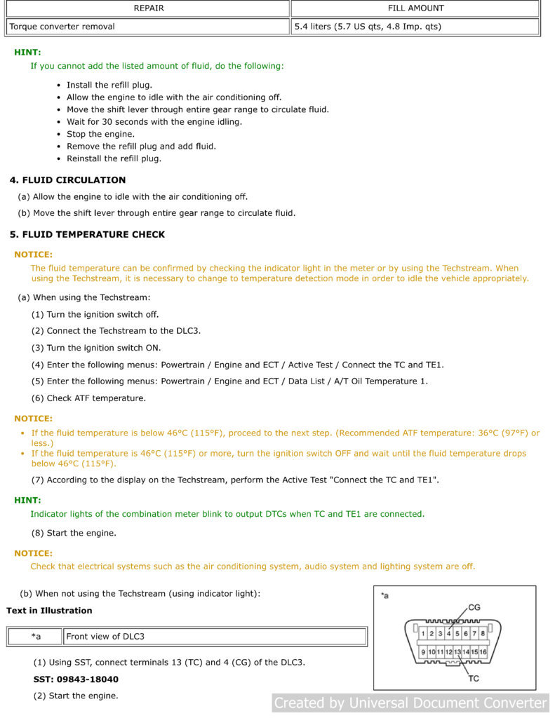

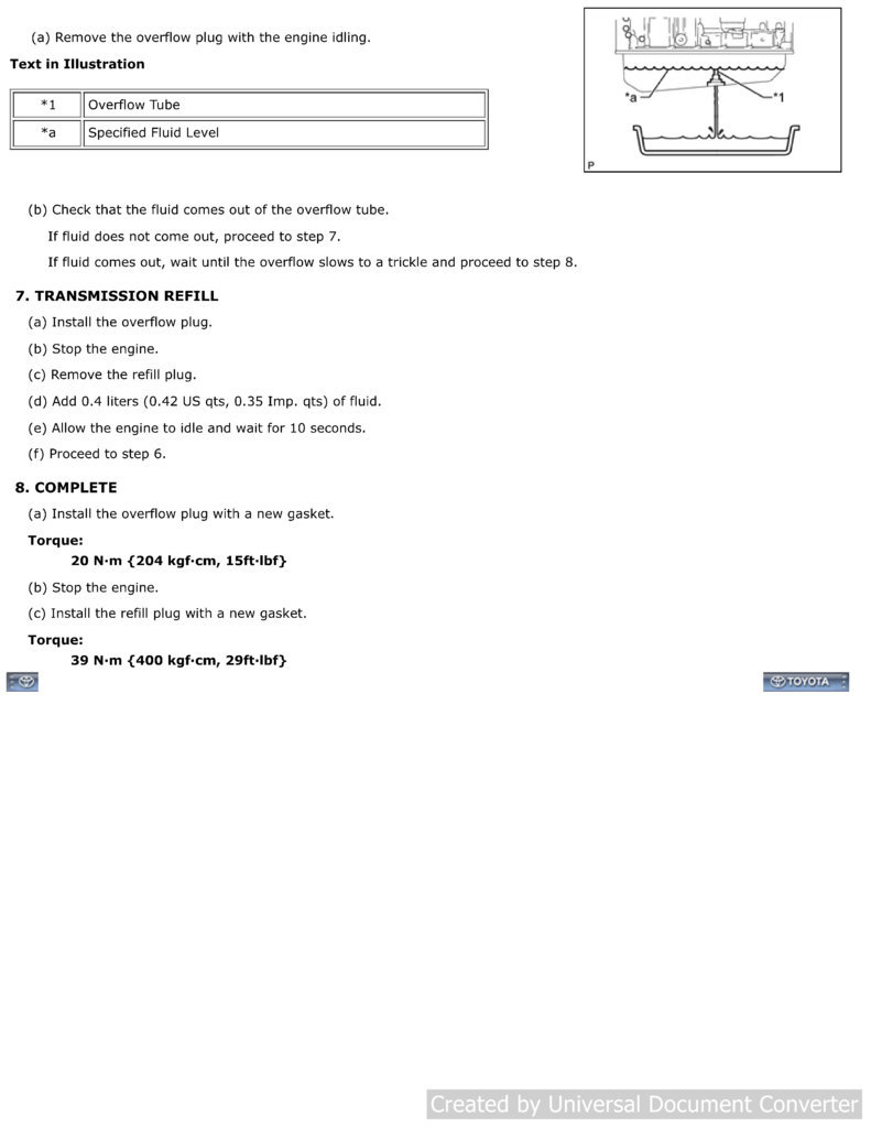

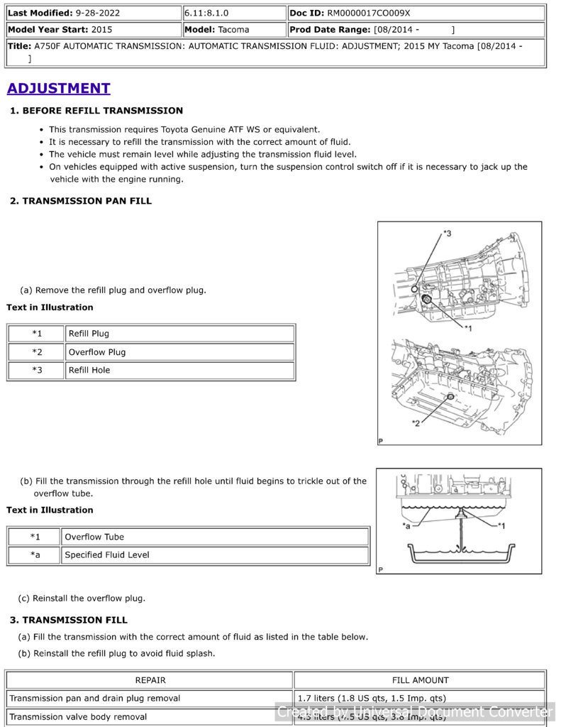

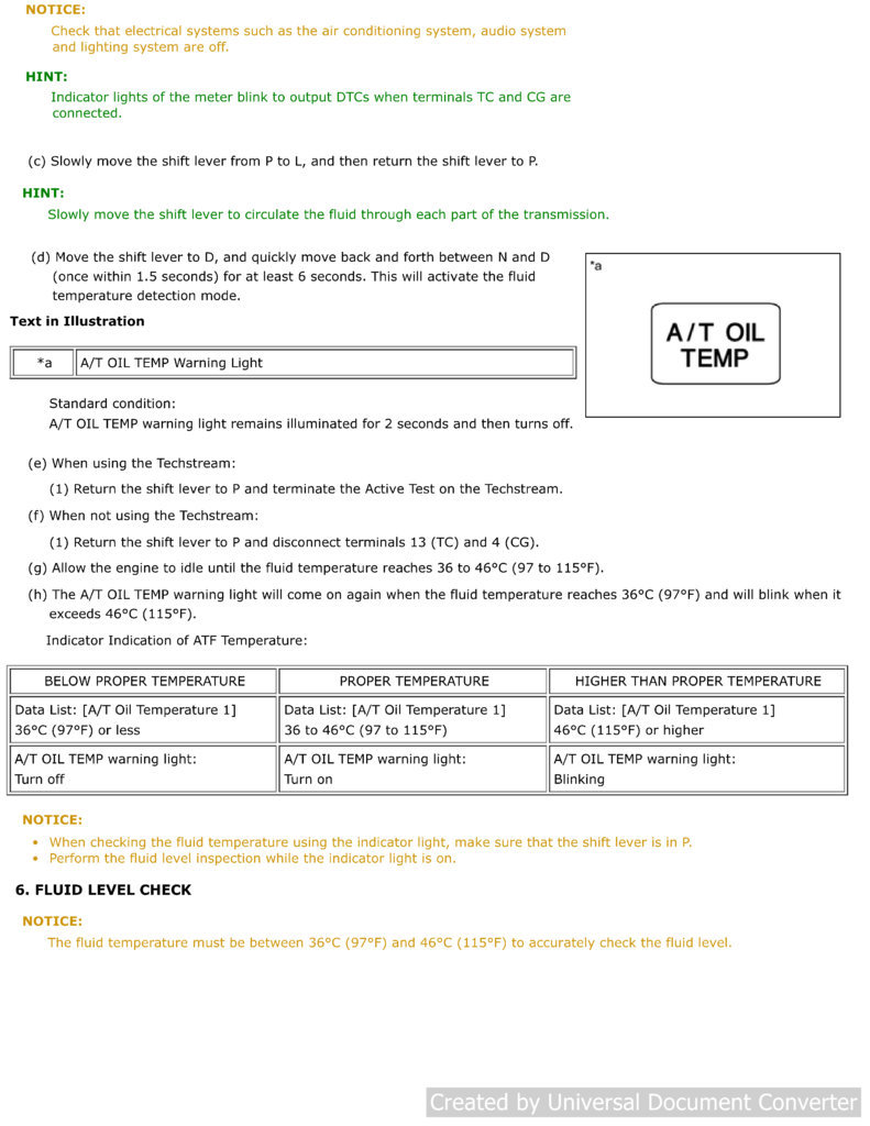

    Predator tube steps, Ranch Hand grill guard, Magnaflow CatBack exhaust, Toyota tool box & bed mat, 2LO Module by @Up2NoGood, Rearview Compass/Temp Mirror, Tune by @JustDSM.
    97-115F is the proper temp check range.

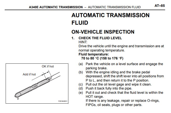

    My truck is a 2005 Tacoma 2WD 4cyl Access Cab Long bed, and i have not been able to find the fill port and over fill port (just the drain bolt). They dont seem to exist? ... I did look under the pan multiple times and came back and referred the pictures here.
    So, if i drain, how would i fill? And i still need to jump for the set temperatures? I do have a ScanGuage for my other vehicle.

    4 cyl only has a drain plug, you fill it through the dipstick tube and check it with the dipstick with the engine running in park.
    abhijitz[QUOTED] likes this.

    Thanks much. And, I guess i dont need to do any of the pin/wire jump procedure? on the OBD connector, as i dont happen to see the A/T Temp LED/bulb on the dash

    There is no temp check mode on the A340 trans, it should be in the cool range on the stick when cold and in the hot range at operating temp (158-176F).

    Thank You very much !! ... That page is helpful.
