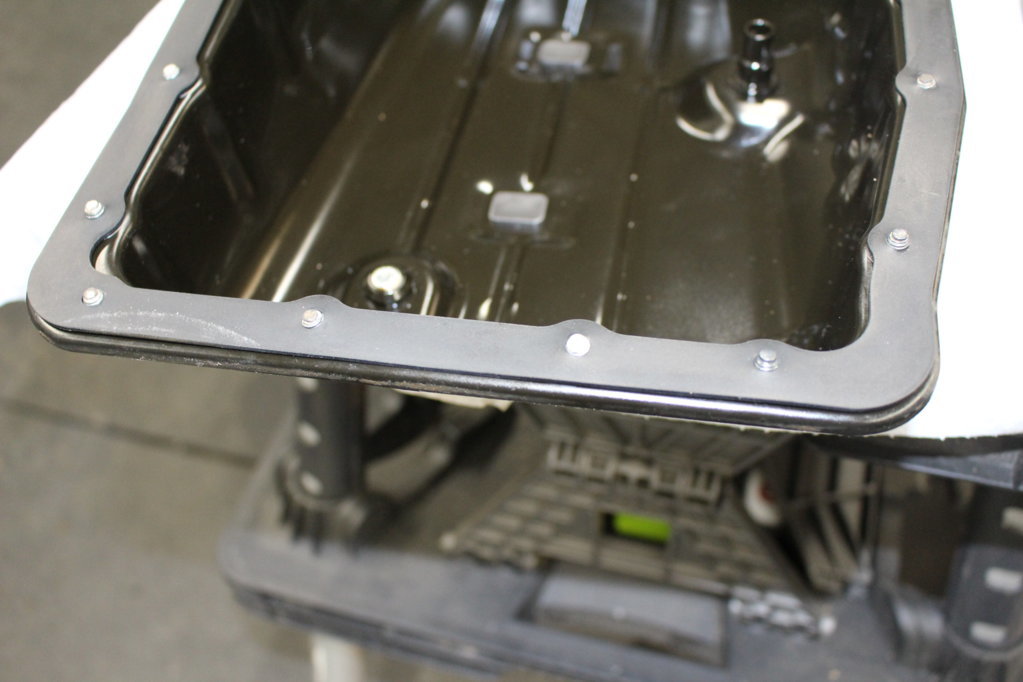

    Safe to assume all 2nd gens share the same gasket? Also maybe a silly question, do you put any gasket like sealant on it as well or just line the gasket up and torque to spec?
  14. Mar 26, 2025 at 6:13 PM
    #2314
    blnewt
    blnewt Active Member
    Jan 7, 2025
    #463728
    37
    Brad
    2015 Gray metallic Double Cab V6 4x4 SR5
    As long as your pan wasn't torqued down improperly or dented there should be no need to apply any RTV on it. Here's my gasket install, I recommend threading the bolts through the gasket a couple threads so the gasket stays aligned and makes it simple to install the pan that way.
    FWIW, the WIX filter # 58136 is the same part # for your 2006 too!
