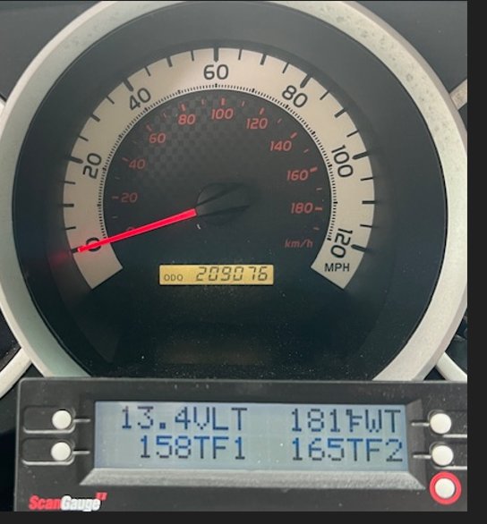

  15. Aug 9, 2025 at 8:02 AM
    #2335
    kwanjangnihm
    kwanjangnihm Timeout Terminator
    Nov 26, 2012
    #91851
    4,365
    Jeff
    Central Florida
    13 DCLB TRD SP PR OTT
    "If it ain't a longbed it ain't shit! :)
    @Dm93 thank you for posting this. :thumbsup:
    I installed a ScanGauge recently and want to use the trans temp to check the level after I install a new trans cooler next weekend.
    It took me a few threads to find this info and it would be nice if the OP updated the initial post.
