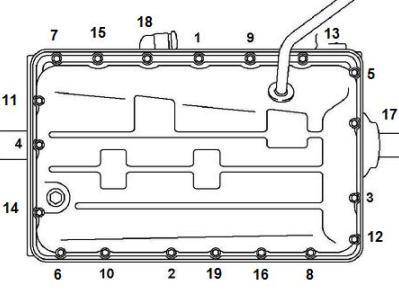

    Does anybody know if their is a tightening sequence for the transmission pan bolts? I need to replace my pan. I did some searching in the FSM but did not find anything.
    I figured I would start in the middle of the pan on both sides and then go to the opposite side, back and forth all the way around the edge till all the bolts were in.

    I would use a new gasket. I did find the torque specifications .
    Code:
    Drain plug x Oil pan = 21 ft.*lbf
    Overflow plug x Automatic transmission = 15 ft.*lbf
    Refill plug x Automatic transmission = 29 ft.*lbf
    Oil pan x Transmission case = 39 in.*lbf
    I still don't know the proper torque sequence but I assume a criss-cross pattern will work just fine. I did find this diagram for the A340F transmission. I don't think that the tightening sequence would be that different for our transmission pans, but who knows :)

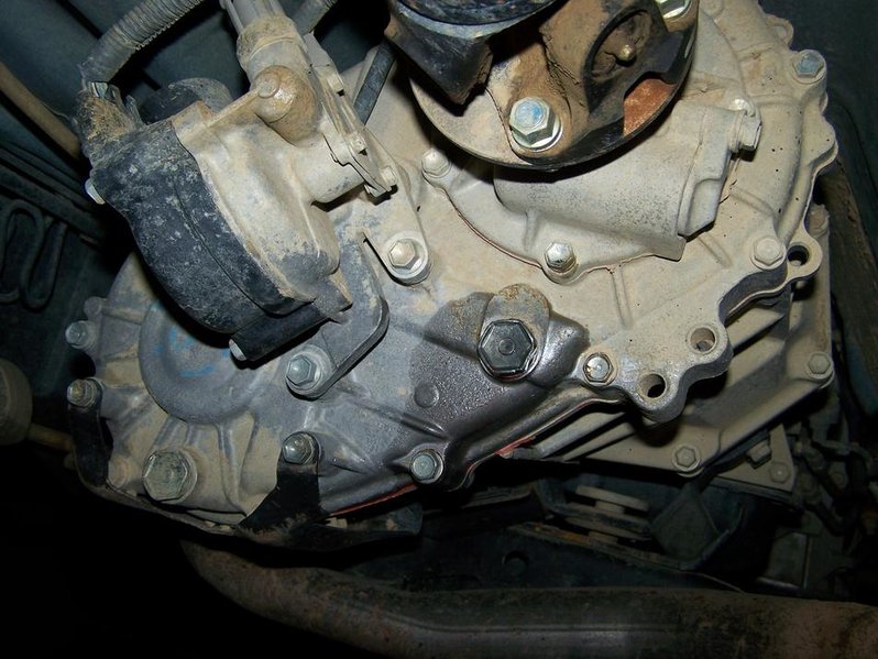

    shit, i followed each step exactly as it's written up here but ran into a troubling issue when i went to replace the fluid...when i pump ATF in the fill hole it just runs right back out like its full to capacity already. any ideas? when i drained it (from the 14mm drain plug at the rear DS corner of the black AT pan) i collected about 4 quarts. just for clarification, the fill plug is located on the PS rear of the tranny just below where the rear drive shaft comes out right?

    Seems like you did it correctly according to the 2nd & 3rd photos of this thread. Truck parked on level ground? Transmission in park (don't know if that makes a difference or not). :confused:

    in park on level ground...totally stressing about this! i really think that i am trying to fill from the wrong plug. the only 24mm plugs i could find are on the back-end of the transmission (really seems more like the transfer case to me) instead of being on the passenger side of the whole unit. In the first pic you can see the plug that i have tried to fill from. the second picture is the passenger side of the transmission...from other pics and diagrams that i have looked at the fill plug should be where that black plastic electrical sensor of some sort is on the top left of the image. this is driving me nuts!

    Please look at the second and third pictures of the thread I linked to in my previous post. Those pics have arrows pointing to the correct transmission fluid drain, fill, and check plugs. From your picture it looks like you were adding the transmission fluid in your transfer case's fill port, not your transmission pan!!! You need to drain and fill your transfer case oil immediately because you contaminated it with tranny fluid. Check this thread (click here) for that procedure.

    im a little reluctant to admit this but...yep, its there alright! I drained the tranny but tried to fill the TC. the pic form the OP looked just different enough (prerunner vs 4x4) that i overlooked the correct fill plug b/c it was just barely covered in dirt. dingdangit! dont i feel silly. thank you for insisting that the problem WAS this simple; i really had myself worked up about it.
