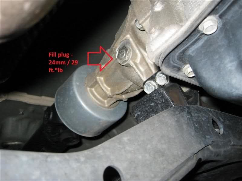

    First...can someone please post a picture of exactly where the fill plug is for the 5 speed auto, four wheel drive? I think I have a good idea, but am really doubting myself right now. I partially rounded the head of the bolt that I thought was the fill, and went to the stealership to order a new one before I comitted to taking it off, and they ordered the wrong one. Second, does someone have the part number for the correct plug and o-ring? The diagram at the parts counter absolutely sucks and I cannot make heads or tails of what's what. Thanks a bunch in advance for any and all help someone can provide. Also...a current link for any service manuals would be awesome too! Have a great day!

    I don't have any pic, sorry... But it is on the passenger side, pretty high up close to the floor of the cab. I cant remember how far back it was, maybe right around the passenger door??? The bolt has a "WS" stamped on the top of it.
    I didn't replace the rubber O-ring on the fill plug, just the metal crush washers on the drain & overflow plugs. I don't have a part number at the moment.
    I might be able to get some pics this weekend if no one can get them sooner.

    This was posted by Mountain Lion on Toyota Nation.
