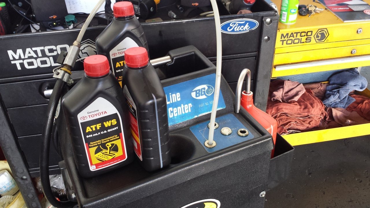

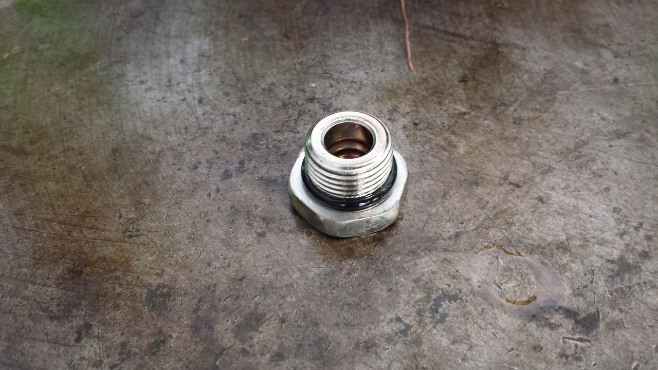

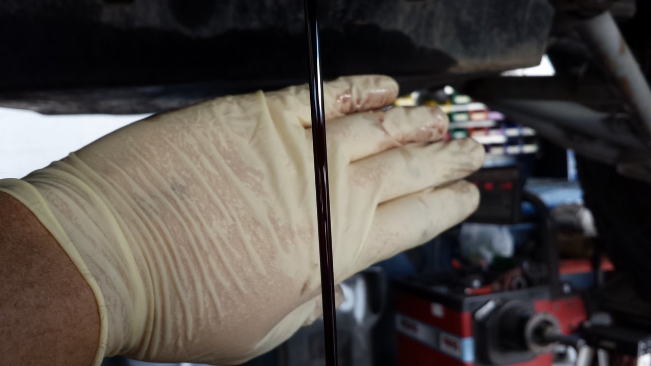

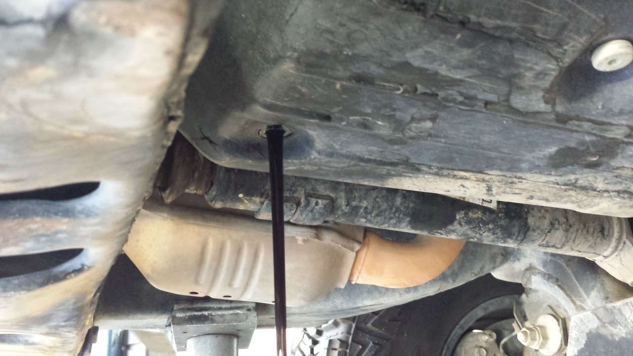

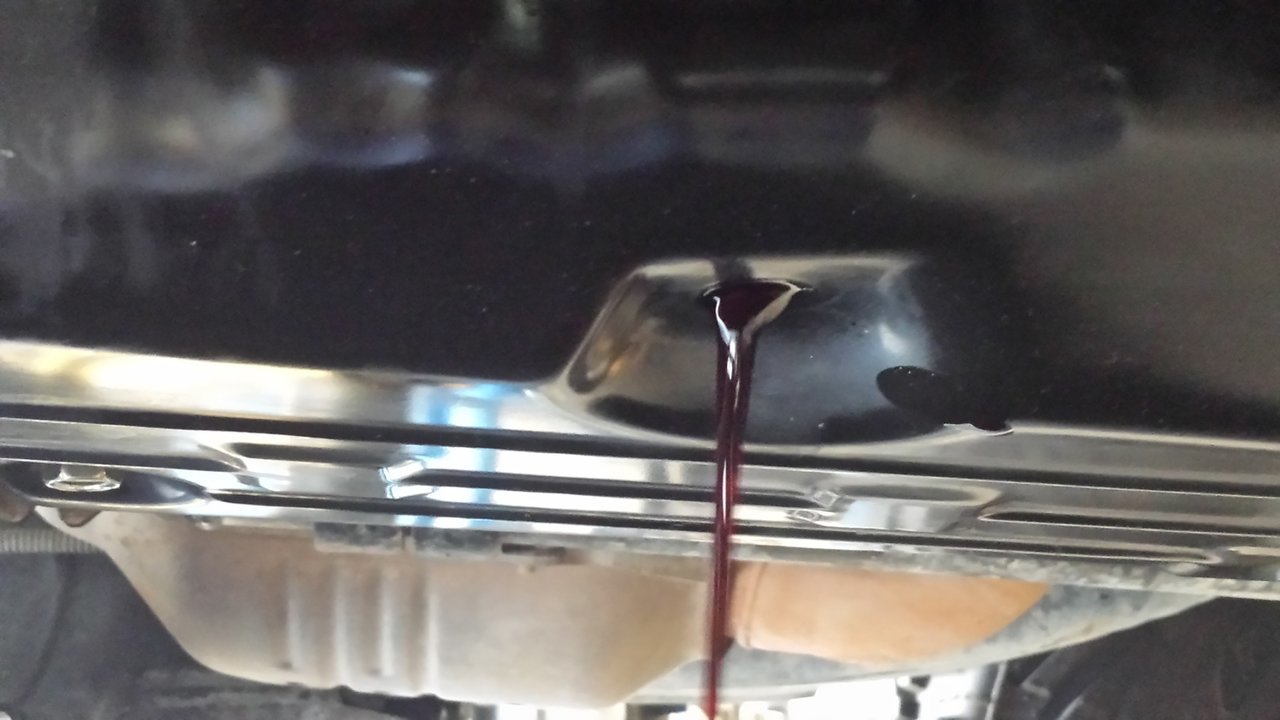

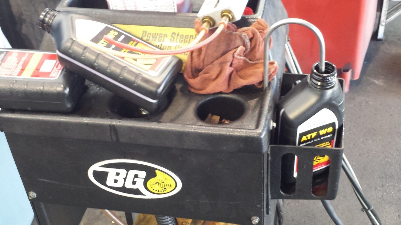

    big thanks to Fortech in making this excellent thread. made it easy!
    recently i have been experiencing a shuddering sensation coming from the transmission when accelerating from a complete stop. this is a common symptom from a automatic transmission with low fluid levels. and with the fact that i'm at 90k+ miles without any prior transmission services with heavy duty off road use and regular towing, it's time to perform a drain/refill service.
    5qts. of Toyota WS trans fluid because i removed the transmission pan..

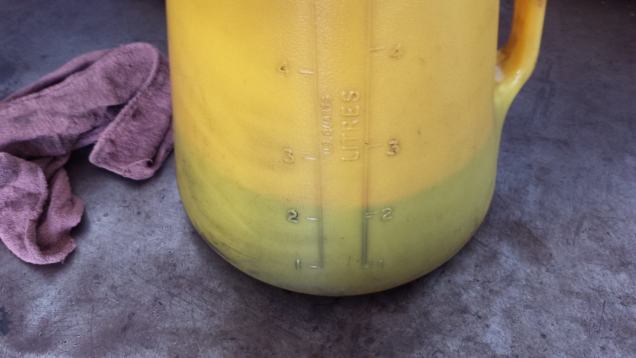

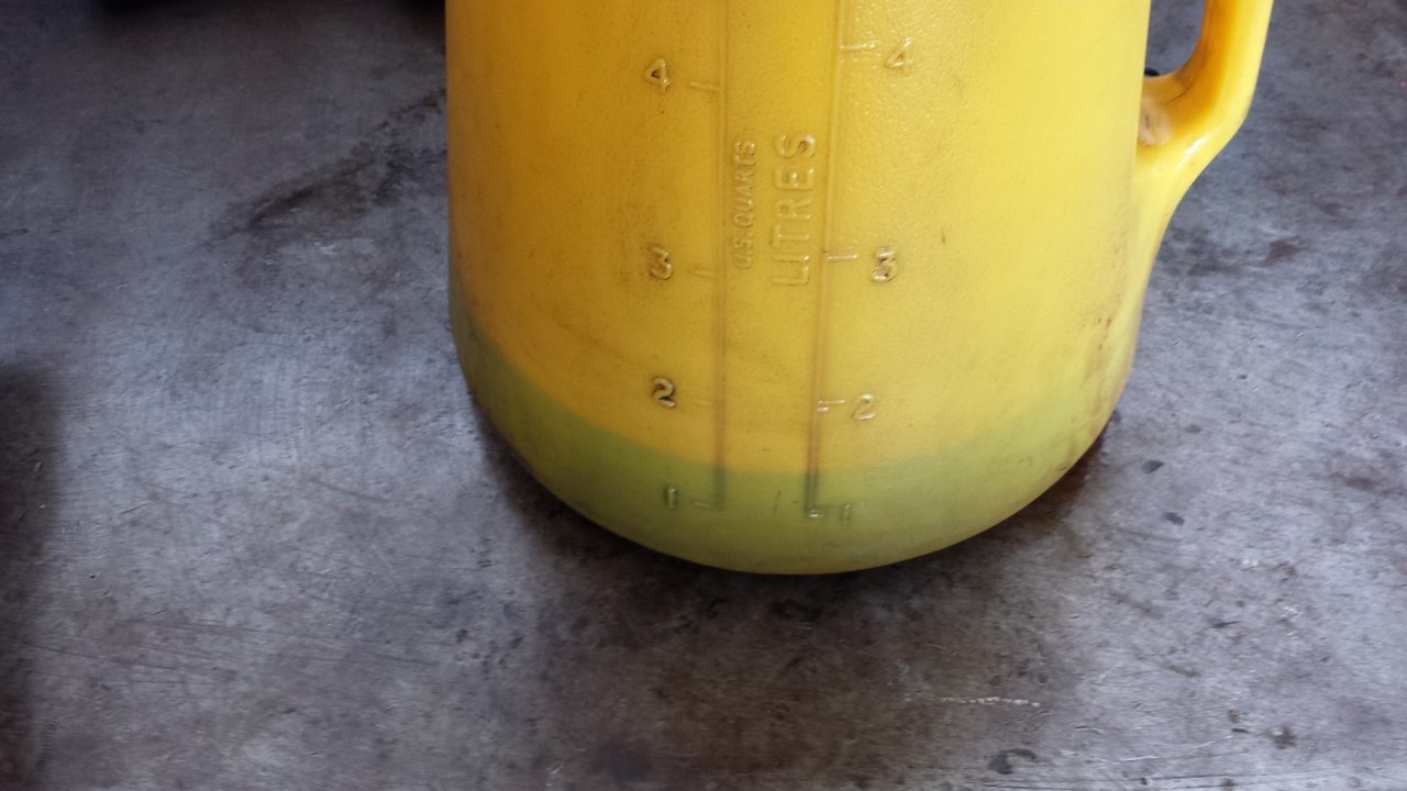

    removed the drain plug, my fluid is very dark with a slight burnt smell
    this much drained out, approx. 2 1/4 qts. low

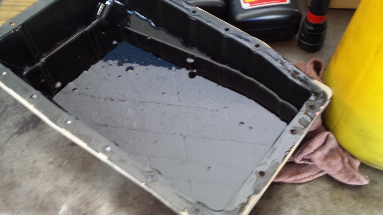

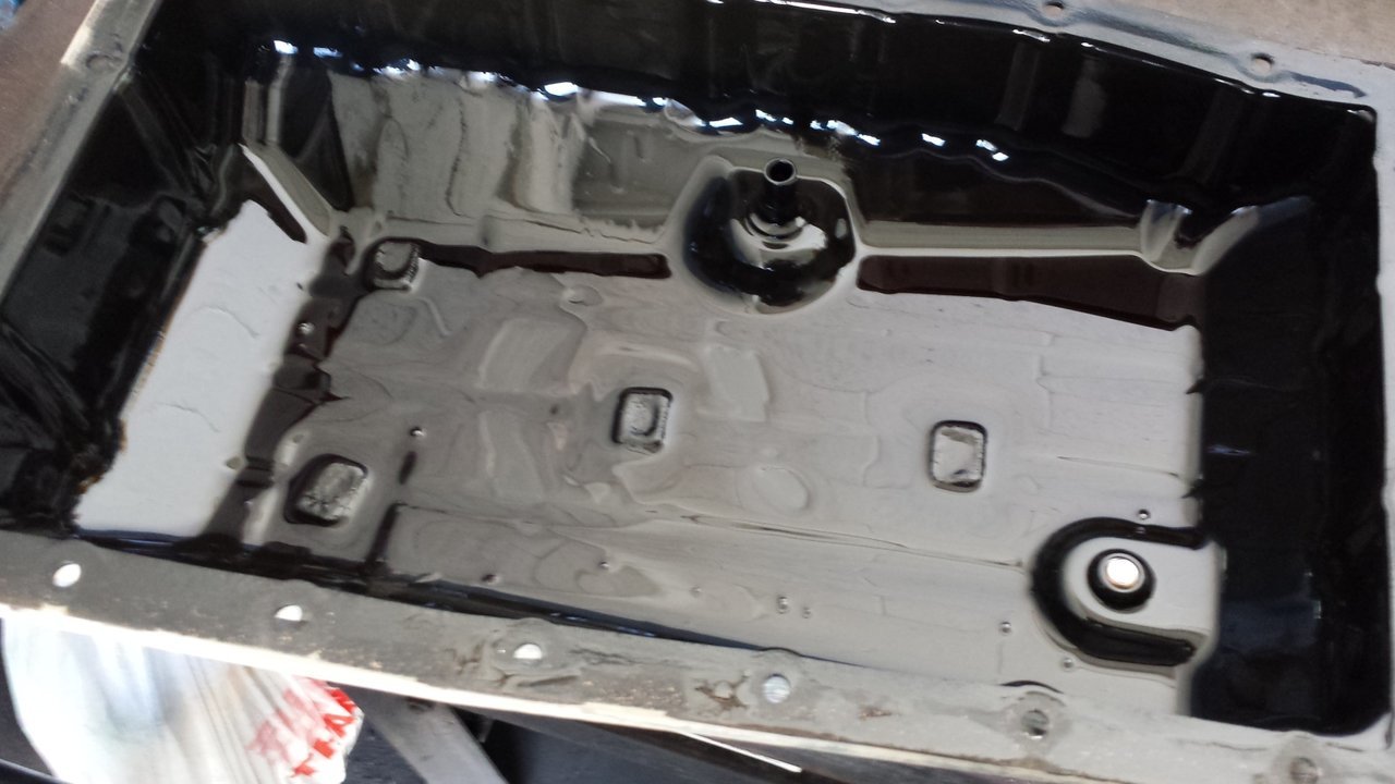

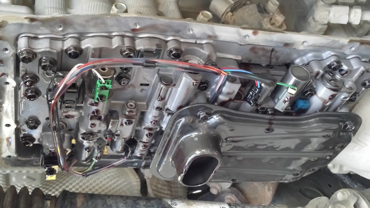

    had this much fluid still inside the transmission pan
    bottom of the pan was a little thick with fluid residue but not gunky

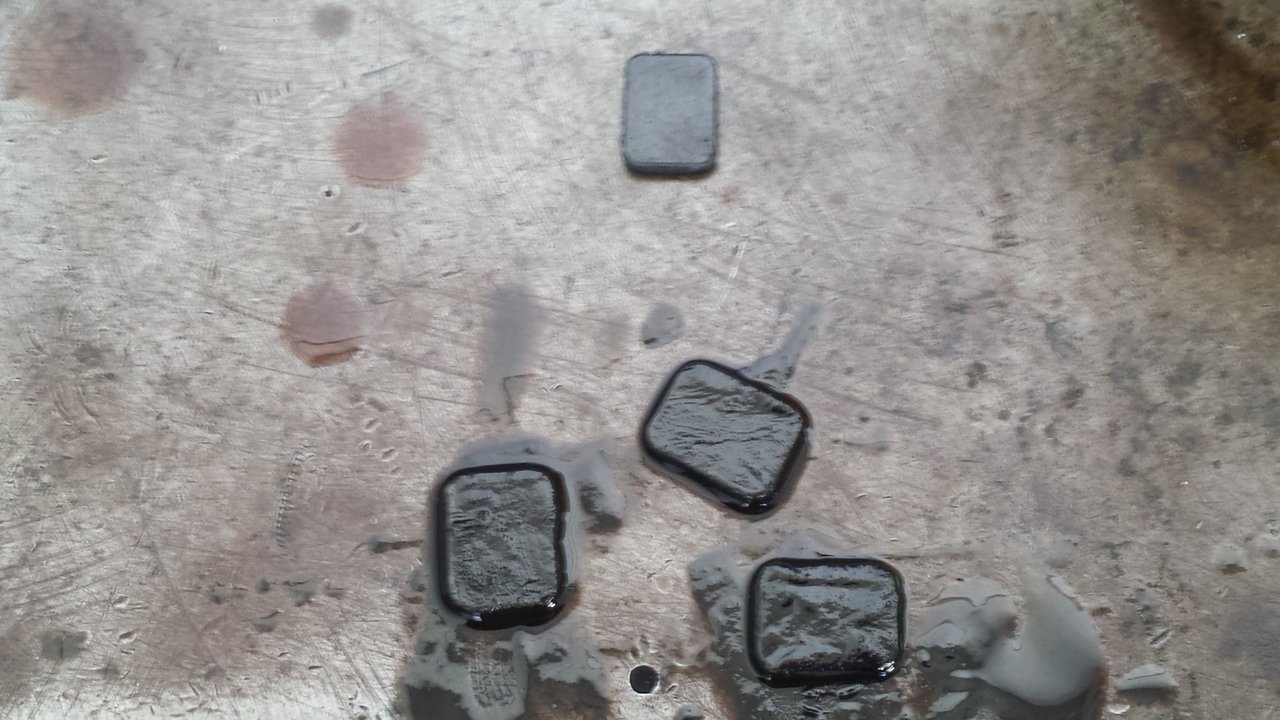

    3 dirty transmission pan magnets compared to the freshly cleaned magnet
    clean pan ready for install

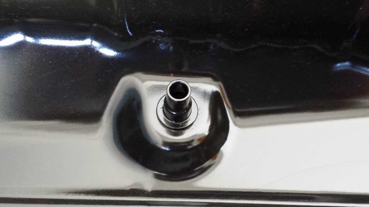

    over flow drain tube
    over flow drain plug

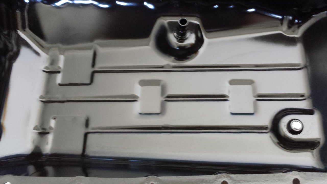

    whats on the inside of the transmission pan

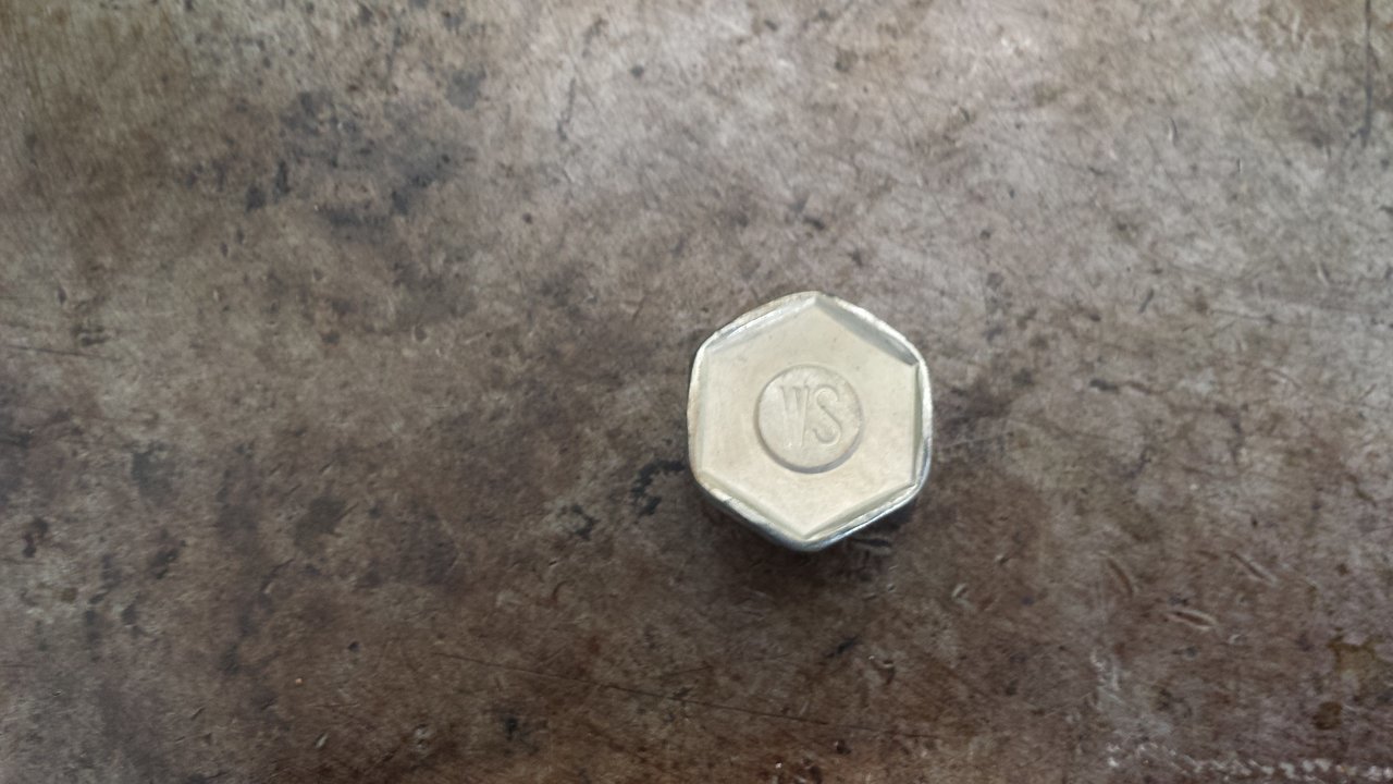

    transmission fill plug marked WS
    filled transmission with 5qts using a machine :cool:

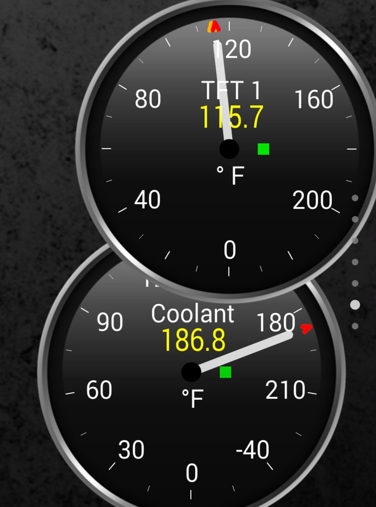

    used the Andriod Torque App to monitor the correct fluid temperature

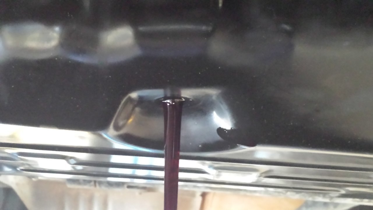

    draining excess fluid after reaching the correct temperature;
    steady fluid flow
    almost at a trickle which indicates proper transmission fluid level, approx. 1/2qt drained out
    the whole service took about an hour to complete with a good part of the time that was waiting for the transmission fluid to reach the proper temperature. right away on the first test drive the shudder sensation was gone and the shifting felt significantly better. also idle is a lot smoother while stopped at a traffic light.
