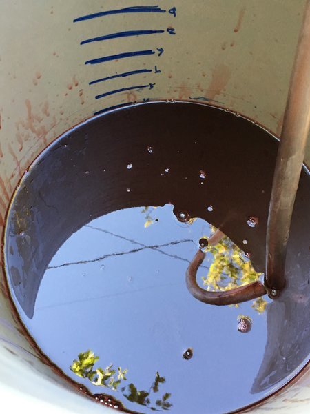

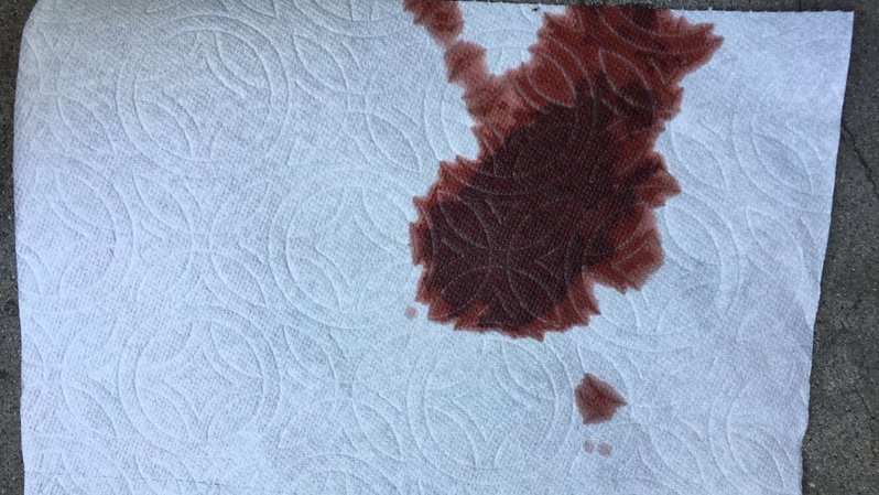

    Just finished my drain/fill. I only have 32,440 on the ODO, but I plan to do a drain/fill annually (maybe not again til 60k), then drop the pan at 100k, replace filter and gasket and do a full DIY flush. Fluid was 22oz. low, presumably from the factory. I have a 2012 4X4 SR5 w/tow package.
