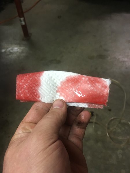

    I mixed WS and Maxlife the last time. It's shifting great, I'm not worried about it. My truck has 80k, it was flushed at ~60k with WS via the cooler line. The factory fill was black, this time the WS that came out looked new with 20k and 4 years on it. That includes a lot of short stop and go trips and a lot of heavy towing.
    If you're doing a drain and fill, drain the pan and put 3.5 quarts back, then do the temp check procedure, unless you have an ultragauge or scangauge, then you can pull the check plug between 97°-115° at the pan.
  8. May 1, 2017 at 5:26 PM
    #888
    07 sport 4x4
    07 sport 4x4 Well-Known Member
    Dec 24, 2010
    #48165
    1,454
    Blake
    Southeast
    2017 Duramax
    If you're at 60k you might ought to go ahead and do a cooler line flush, it's easy and that way you have almost all new fluid. I just did a drain and fill this time because the fluid was pretty fresh and looked good coming out of the pan. I also have a spin on remote filter to keep the contaminants down and remove the suspended clutch material from the fluid.
