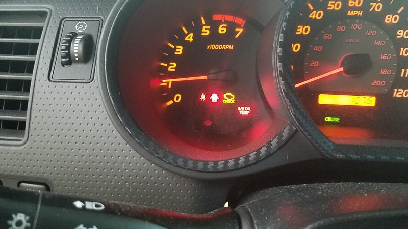

    It took about 20 seconds to get to temp (after it was running for the circulate fluid step)

    Just did mine today and yea ran trans through gears and got it to temp check mode and when put in park AT temp lite stayed on. Drop pan to weld sending unit bung on so checked when temp gauge hit 125 and went with gauge temp . So 2010 prerunner temp check is 97 to 115 ?
    Guess need to read more .
    Read more .97to 115 it is then :thumbsup:
    On my 2010 prerunner AT Temp lite on tach side
