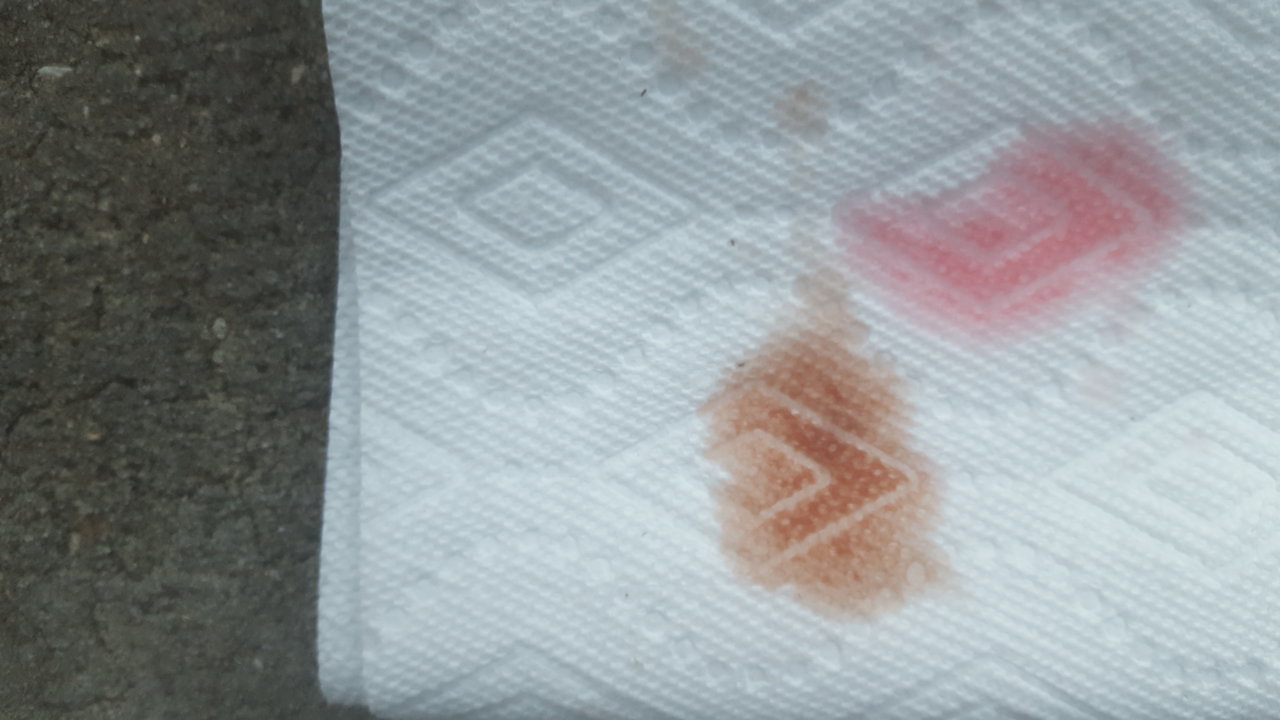

    I did a full flush at 138k, had done one drain and fill prior. Here is a pick of my used fluid vs new
    Kev2010Taco and JimboAnz[QUOTED] like this.
  18. Feb 5, 2018 at 4:44 AM
    #1018
    JimboAnz
    JimboAnz #OldNorm
    Feb 3, 2014
    #122157
    21,609
    Jimbo
    Charlotte (Cornelius) NC
    2020 Ford F'in Ranger
    wow, that fluid looks good. mine was black. I will drain refill again in a couple weeks
