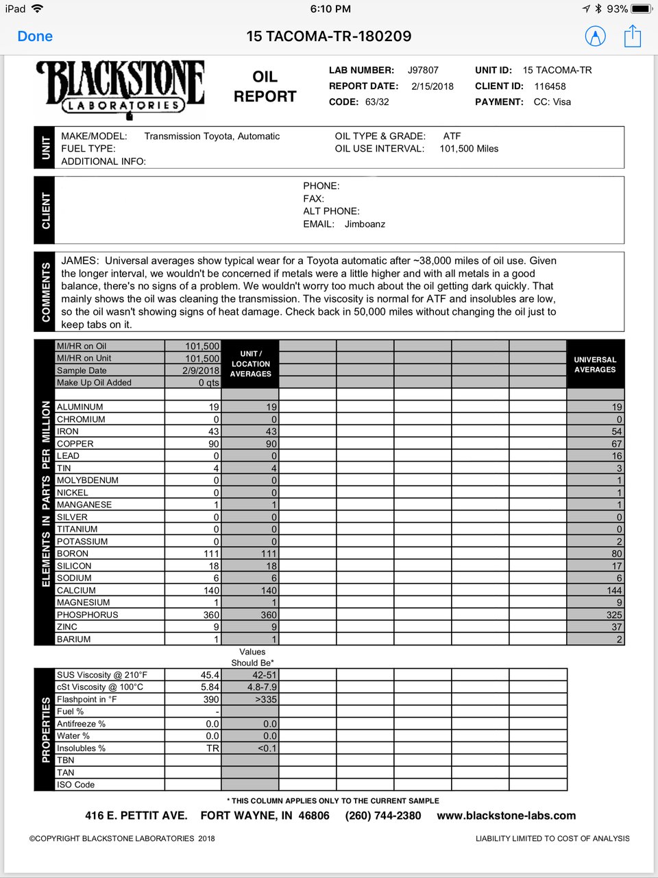

    Sent my tranny fluid in to blackstone. 101k on original fluid. Was dark when it came out and i determined i was 1/2 qt low. Good report.
    TacoJuan, BWilley and DVexile like this.
  2. Feb 15, 2018 at 3:44 PM
    #1022
    DrFunker
    DrFunker Well-Known Member
    Feb 3, 2014
    #122158
    42,921
    Damn, that is pretty good. How I read that is, your oil shows the wear of a truck with 38k on the odo. Nice! :thumbsup:

    right, I think so too. Ill take it, and swap some out every 50K. I would have swore I cooked it, helping @EddyRRT move his shop from chareston to laurens, hauling a heavy ass trailer, in hot ass weather, going 70-80 :anonymous:
