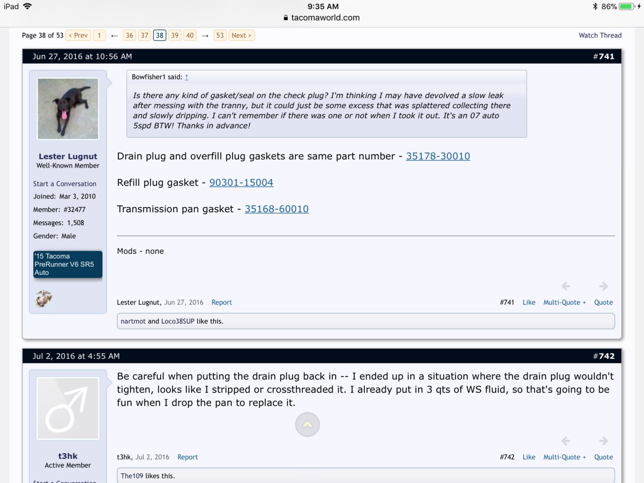

    This may have already been covered but, are there any gaskets that need to be replaced when draining and filling the trans like with the diffs?
  10. Apr 17, 2018 at 9:08 AM
    #1070
    spitdog
    spitdog Well-Known Member
    Sep 2, 2014
    #137440
    3,929
    2015 Access Cab V6 4x4 SR5 MGM
    Some people replace them and some people reuse them multiple times.
  11. Apr 17, 2018 at 9:16 AM
    #1071
    TacoJuan
    TacoJuan Well-Known Member
    Oct 21, 2015
    #167328
    573
    Hanover, PA
    2015 Black Tacoma TRD OR
    Is it just the copper ones? (Part 35178-30010)?
  12. Apr 17, 2018 at 9:32 AM
    #1072
    spitdog
    Sep 2, 2014
    #137440
    3,929
    Yes that’s the part # for the drain plug& the check plug but there is a different one for the refill.
    TacoJuan[QUOTED] likes this.
  13. Apr 17, 2018 at 9:35 AM
    #1073
    TacoJuan
    Oct 21, 2015
    #167328
    573
    Hanover, PA
    Awesome, thank you
    DoorDing and spitdog[QUOTED] like this.
