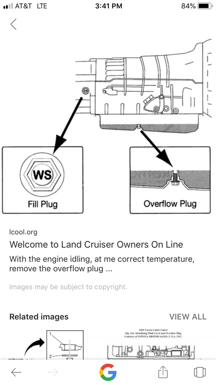

    ugh, 58 pages and counting on this subject!!!!! where is a diagram of fill plug for Automatic Transmission on a 4x4??????? (2015 4x4 Toyota Tacoma Pro)
    4x4 have a transfer case where they are showing on 4x2, and there are lots of bolts
  15. Jul 8, 2018 at 12:43 PM
    #1135
    07 sport 4x4
    07 sport 4x4 Well-Known Member
    Dec 24, 2010
    #48165
    1,453
    Blake
    Southeast
    2017 Duramax
    A750F
    DoorDing likes this.
