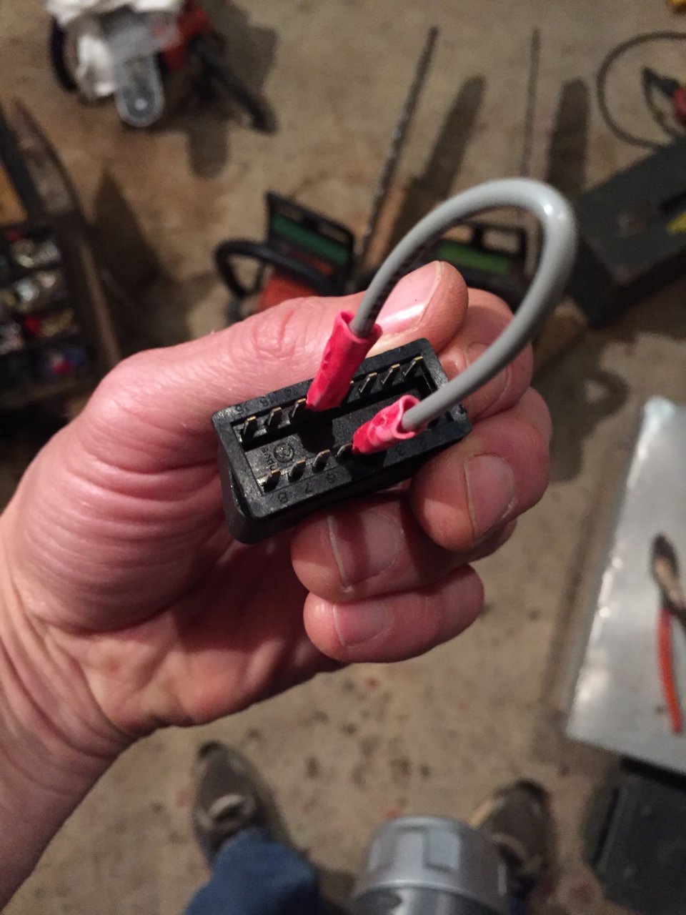

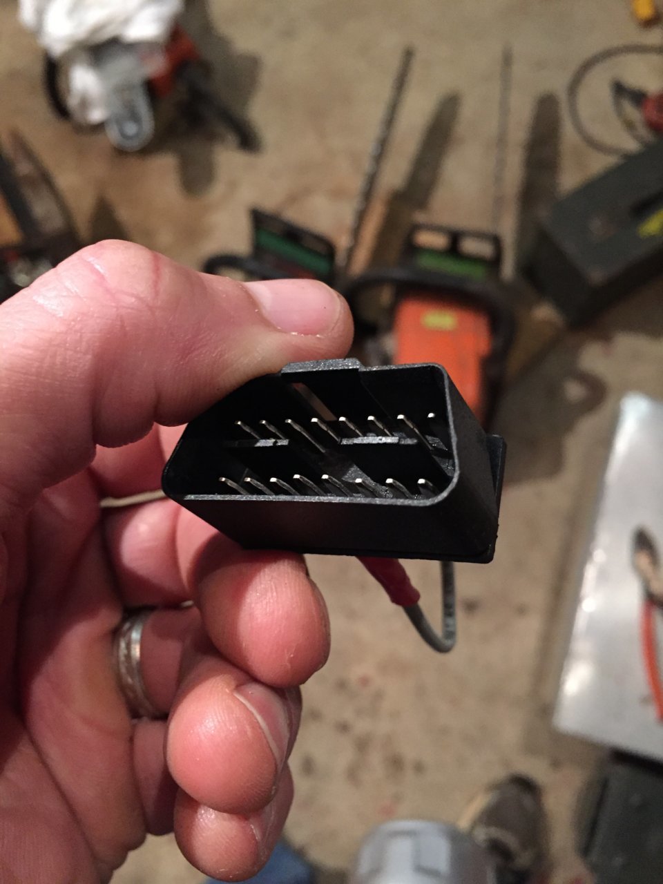

    Made myself an OBD2 plug with the wires already jumped out so I don’t have to jam a wire into my truck’s ODB2 port. One day I might solder the wires. I just need to learn to solder, lol

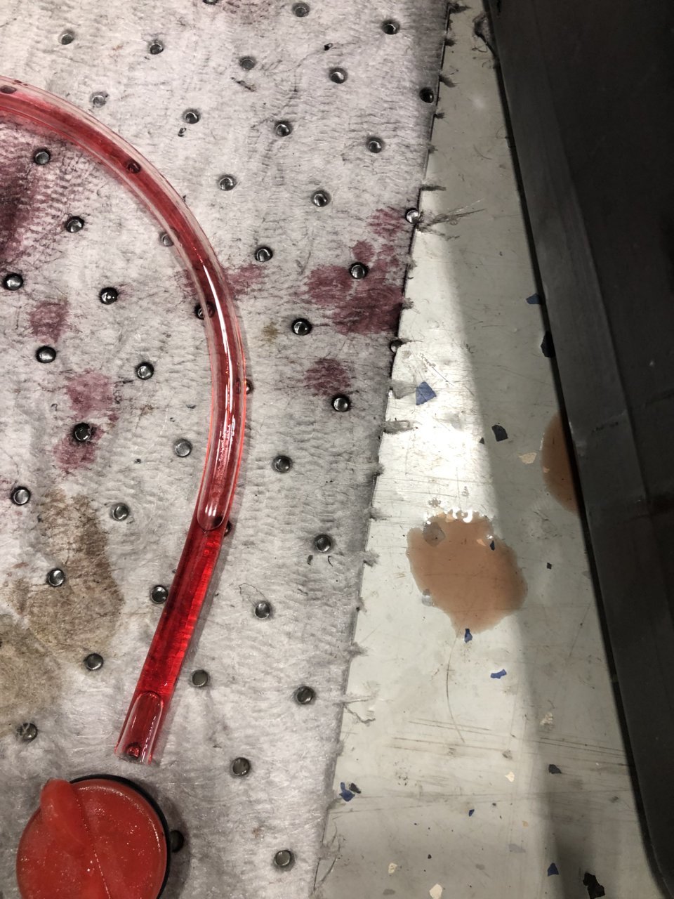

    After a couple months of back and forth I finally nutted up and did this. My truck has 155k miles and I got it at 138k with an unknown service history so I figured it was time.
    Followed this procedure exactly, minus the wire due to having the Torque app specifically for monitoring temps. I filled it with about 3 2/3 quarts just to be safe bc I am paranoid and got out probably somewhere between 1/2 and 2/3 when checking. Checked at 115 on the app/obd2 reader. The excess fluid came out so quickly I almost shoved the check plug back in, but then it tapered to a nice drizzle quickly.
    Here’s a comparison of the stuff I drained to new fluid. Mine was obviously due.
