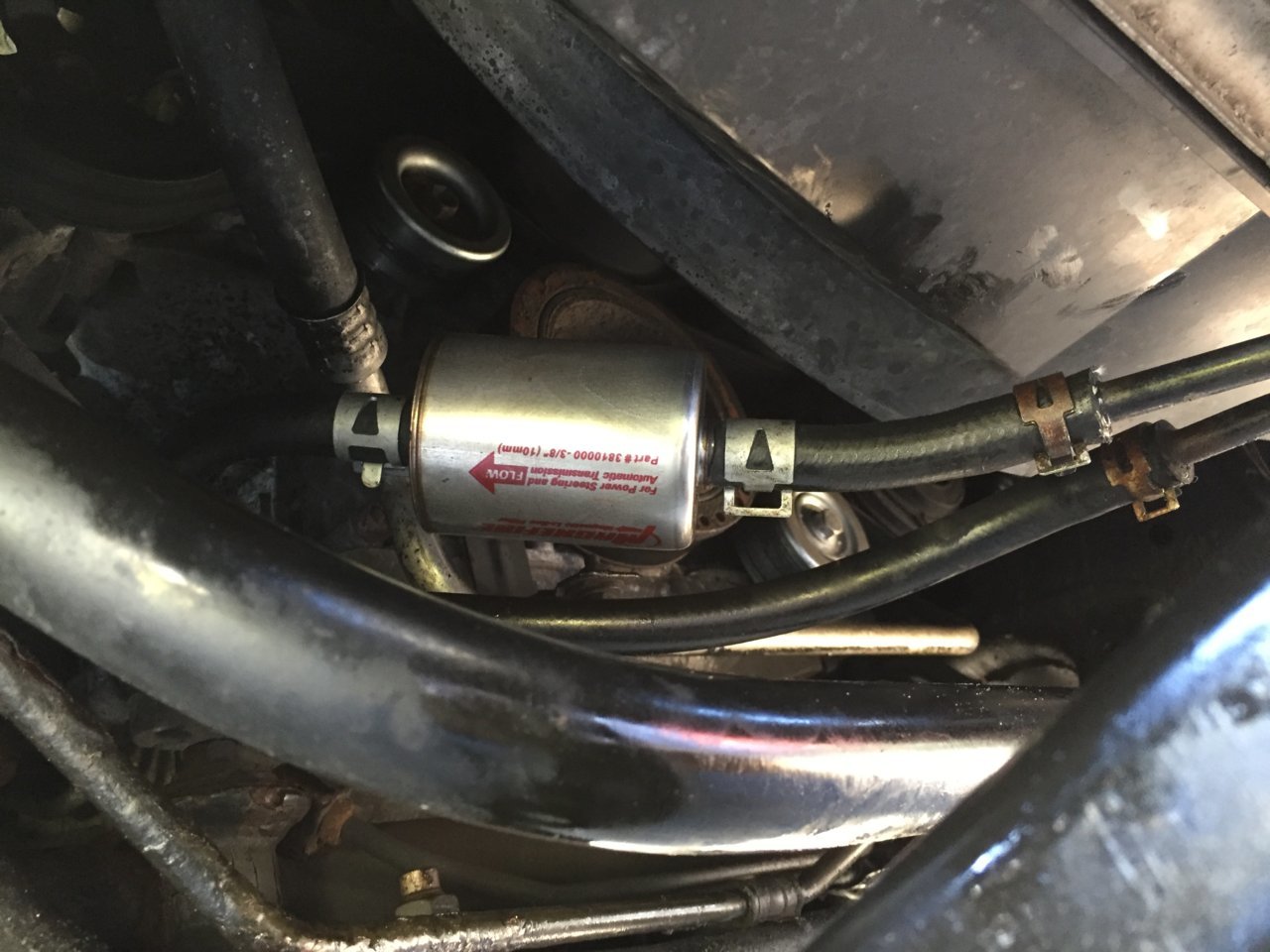

    Easy install.
    Stryker420, 270wsm and 07 sport 4x4 like this.

    Nice! Which line did you put it on...return?

    Ideally, you want the filter in the "hot" line. The hot fluid keeps contaminates in suspension.
    Of course, the fluid isn't cooling all that much - relatively - so either line will work.
