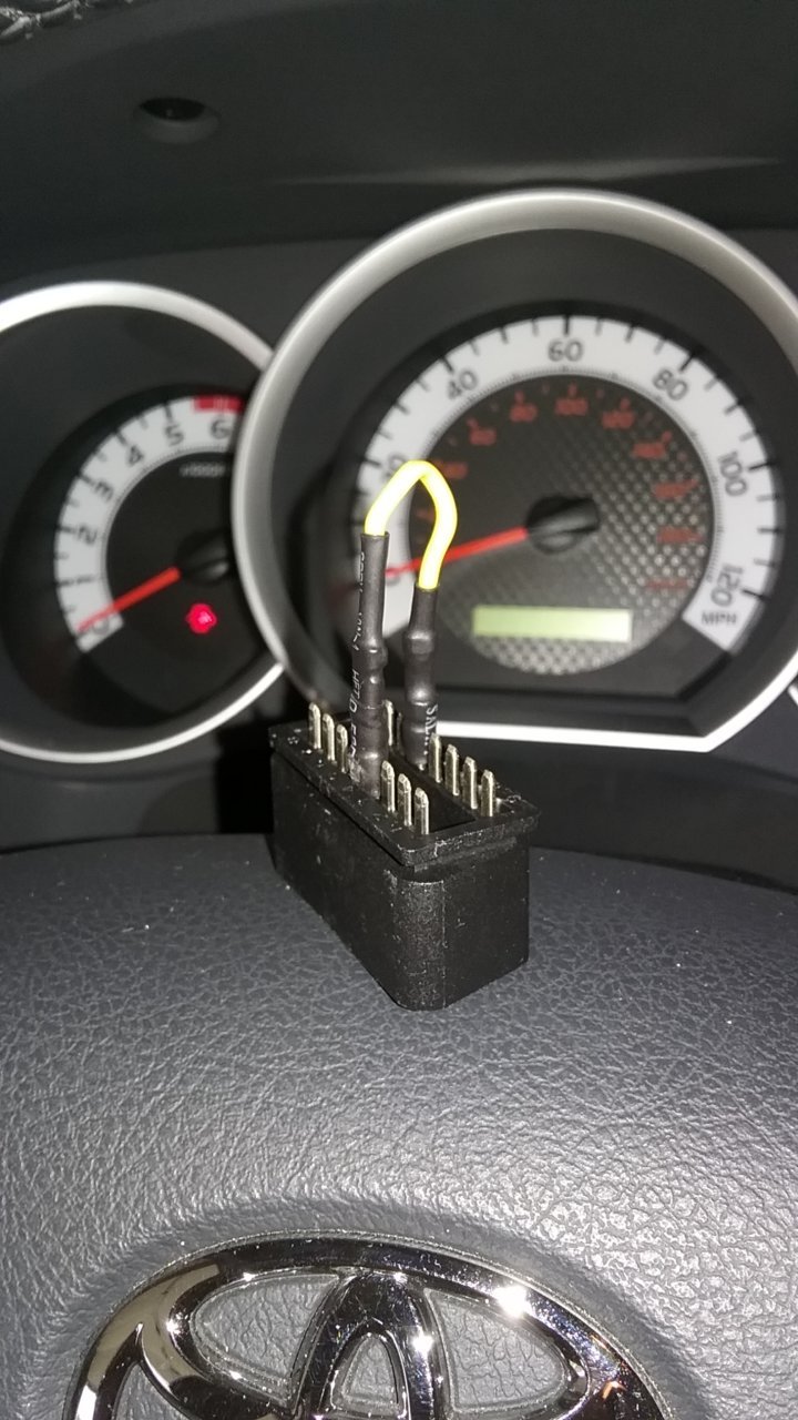

    Hey Joey! I received my glorified paper clip last week. It works like a champion!

    Clayton~
    As per Mountain Lion's and Fortech's excellent write ups and as per the OEM manual, the following applies:
    6. FLUID LEVEL CHECK NOTICE: The fluid temperature must be between 46°C (115°F) and 56°C (130°F) to accurately check the fluid level.
    Like you, I also did the drop pan (Fortech) and the full flush combo (Mountain Lion). Those two excellent write ups showed me how to change transmission fluid with out any problem. I used "Wit's End" OBD diagnostic port jumper wire to check temperature by default, because the BAFX Bluetooth scanner paired with the Pro Torque app would not give me transmission temperature reading. My truck is a 2012 Tacoma with the A750E transmission. After reading your post regarding temperature discrepancies, I'm glad I used the jumper method.
    On a related note, after I did the full transmission flush the infamous and mysterious driveline clunk/thunk coming from my driveshaft immediately went away. Has anyone heard of this and how the flush was a fix? I remember reading a post that another TW member had the same experience. Any feed back would be appreciated.
