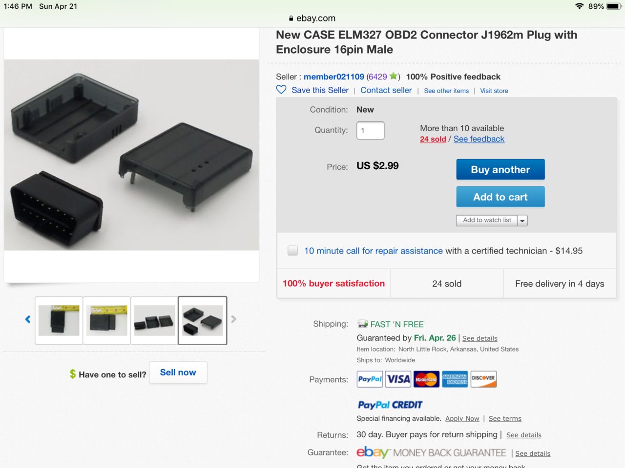

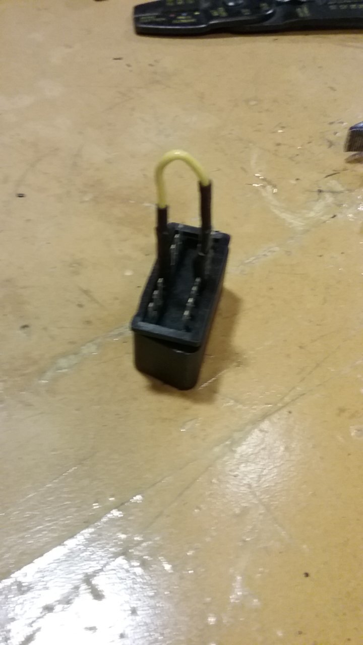

    I made one also. This came disassembled and you could solder the connections. Then the case just snapped together.
