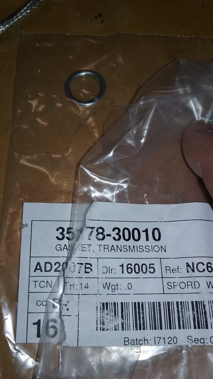

    Set up appt to get flush done at toyota. Tech says yes we do the flush and have the machine that works like a blood transfusion! Ok, I guess that is a fair way of explaining it. Get a phone call, would you like to have your rear brakes checked they are out of adjustment for 49.99, umm no thank you... would you like to have your air filter under dash replaced it is extremely dirty. Why are you in my glove box with out my permission???? And no! Just changed the fluid. Anyways, get the receipt for the fluid flush it is only 127.00 wow that’s cheap quote for 250ish... drive off look at receipt again and part number is for crush washer only on drain bolt and only 2 qt ws fluid...called tech he said they don’t do flushes??? Then what did you freaking say you did!!!!! Left one star review and GM calls we talk and I got 16 qt instead of him refunding me... smh what is wrong with these people these days? It’s like you have to be a moron to be a tech. FYI I own my truck, toyota does not get to tell me when I change my fluids... tech said well I don’t recommend it. Well when you buy one you do what you want too... nuts I tell you, just nuts!!!

    is this the only washer that needs replacing?
  5. Jul 2, 2019 at 2:05 PM
    #1325
    Plain Jane Taco
    Plain Jane Taco Well-Known Member
    Apr 19, 2009
    #16179
    40,279
    USA
    The drain and check plugs use the same part and should both ideally be replaced. However, I did a total of 4 DAFs over the course of a few days and only replaced them on the last one without issue.
