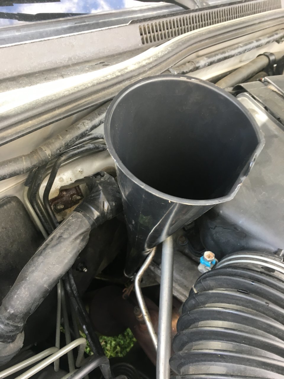

    Used the funnel method for my D&F, worked like a champ. 1/2” hose fits in the fill hole very securely.

  13. Dec 4, 2019 at 6:28 AM
    #1393
    bhanks55
    bhanks55 Member
    Dec 4, 2019
    #312443
    14
    Looks like you just run funnel with tubing attached down through an opening in the engine bay? Is that correct? My first rodeo with this truck.
  14. Dec 4, 2019 at 6:49 AM
    #1394
    seedy_tea
    seedy_tea Well-Known Member
    Dec 1, 2017
    #237398
    339
    chris
    Cape Cod
    2009 TRD-OR DC
    yes this is the easiest way to do it. some spillage removing the tube from the fill port is inevitable so be prepared for that.

    Lester Lugnut
    Lester Lugnut Well-Known Member
    Mar 3, 2010
    #32477
    2,822
    N of Mex-S of Canada-E of LA-W of NC
    '15 Tacoma PreRunner V6 SR5 Auto
    Yes + I first attach a clean sock around the end of the hose that I feed down into the transmission fill hole. Slide the hose into the sock. Wrap a rubber band around the sock. This keeps the sock attached to the hose and keeps unwanted dirt/etc from finding it's way into the end of the hose that you feed into the transmission fill hole. Once you get the hose down below and the fill plug is off(24mm socket) - you can pull off the sock and feed it into the transmission fill hole.

    bhanks55
    bhanks55 Member
    Dec 4, 2019
    #312443
    14
    Thanks. Did it last night. Worked like a champ. Only problem I had was somebody had over tightened the Allen bolt... almost didn’t get it out.
