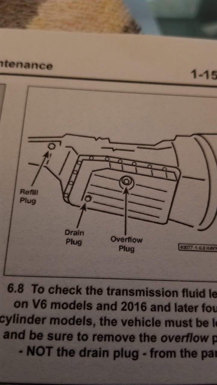

    Well i just boughy a hanes manual and it says nothing about jumping the obd2 connector. It just says run truck for 15 min and recheck......also can someone confirm for me how this over flow works? Is it a tube or something connected to the pan?20200127_145310.jpg
  19. Jan 27, 2020 at 12:58 PM
    #1439
    TacomaSport86
    TacomaSport86 2010 Tacoma/2016 4Runner Pro
    Dec 17, 2018
    #276093
    1,976
    Go to the first page of this thread and read, it gives you all of the information there
    Lester Lugnut likes this.
  20. Jan 27, 2020 at 1:16 PM
    #1440
    spitdog
    spitdog Well-Known Member
    Sep 2, 2014
    #137440
    3,927
    2015 Access Cab V6 4x4 SR5 MGM
    it’s a vertical tube inside the pan.
