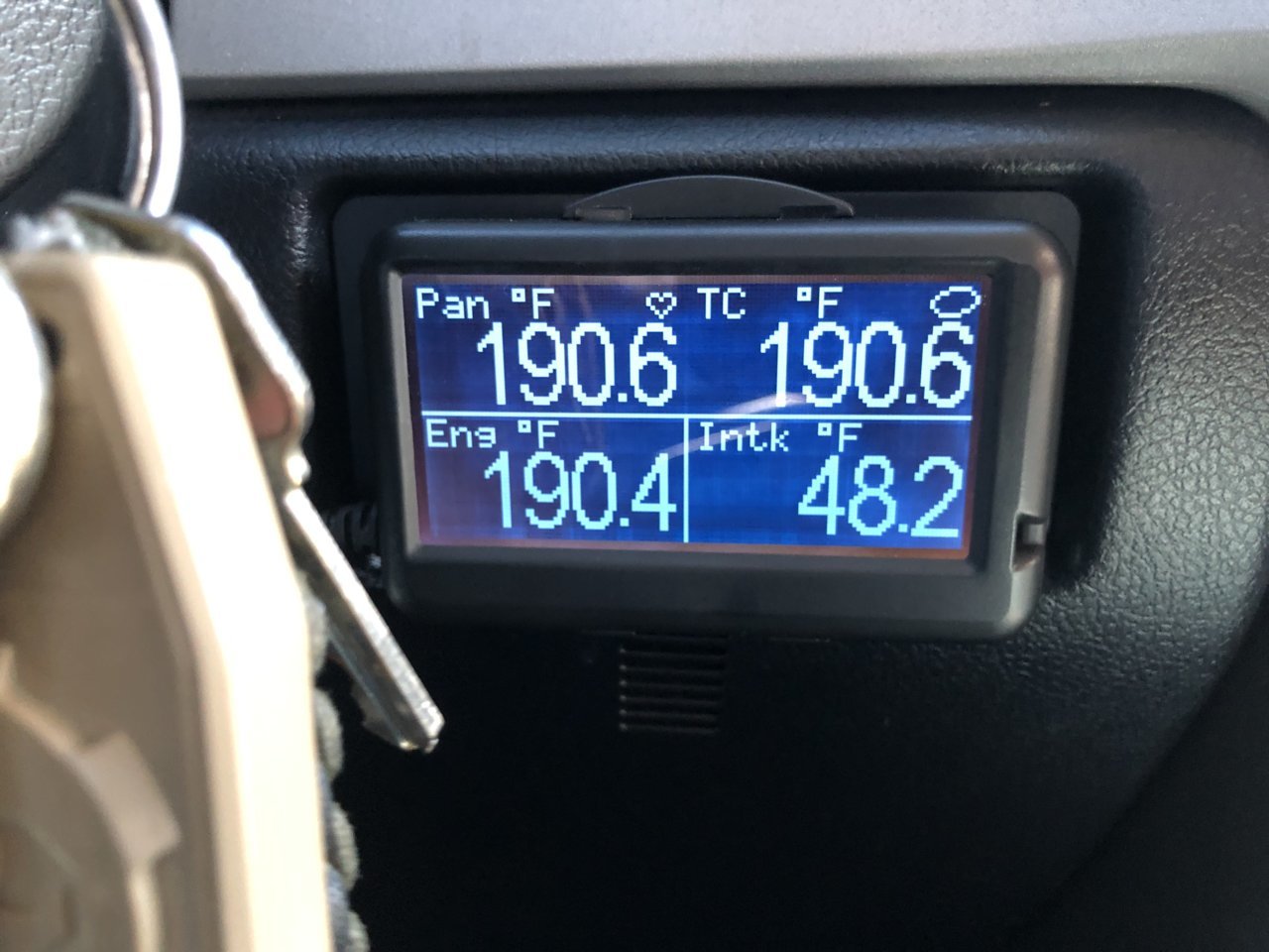

    Here is my temps on my tundra Going 60 mph with no load and 45 degree weather.056F8BC3-4247-4C18-B8C4-151774A88FC0.jpg

    Some people would say that's near the top of the "normal" range. Seems ok to me though. Some swear that Maxlife handles heat better than WS

    Yeah I pinned my thermostat the other day for the heck of it and it stayed around 120-130 all day. I live in southern Georgia so I don’t have any worries of being over cooled.
