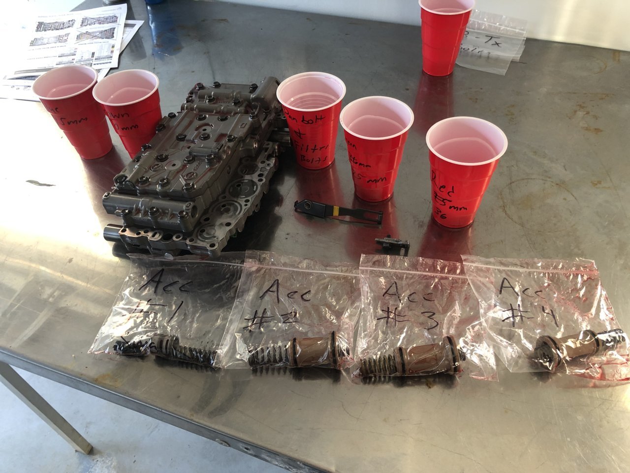

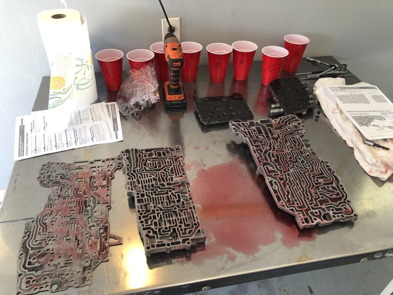

    It looks like me and my tundra’s AB60e are going to get very acquainted this weekend.551D2AF9-B7B1-480B-BC7B-49E2097B4B3D.jpg

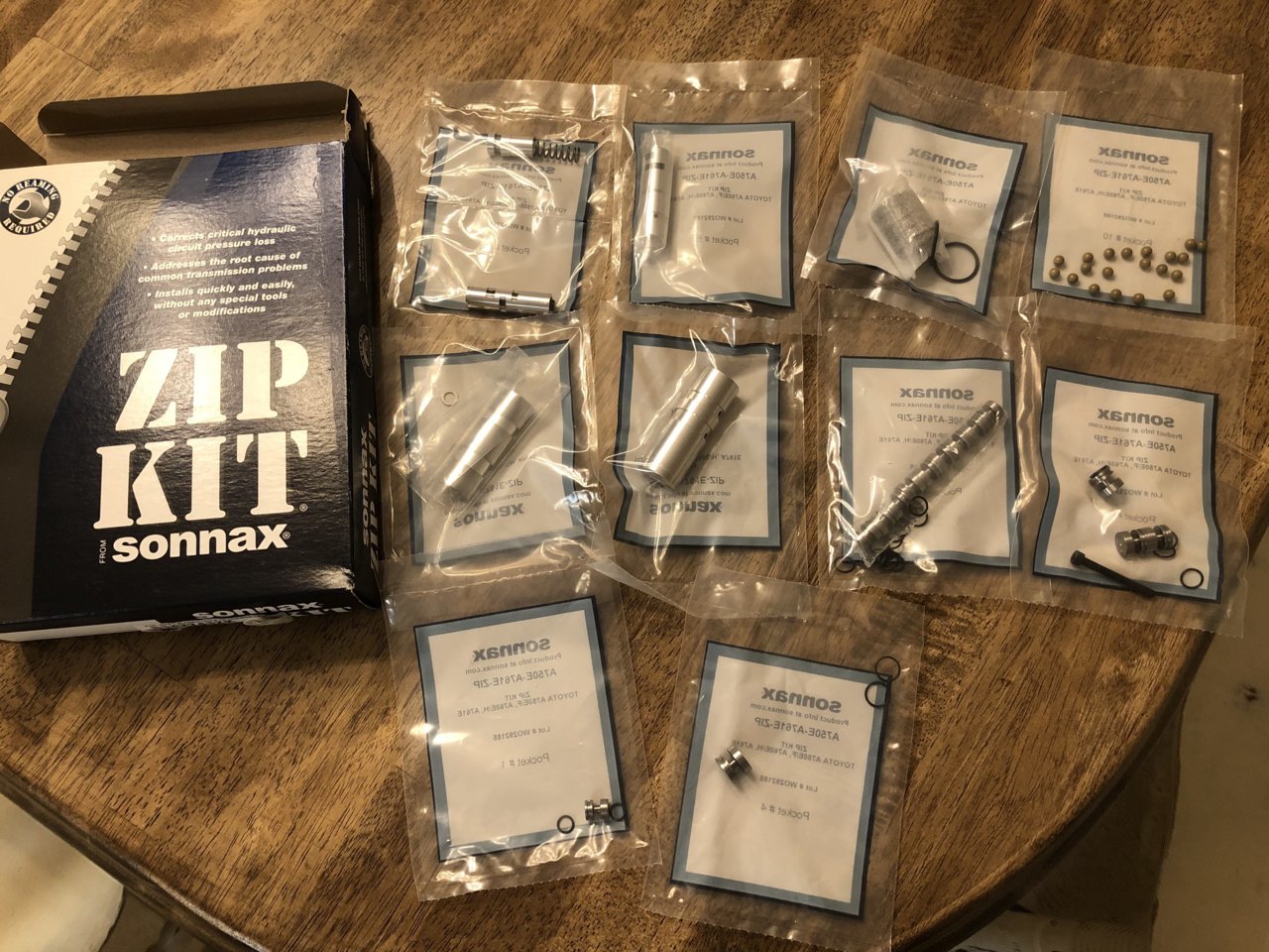

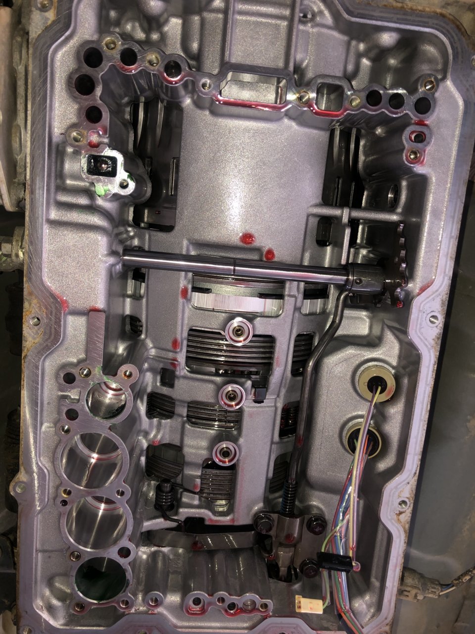

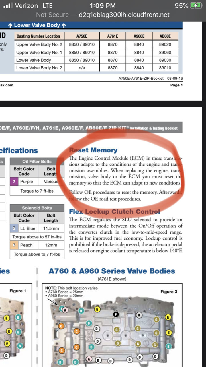

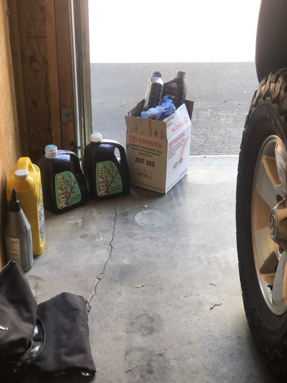

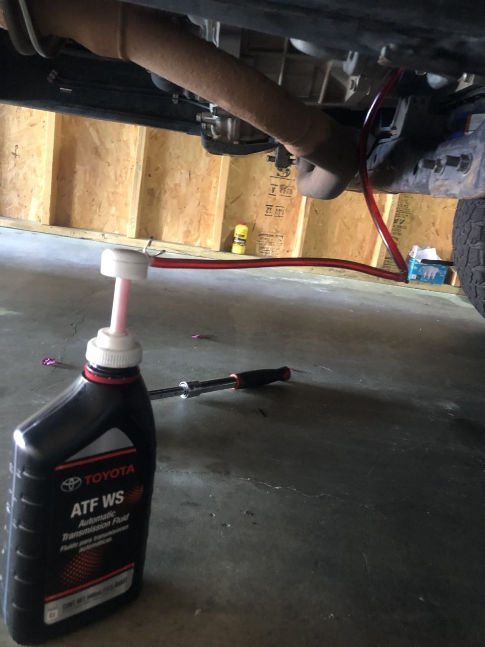

    A2CAB870-43B0-4AE9-9BF3-06390E4C9ABF.jpg I got around to putting my zip in. Not for the beginner but is doable with enough time and patience. I pulled every valve out and cleaned and reassembled. I didn’t find anything out of the normal and no valves appeared to be stuck. After reassembly I went for a test drive... no changes noted. But I still need to get my trans memory reset at the dealer.
    EDIT: dealer reset trans a week ago. No changes.
    E6A32E53-13D5-487F-BCE4-B2E54AEEEB71.jpg 66FC671B-AE97-4FA1-A77F-F98C1BE05D4C.jpg EF79D4A5-256A-43A1-BDFF-CAF6882E35BB.jpg
    Also filled with 8 quarts of this. Seems to work just fine.6B119DD0-4CFA-456E-B586-261A90F44F0B.jpg

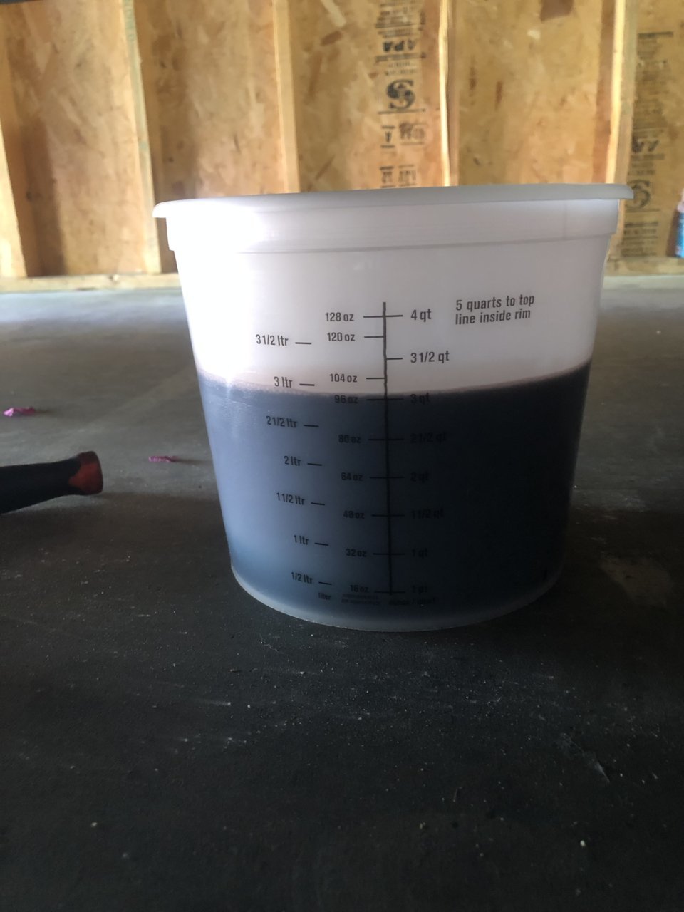

    It’s going down, bought 10 quarts to be able to drain and fill it 3 times since I’m at 110k miles and this will be my first time doing it
    Plain Jane Taco likes this.

    Done this many times. Take your time and make sure to put back a 1/2 a quart more to be sure. Then once you have it to the correct temp let the excess drain off

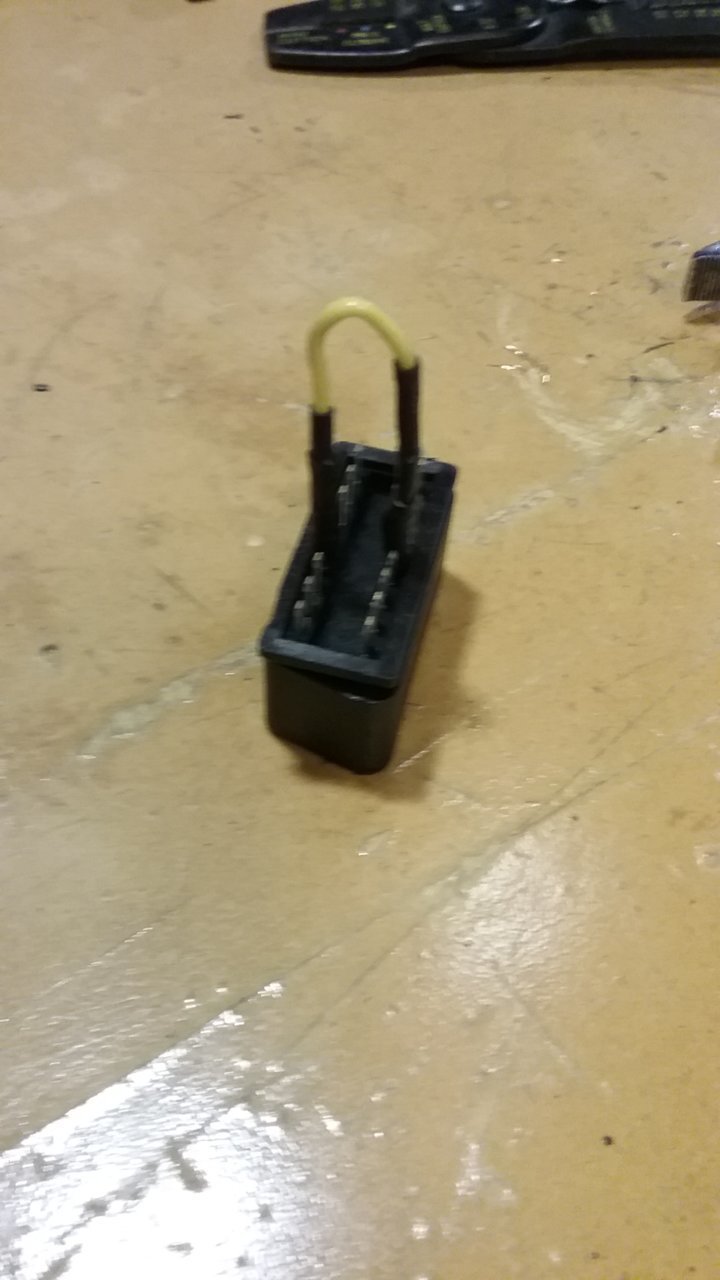

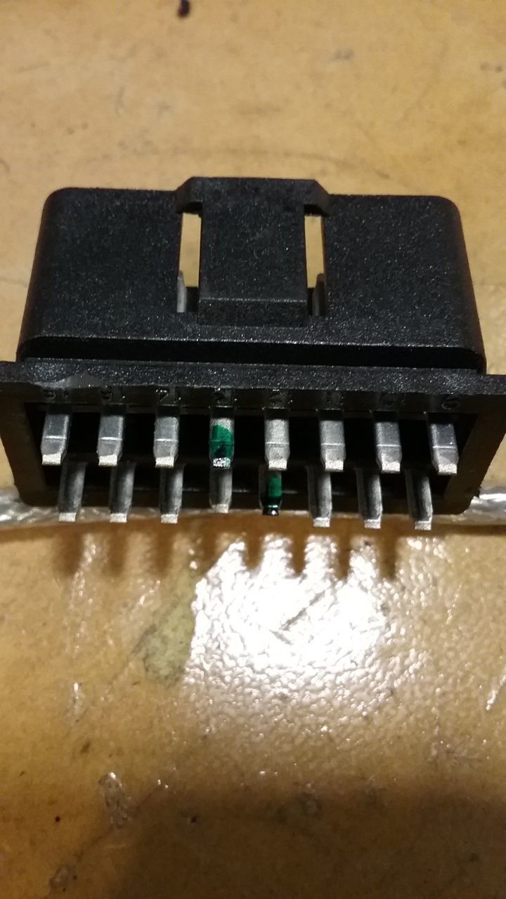

    Why not just use the check method? It's not difficult.
    Get a cheap OBDII connector from Amazon and permanently jump the pins. No wire jamming necessary.
