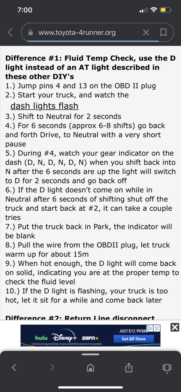

    I looked in the 4runner forum but couldn't find anything. Is the drain/fill and temp check process the same on a 2013 4runner?
  15. Jun 5, 2020 at 4:01 AM
    #1495
    07 sport 4x4
    07 sport 4x4 Well-Known Member
    Dec 24, 2010
    #48165
    1,453
    Blake
    Southeast
    2017 Duramax
    More or less, the temp check mode is a little different. The D will flash instead of having an at temp light.
