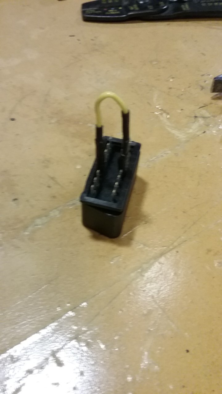

    Just did this on my 2015 SR5 and the A/T TEMP light flashed after the 4th shift but not after the 6th. After 5 minutes or so of idling it lit up and I finished the level check. Hardest part was getting the wires into the ODB connection - it helped to cut them at an angle and twist so they taper.

    Plain Jane Taco
    Plain Jane Taco Well-Known Member
    Apr 19, 2009
    #16179
    40,279
    USA
    spitdog and ResearchMonkee like this.

    I used wire pin connectors. (right side) But I like Plain Jane Taco's idea.

    Plain Jane Taco
    Apr 19, 2009
    #16179
    40,279
    USA
  16. Jun 24, 2020 at 6:47 AM
