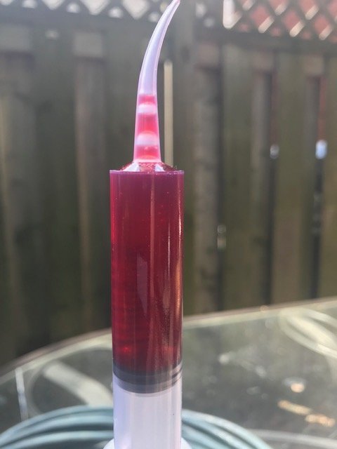

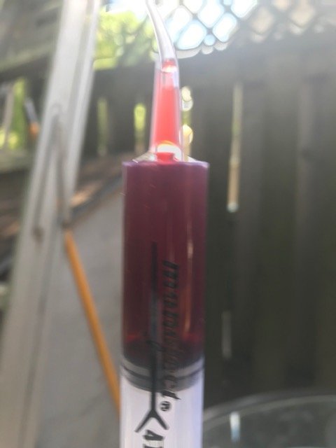

    Have 45,000 miles on my Tacoma. Did a proper drain and fill yesterday... I think the combination of an added cooler (with thermostat) and the magnefine filter are doing a great job...
    Compared to brand new fluid the original fluid was still in very good shape
    old on the left (top), new from the bottle on the right (bottom)
    I credit the magnefine for the lack of any visible debris in the fluid..

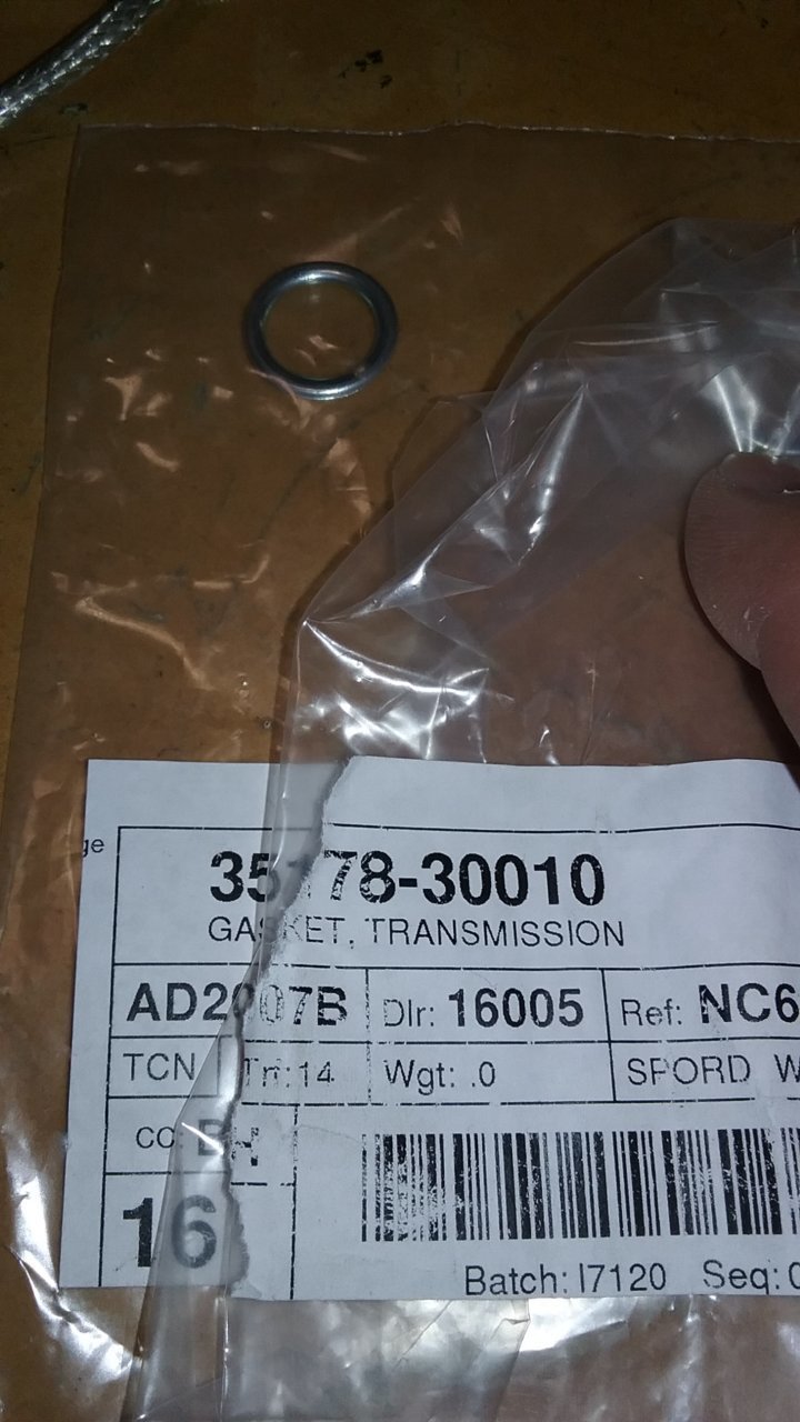

    About to do another myself. Also ordered that part off Amazon, but it won't arrive before I do this run. Bummer.
    I did it successfully last weekend, but my clunk started coming back so I checked under and noticed it was getting wet on the pan. I then realized I am missing something, a crush washer.. Also need to buy a torque wrench too.

    Definitely want the gaskets....whether you reuse the old or use new. Here is the number....the same for both the drain and overflow plugs. Think I paid $1 a peice

    Yeah, gonna pick up a set after work. I work across the street from a Toyota Dealership and my buddy works at Honda right next door to the Toyota. Reached out to our buddy at the parts desk to square me some when I get there.
    I don't remember one popping off when I drained, but now I know, it's definitely whats missing.
