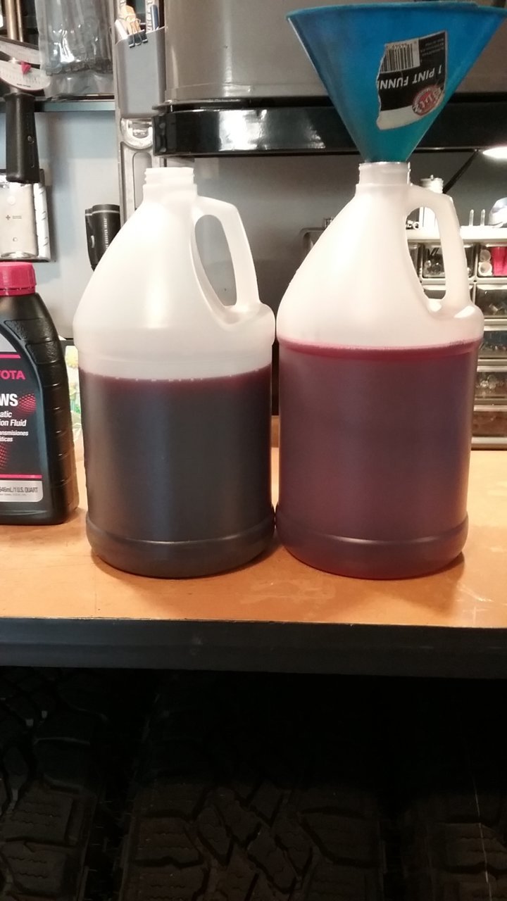

  9. Jul 30, 2020 at 5:03 PM
    #1569
    Plain Jane Taco
    Plain Jane Taco Take nothing worth having for granted
    Apr 19, 2009
    #16179
    36,847
    Bill
    USA
    2015 SW DCSB TRD Sport PR
    This is exactly my setup. I have 2 windshield solvent jugs....one marked "fresh" and one marked "old". Had them for a long time. They work great.
    I have a 5 quart clear plastic pan that I do the initial drain in. Then I transfer that into the "old" jug. Depending on which vehicle I'm servicing will determine how much goes in the "fresh". The Taco gets about a half a quart extra to bleed off during the temp check procedure. All the other Toyotas in the family get back the same amount I drained out.
    And I also have the same transfer pump.
    SR-71A likes this.
  10. Aug 1, 2020 at 11:04 AM
    #1570
    Plain Jane Taco
    Apr 19, 2009
    #16179
    36,847
    Bill
    USA
  11. Aug 3, 2020 at 12:24 PM
    #1571
    babylon5
    babylon5 Well-Known Member
    Aug 19, 2015
    #162175
    263
    David
    2015 Tacoma Double Cab TRD Sport
    Just don't mix these up with your next batch of homemade red wine :cheers:
    Plain Jane Taco likes this.
  12. Aug 3, 2020 at 5:53 PM
    #1572
    Plain Jane Taco
    Apr 19, 2009
    #16179
    36,847
    Bill
    USA
    :proposetoast:
    Wonder which one would taste better....WS or Maxlife? They've both been in there....depending on what vehicle I was wrenchin' on. :D
