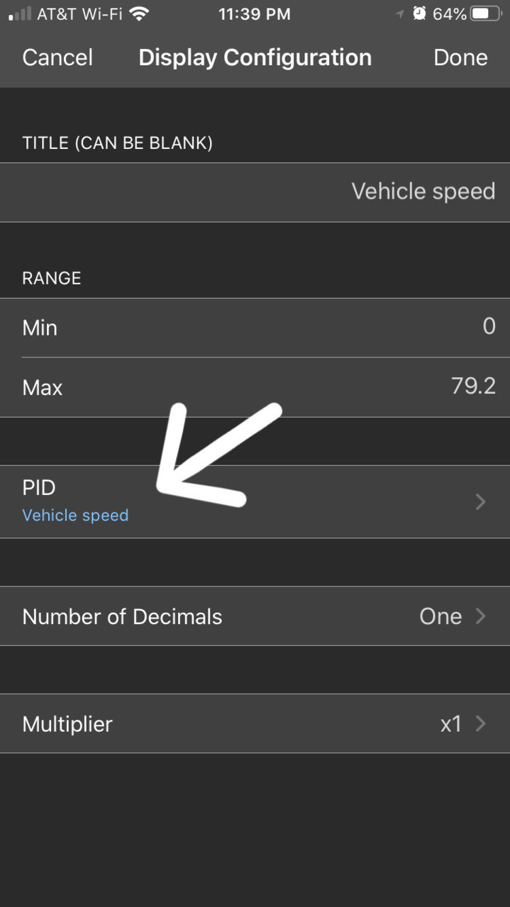

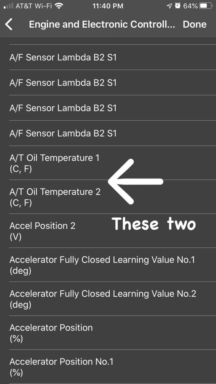

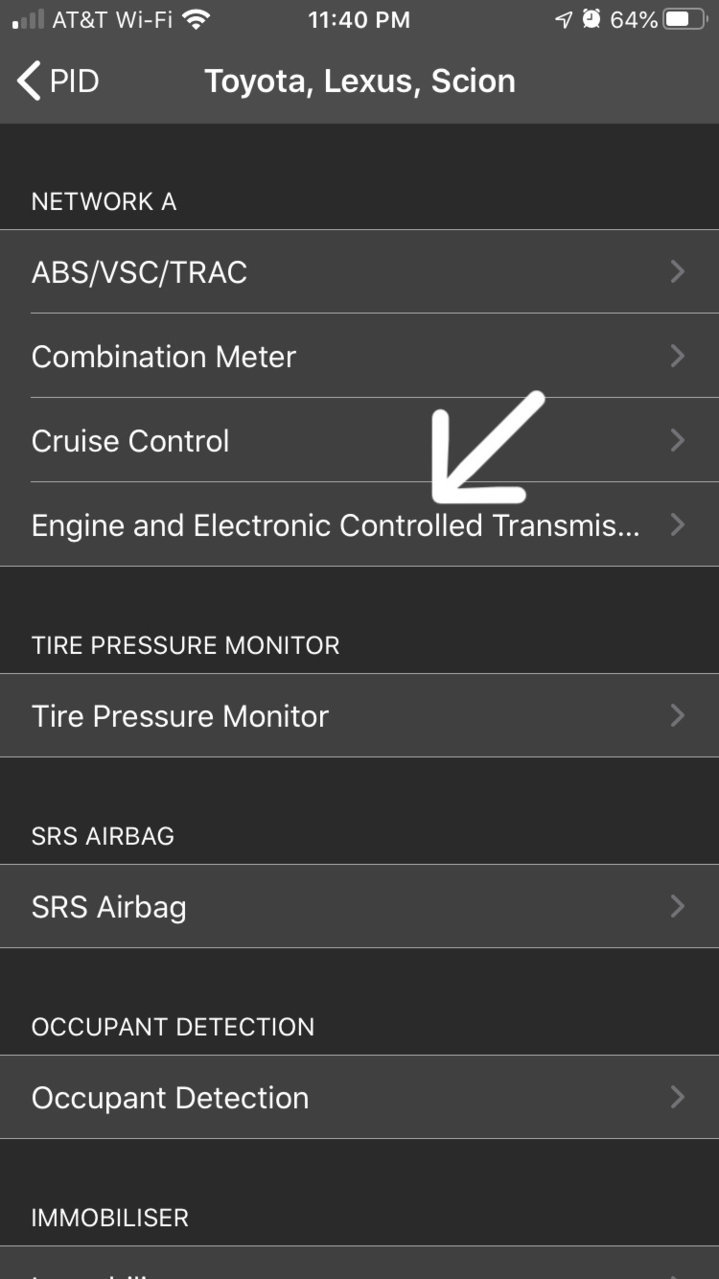

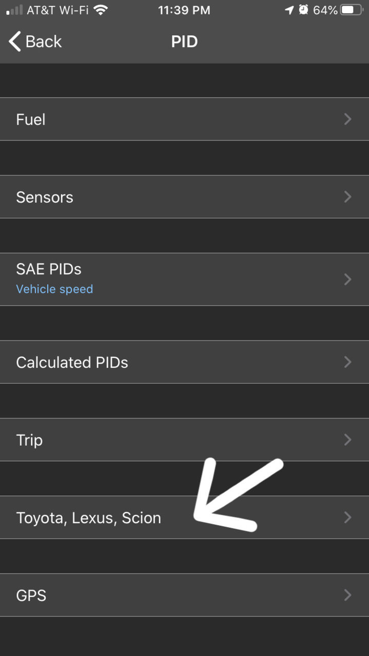

  11. Aug 18, 2020 at 12:00 AM
    #1591
    m00seNUckLEz
    m00seNUckLEz tAc0 aFiCi0nAd0
    Dec 20, 2015
    #172698
    858
    Fresno, CA
    Under Construction
    Add the A/T Temp display like this:

    My screen shots look nothing like this. I have an iPhone so starting to think that’s the problem.

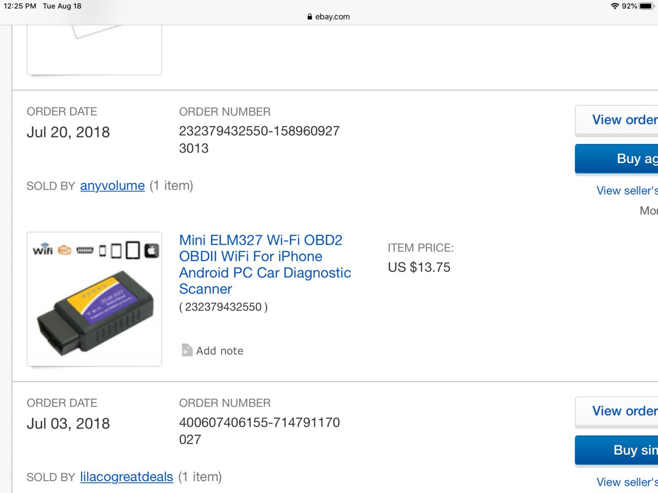

  15. Aug 18, 2020 at 8:55 AM
    #1595
    RCast436
    RCast436 Active Member
    May 22, 2007
    #1648
    25
    Rip
    SoCal
    06 Tacoma Access Cab 4WD TRD Offroad
    What OBD device are you using? Does Bluetooth or WiFi make a difference? I wonder if that’s the problem.
  16. Aug 18, 2020 at 9:26 AM
    #1596
    spitdog
    spitdog Well-Known Member
    Sep 2, 2014
    #137440
    4,019
    2015 Access Cab V6 4x4 SR5 MGM
  17. Aug 18, 2020 at 9:32 AM
    #1597
    spitdog
    Sep 2, 2014
    #137440
    4,019
    Open your app, go to settings and post a pic of that page.
