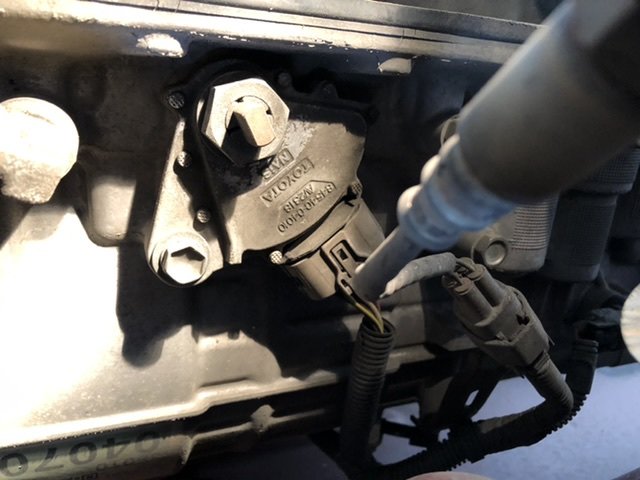

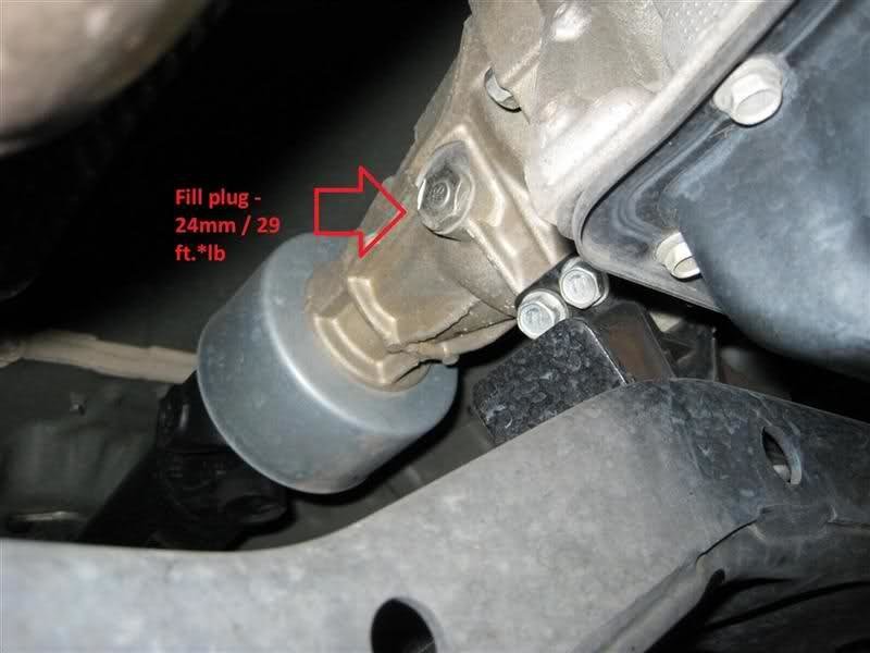

    Identifying the drain bolt(14mm)✅ and overflow bolt(5mm)✅.
    I think this pick shows the 24mm fill bolt.

    It sure doesn’t look like mine.

    Thanks for confirming that. You are correct.
    How about this?

  13. Sep 3, 2020 at 12:22 PM
    #1613
    spitdog
    spitdog Well-Known Member
    Sep 2, 2014
    #137440
    4,019
    2015 Access Cab V6 4x4 SR5 MGM
    There ya go. :thumbsup:
