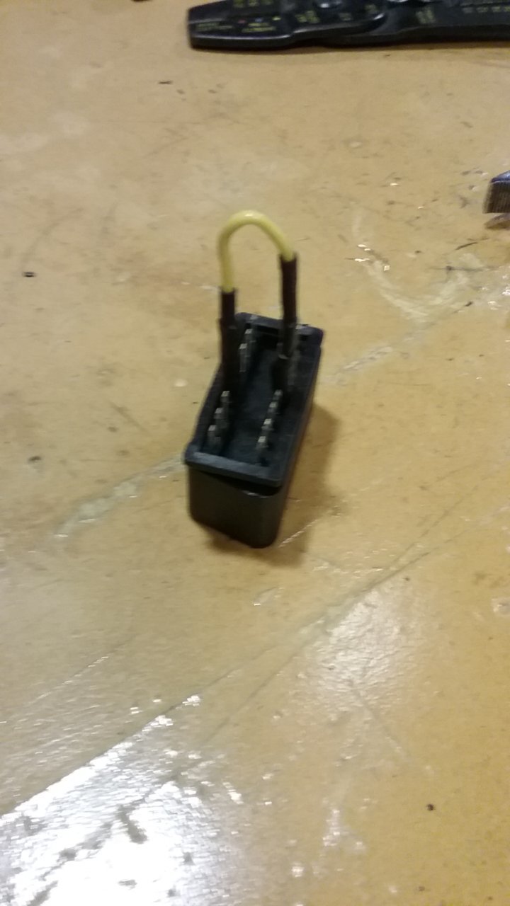

    Practice it a couple of times. I was able to get it on my 1st try and no problems any time after either. If the ambient air temp is cold it can take awhile.
    One thing that has made it easier for me was an OBDII connector. I permanently jumped 4 and 13. No wire jamming necessary.

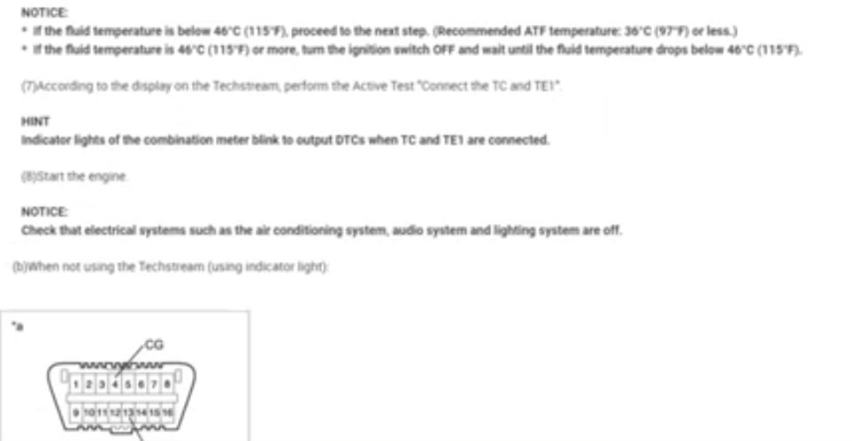

    1) The proper temperature range for my Vehicle (Gen 2, 2006 4L 4x4, 750F Transmission) is 97-115 Deg F. Not 115-130 Deg F. I confirmed this by reading other information, and ultimately by following the OBDII jumper wire procedure and measuring with a thermal gun. My truck got happy (ATF light went on) at 97deg F as measured by the thermal gun on the bottom of the pan. I have no doubt the original article is accurate for that truck. This is just a note to everyone that apparently the temp range differs for different vehicles so be careful.
    2) An easy wire for the OBDII jumper procedure is an old school paper clip. Typical car wire has strands of smaller wire that complicate getting the ends cleanly in the OBDII connector and there is risk of a small stray wire shorting to the wrong pin. Paper clip worked perfectly. The small kind not the heavy duty kind and make sure there is no plastic coating or anything. Old school, regular paper clip.
    3) Next time, I may choose to skip the OBDII hotwire and just use the thermal gun. These are cheap and widely available now because of Covid. I bought mine on Amazon for $20. Going back to point #1 if you are not 200% sure what the right ATF temperature is just use the OBDII method because it is fool proof.

    I've said this before....the temperature is not important if you use the OBDII to get it in check mode. Zero guess involved.
    As often as this needs to be done....it's no inconvenience to do it the right way.
    You can make it even easier by purchasing an OBDII plug and permanently jumping the wires. It's plug and play.

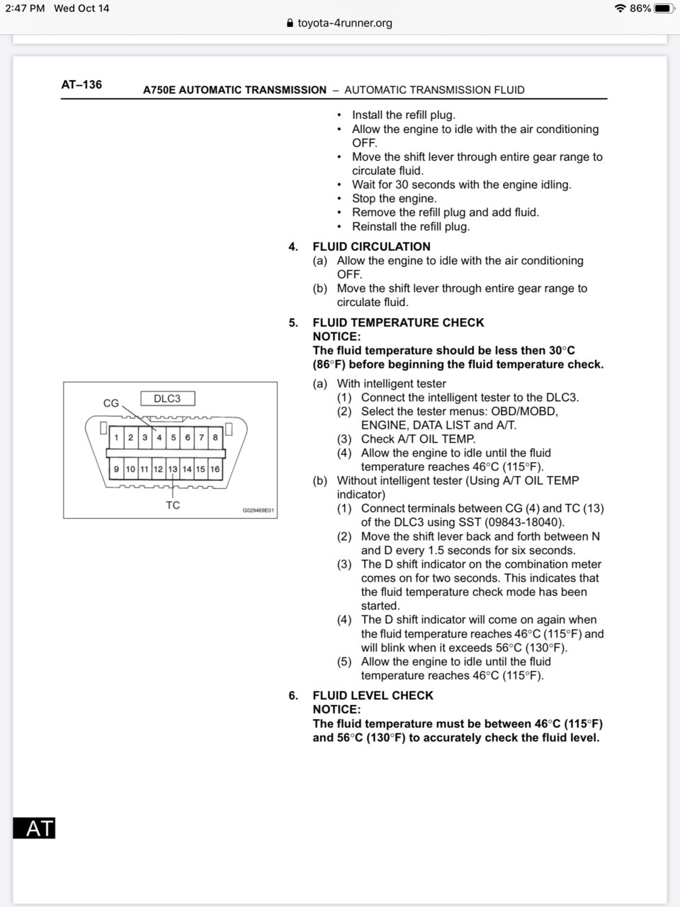

    What about these instructions and the temp check.
    These are for the Toyota Auto tranny 2005 - 2015 A750E
    750E = 2x2. 750F= 4x4
    I agree with @Plain Jane Taco you need to jump the pins.
    Even some tech at Toyota can verify with the wrong info. there’s multiple choices when it come to the correct temp. What that guy in the video posted for a 2015 and the below info from the FSM do not match for some reason. Thus the importance of just jumping the pins.

    Let's agree to agree. The transmission fluid temp specs are different on different vehicles. I added that comment because the original article mentioned the temperatures and I thought it would be helpful to outline they can be different. The OBDII approach is fool proof.
