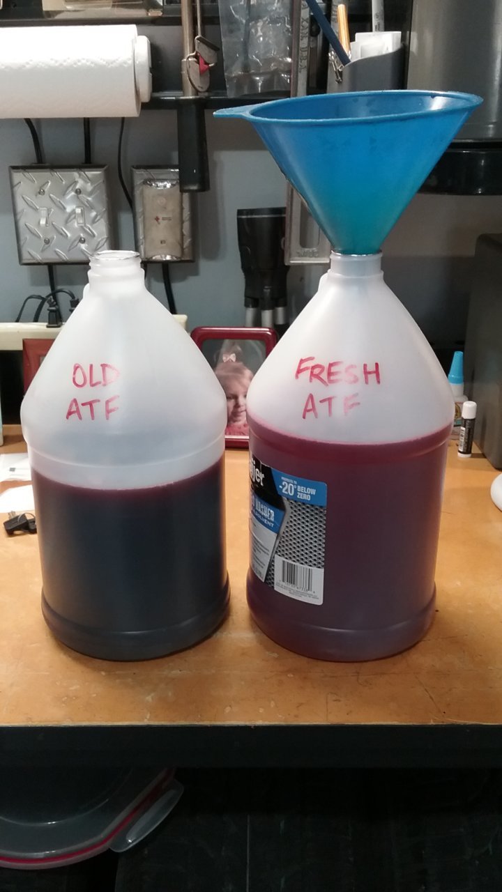

    I did a DAF today. No issues....just like the other times. However, I decided to pull my jumper adapter as soon as it went into check mode. Previously I had just left it in the whole time. The dash stops flashing but it's still in check mode.
    Old fluid looked great, BTW.
