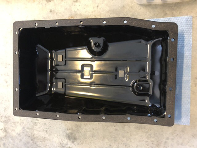

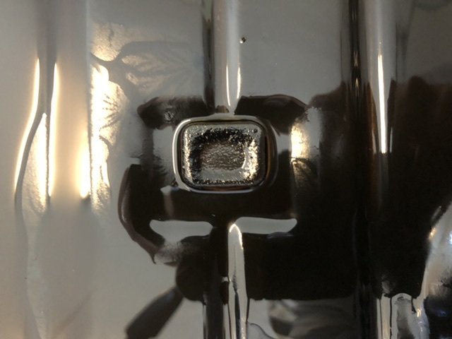

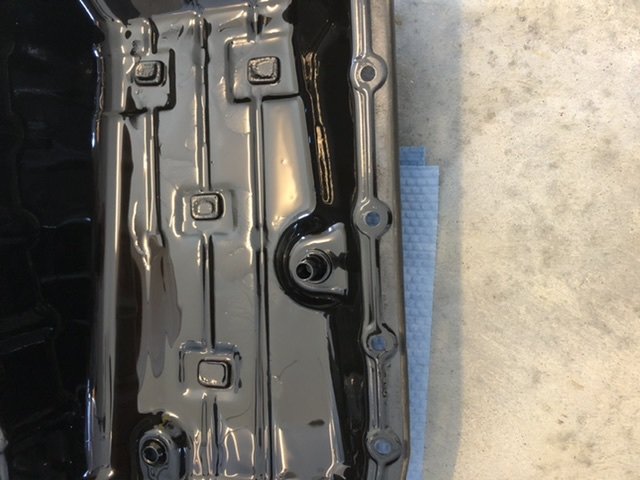

    Did you take any photos of the pan once you dropped it.....would be interesting how much crud is found at the bottom and the condition of the magnets

    I did actually, I’ll put together a write up this weekend and link to it from here.
    Here’s the pan and magnets, before and after:
    BB48AEE6-6B9A-4C97-B075-932A2AE6FAB7.jpg 5CAE11D4-6C30-4621-A3D4-BC2497E8D388.jpg 7443FD8C-428F-4C93-9A36-8FE18682988E.jpg
