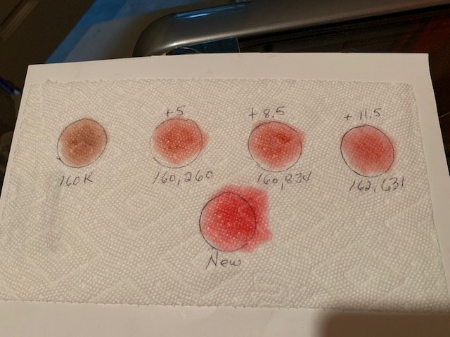

    Did the drop/strainer at 160K (first touch since new) and just did the 3rd drain/fill this morning!

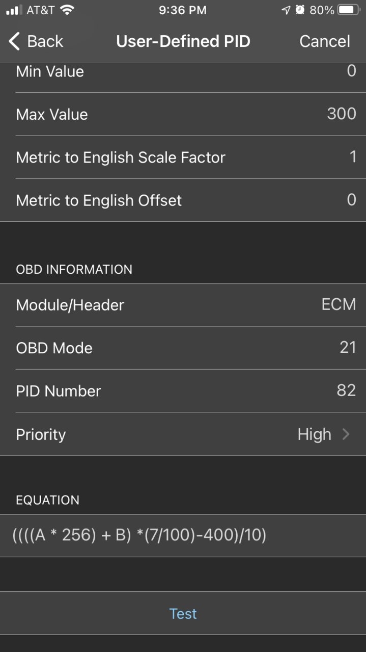

    Here’s the custom PiD for the Trans temp for ODB Fusion

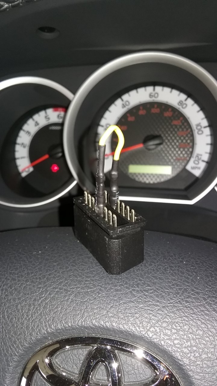

    I just use a simple paper clip to jump the pins....... pretty easy.
  18. Nov 21, 2021 at 7:55 AM
    #1878
    Plain Jane Taco
    Plain Jane Taco Well-Known Member
    Apr 19, 2009
    #16179
    40,279
    USA
    A small paper clip is much better than trying to jamb a wire in there.
    I just happened to see an OBDII adapter on Amazon for $6 three years ago. I permanently jumped the pins. Now I just plug it in when I need it.
