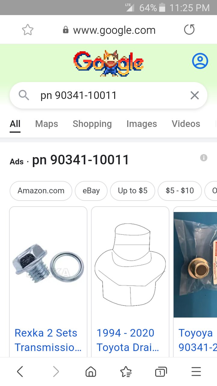

    The 5mn hex does say "check" on it. But as long as it's my rig I certainly know the difference. I still have the hex if needed in the future
