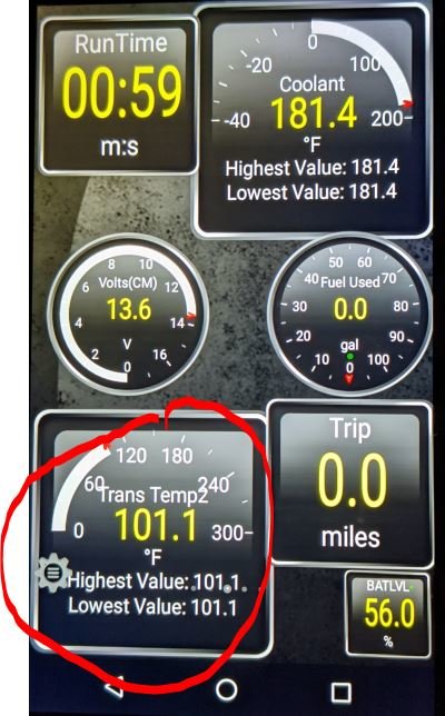

    Since nobody really has any definite proof or done any testing of what temp the A/T light actually comes on and when it actually starts blinking, I did a little experiment. I tried this on the 2.5 gens (2012-2015) over several months. This is based off the Torque Pro app, which I find to be very accurate if you set it up correctly using the correct PIDs and a good Bluetooth dongle.
    The A/T light comes on around 97 degrees and starts blinking around 115 degrees (give or take a couple degrees). Below is a screenshot of the Torque Pro app as I finished checking my 2012 with the A/T light still solidly lit. It'll start flashing right as it goes over 115*. Hope this helps someone out there who drives a 2.5 gen that uses Torque pro. Saves so much time and you don't have to mess with jumping the OBD and doing the shifter dance. Best part is I don't have to sit in my truck and watch a little light on my dash. I can take my phone with me and set it nearby as I work on something else. When the fluid gets up to temp I go and check the fluid. Cheers!

    Was that just the standard transmission temperature gauge on the app? That doesn't, it at least never used to, work on 4runners or Gx470s. Wonder if they updated their formula or if the Tacoma ecu is that different.
    I also confirmed temperatures with torque pro on my last flush many years ago but had to enter a custom formula. Someone else figured it out and posted it elsewhere, I just copied and pasted

    No it's not the standard reading. There's 2 temp readings for transmission, I believe mine is the 2nd reading, I can't remember off the top of my head, but it took me many tries to get it dialed in and get it reading correctly, there's lots of misinformation on how to set it up and what formulas to use on TW, so it was frustrating finding the right formula. Luckily, I have a buddy who figured it out and so I stole the formula off him lol.
