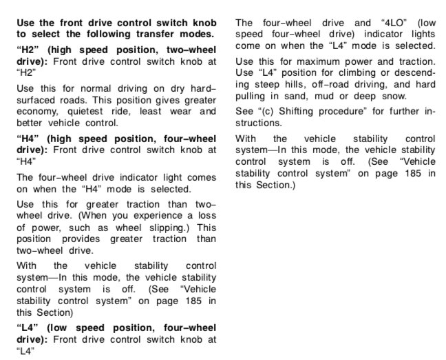

    I engage my 4WD on a rainy road sometimes, on snow in the winter or better yet, get your truck on a dirt road every month. It's good for the 4WD, it's good for our soul.
    Toyota doesn't know if you're traveling on snow or dry roads, which is why they left it up to you and warned you in the owner's manual to engage 4WD on surfaces that have wheel slip. On the 4Runner they do provide a way for the truck to deal with hard surfaces in 4WD with a transfer case that has a differential built-in to let front and rear turn at different speeds. In their owner manuals it says 4WD Auto is acceptable for dry hard-surfaced roads.

    If you're talking about the h2 section there, that's 2wd not 4.
    And trucks don't care how fast you go in 4wd. You slow down under 60 to engage, after that floor it.

    There always seems to be confusion about this topic. The manual only specifically says not to ENGAGE 4wd over 60mph, more plainly, "don't mash the gears together at high speed". You are perfectly safe going fast in 4wd. The question remains, if you need 4wd why are you going 60? Might want to slow down so you don't want to slide off the road. But the truck can handle it for certain.
