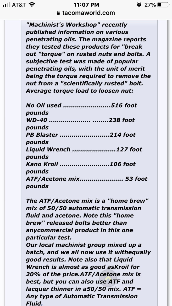

    Just gonna leave this little nugget here
    wilcam47 and Issataco[OP] like this.

    Shhhhh don’t tell anyone. Although sadly I didn’t use it for crack as the stereotypical engineering student at my college would have.

    damn that explains a lot about why lifting my truck was so annoying. All the bolts were rusted from the beach and mudding. Kinda want to get kroil but if acetone and Transmission fluid work better what’s the point lol
    wilcam47 likes this.
