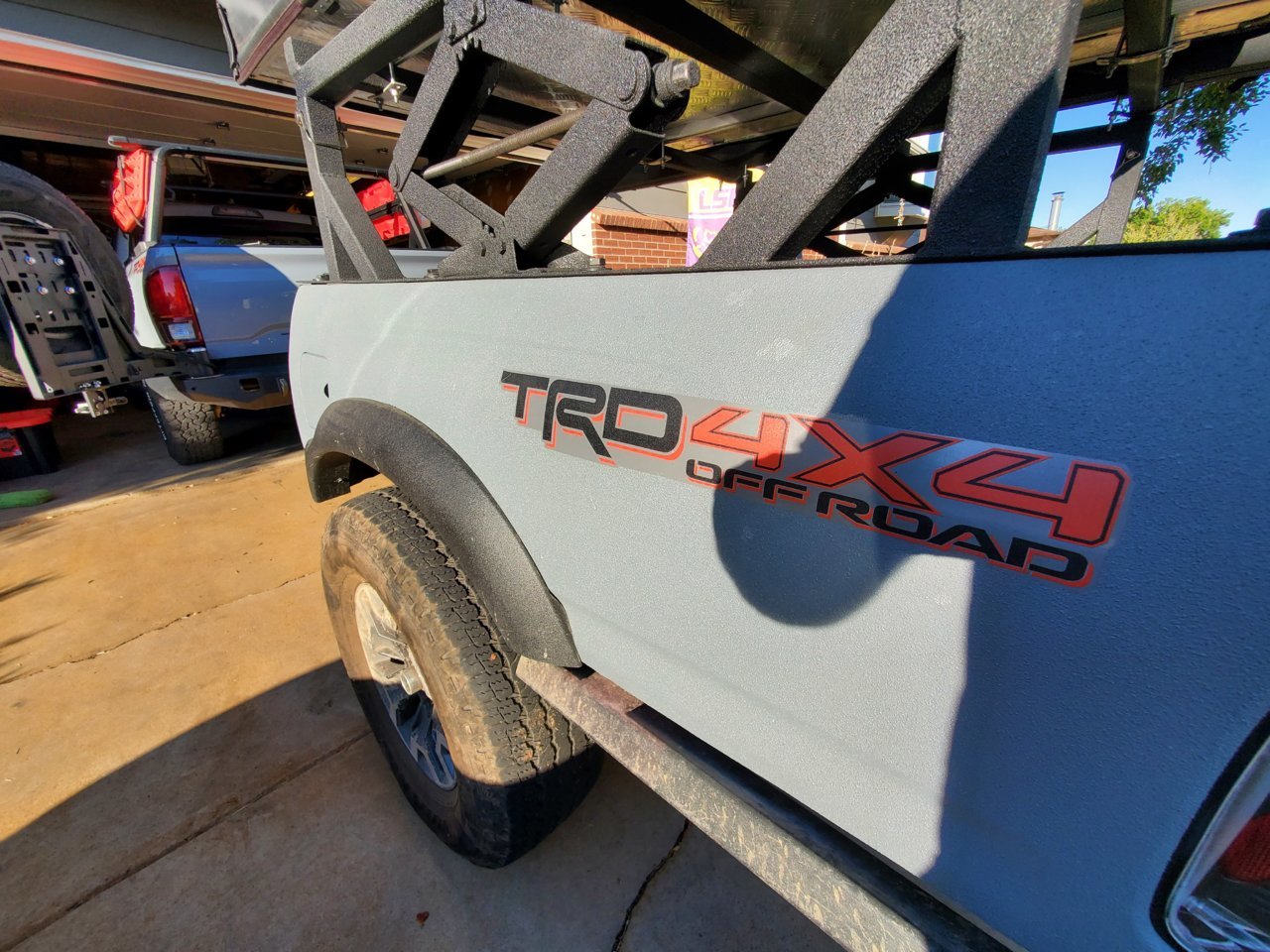

    I couldn't find a 3rd gen, but plenty of 1st gen's. Made a custom frame, bed cover, bed drawers and bed rack

    I spent around 4500 on material. That included the steel for the frame, lock n roll hitch, trailer axle with brakes, truck bed and wood for the bed drawers. If you find a bed, try to find one not damaged as the skins are quite expensive. It works great and goes wherever I need it to go. PM me if you want any info. Figuring everything out was the hardest part
