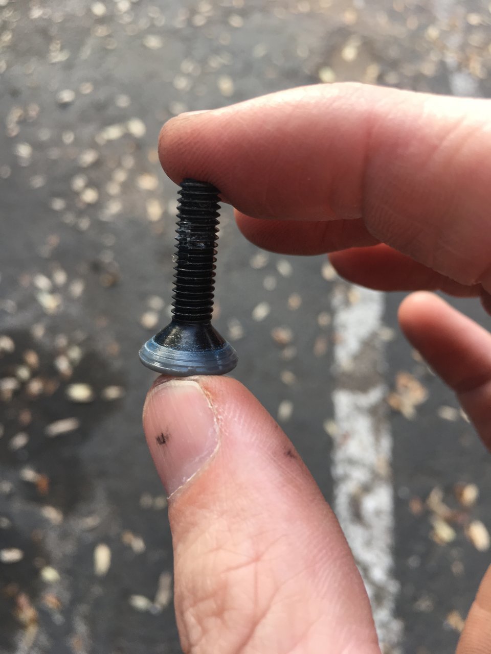

    I get the feeling there's a really obvious, simple answer to this, but....
    The 3 T-27 torx bolts that hold my access cab rear door latch mechanism in place (underside of the door) have fallen out.
    How do I figure out what replacement bolts to order online, to make sure they fit exactly?

    Looks like an M6 1.0, maybe 25mm long.

    You dont have to replace it with a torx head, whatever you find with a cone head and same size and pitch will work. If you dont find a black one, paint it.

    He first needs the right size pitch and bolt size before he orders online. If I were home I’d measure it for him. I’m on holiday and return tomorrow night.
    @Japhy yes, you can order online - if you have the right part #. Many dealers and vendors have schematics to look up the part #, but they are not all inclusive. It would be quicker to take one of the bolts to a hardware store or dealer.
