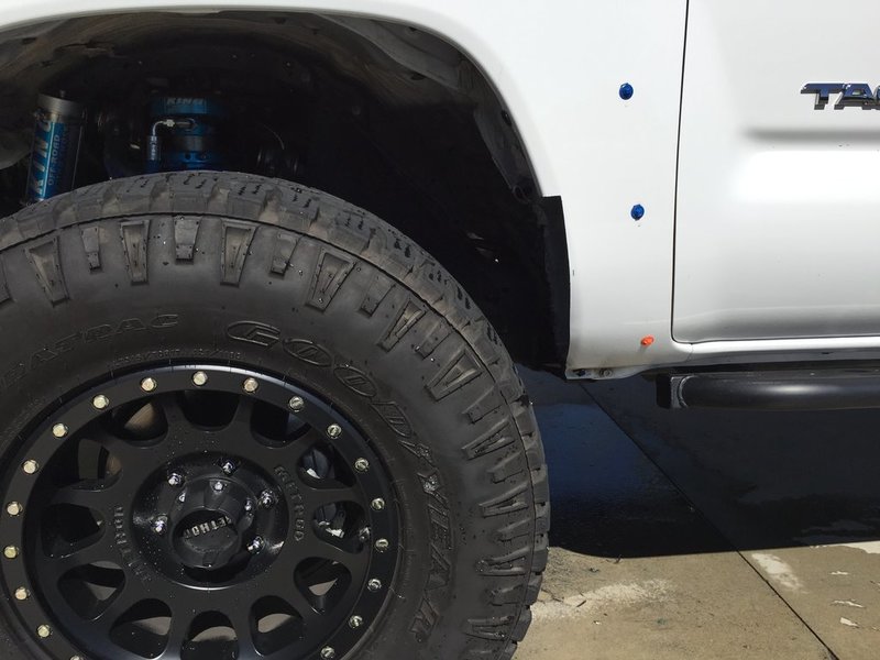

    Trimming for 35's hope it's enough... Let me know haven't tested yet. Before the trim ripped my fender off.

    Yes sir
    5" lift? Pretty sure you can fit them with a 3" lift and trimmed fenders along with obviously cab mount chop and no mud flaps no?

    Yes 3" works that's what I'm running
