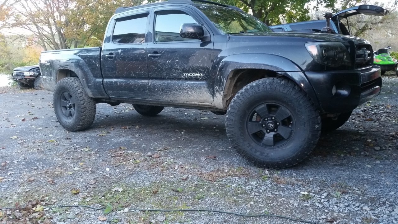

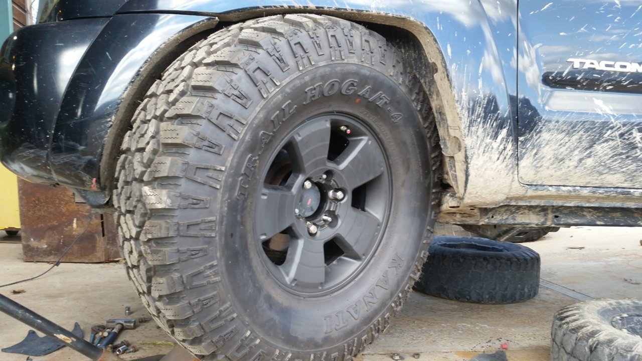

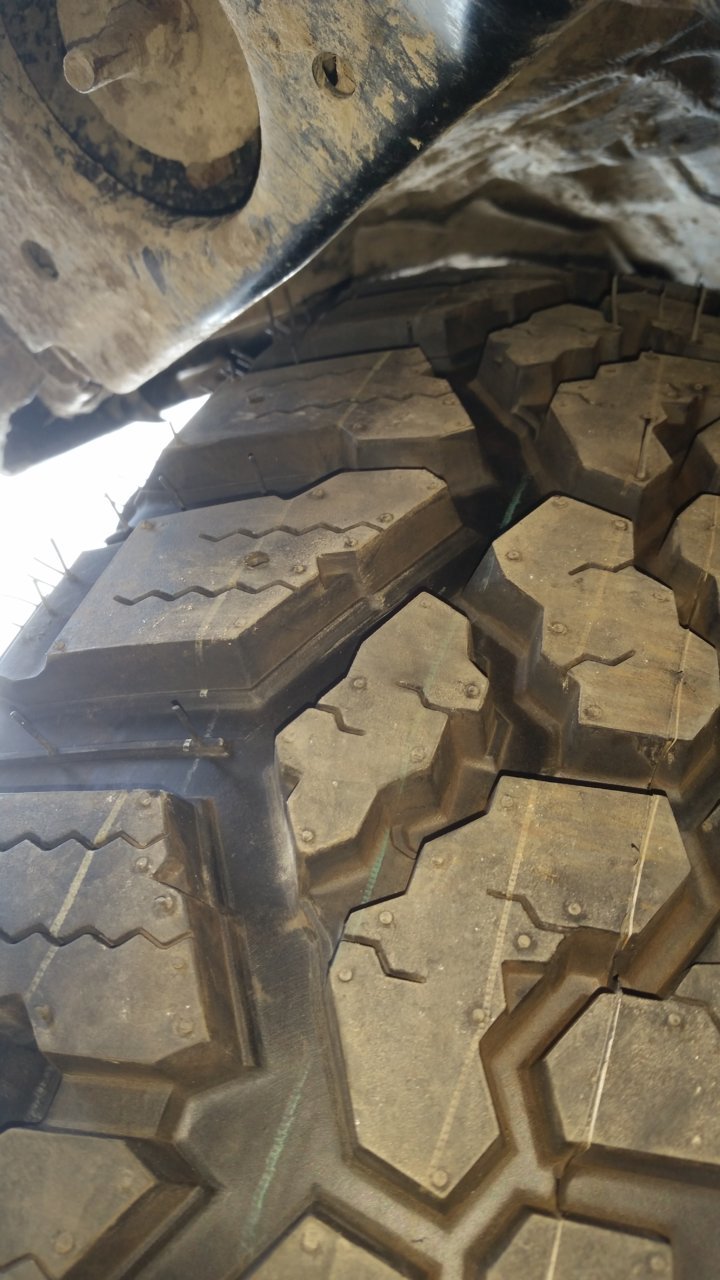

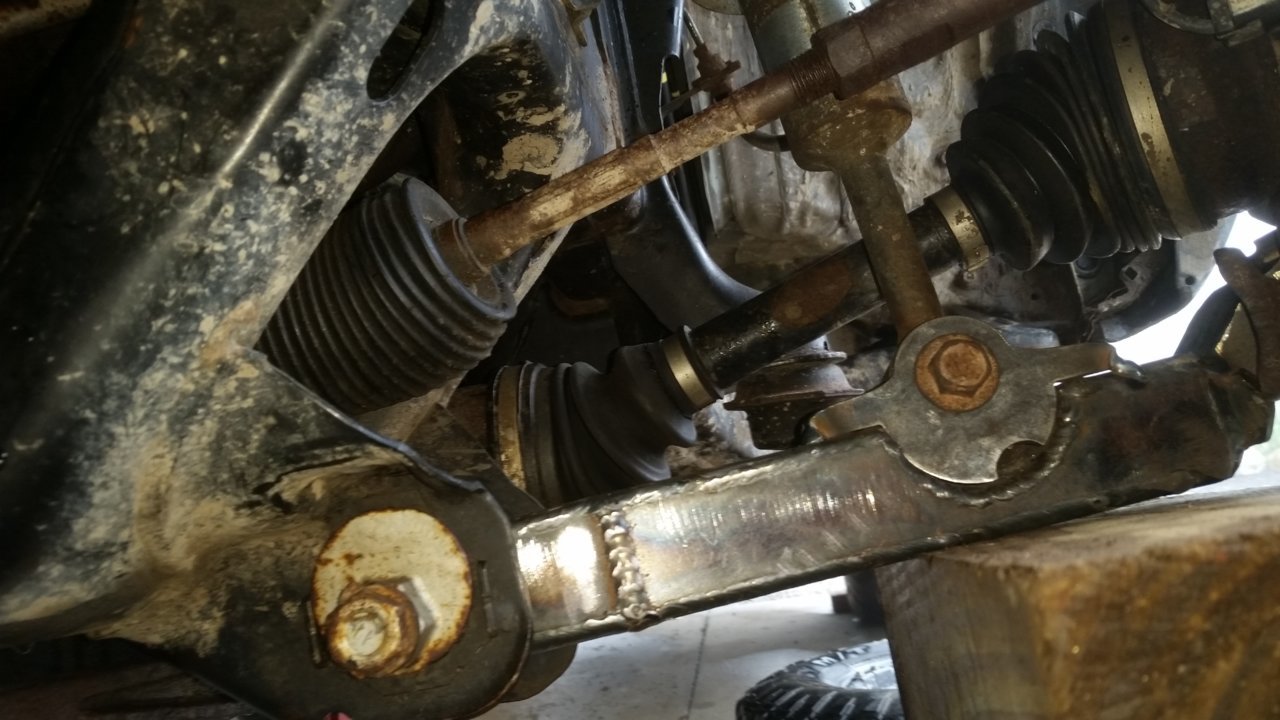

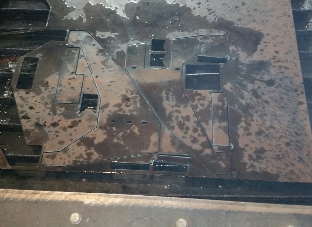

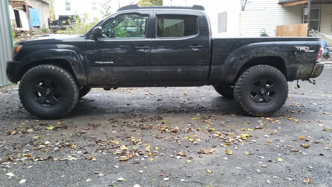

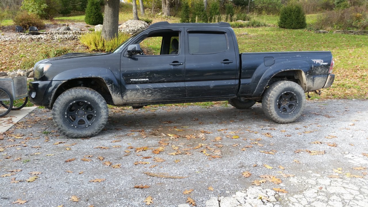

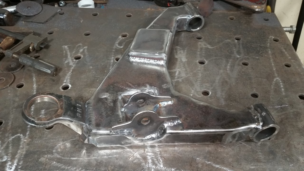

    Something I started thinking about a few years ago . This summer finally fabbed a jig up. Tires are 37's they hit the foot well seam turned , have about 1.5 ish" yet to go . The bumper/flare is definitely a clearance issue. 35s should fit with no problems. The wheel is an original 1.25" spacer to center wms in center of wheel. Last pic is of the cab mount from underneath and it clears and has not been chopped. Going to make some cut file changes in the morning and cut the passener side to simplify assembly. Will add a few more pics , have to sort them out.

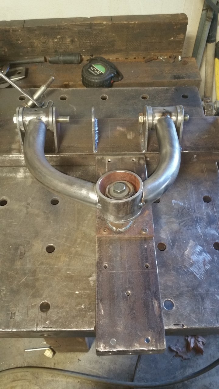

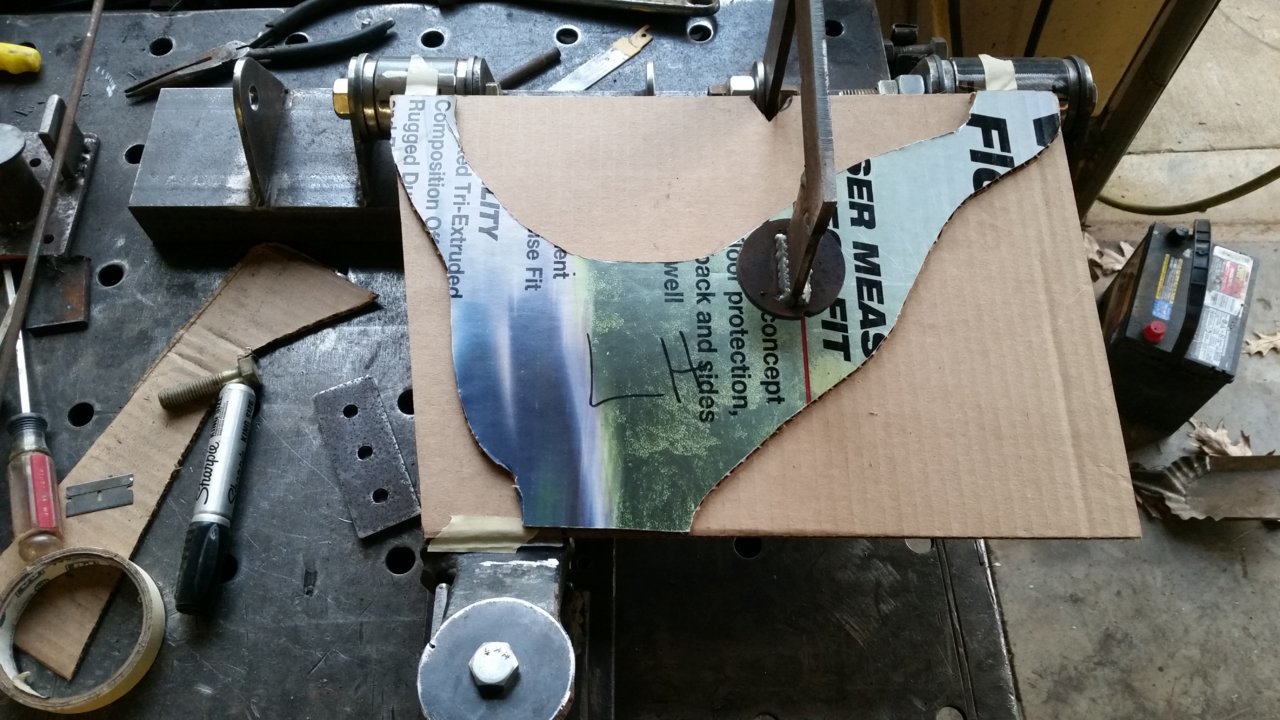

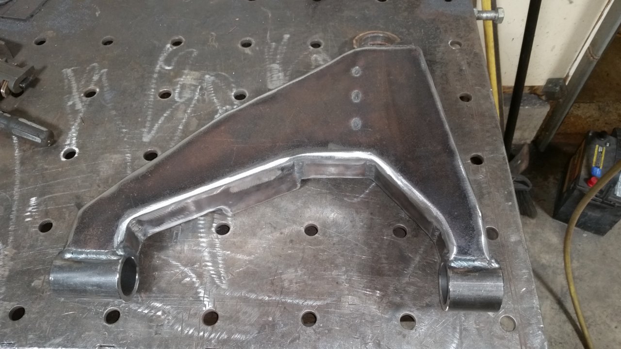

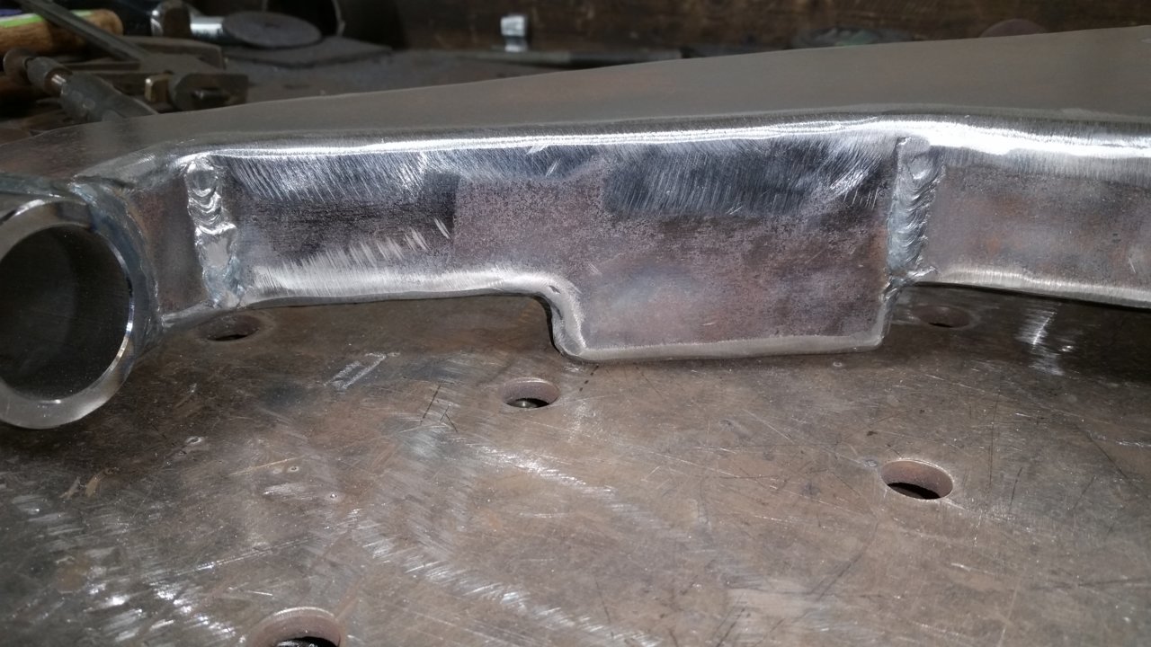

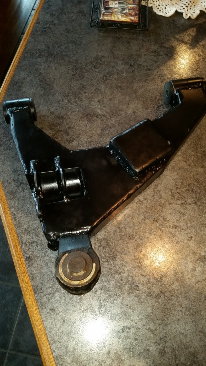

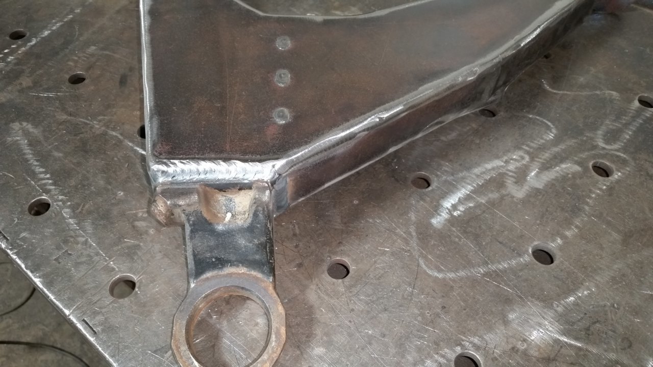

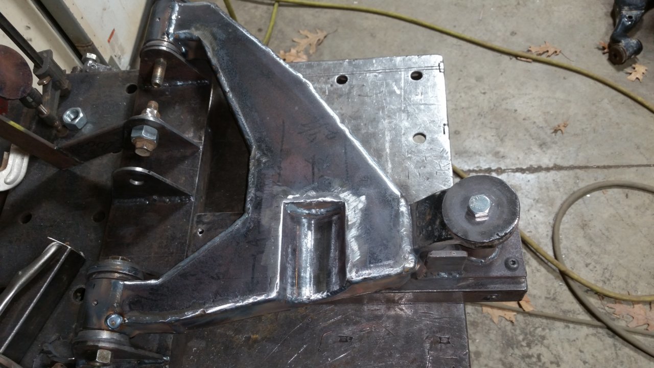

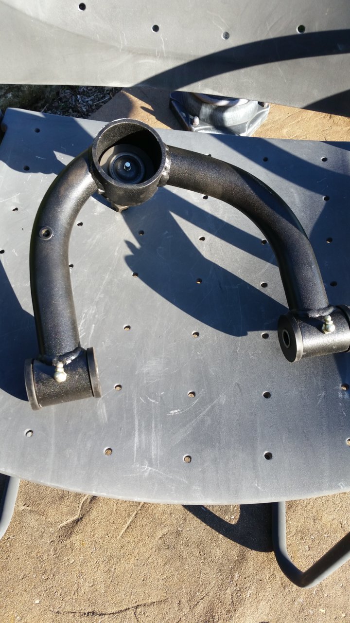

    The lowers are all cut from 3/16" with 1/4" dom bushing sleeve kits. Upper are all .120 wall for now . May draw up and cut them too for a boxed welded style? If you have a good eye and pay attention to the cardboard you will see what's going on.

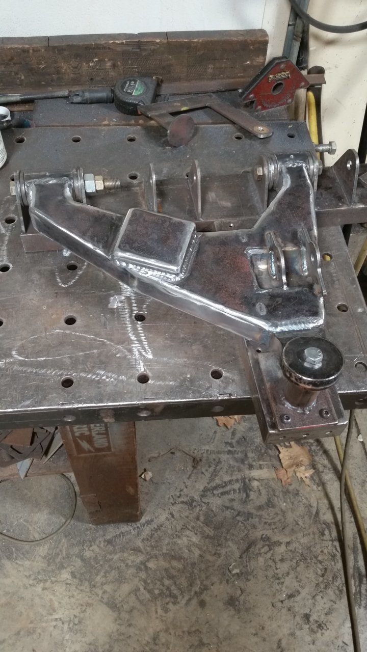

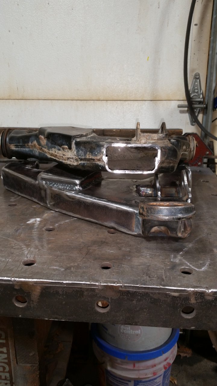

    Made a bunch of small changes to cut file and welded it up this evening passenger side is much nicer than drivers, but dimensionally they are the same . When the time come's for the next set may add a few tab and slot alignment points. Tomorrow they should be on the truck .

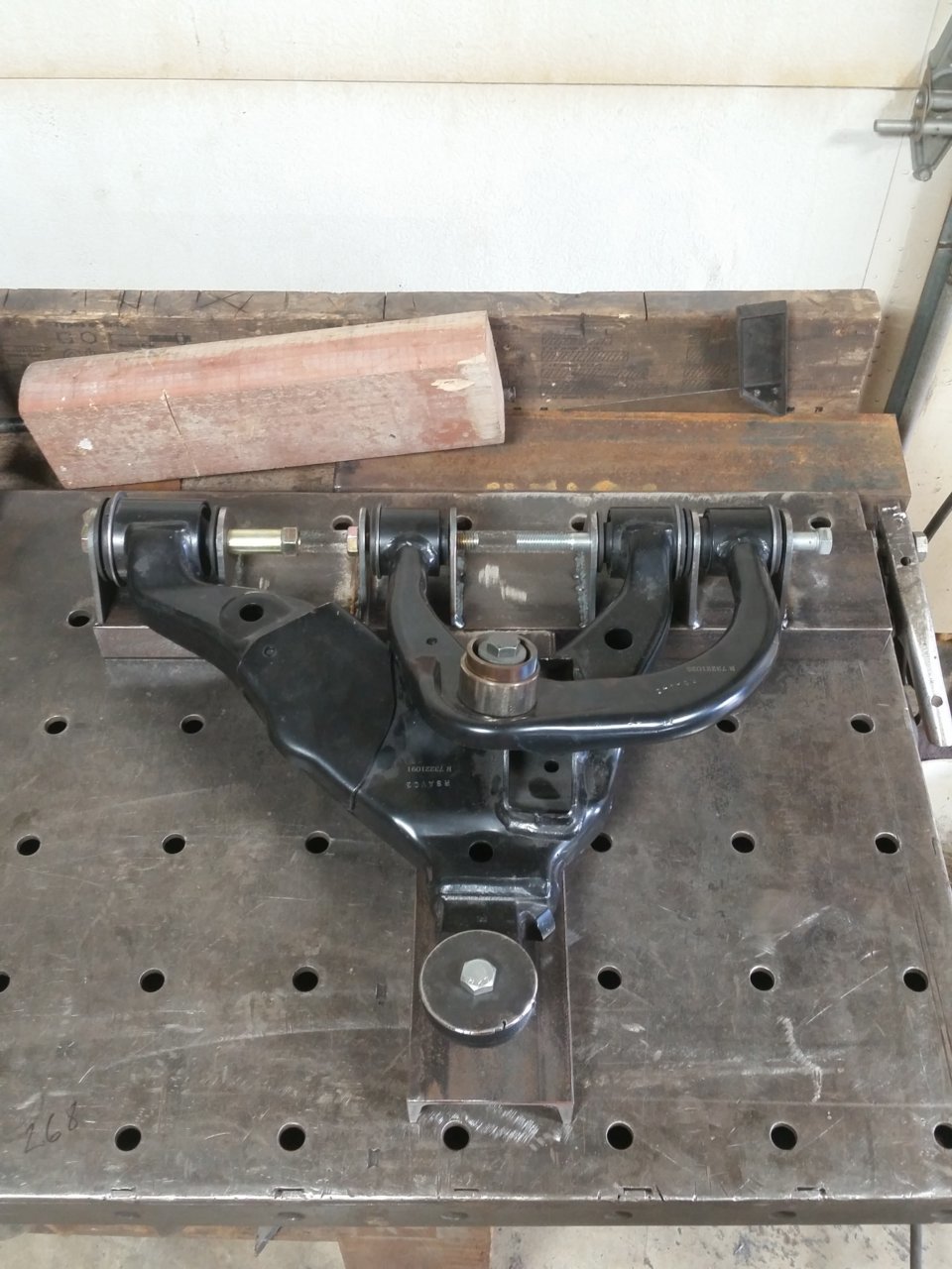

    Just to be sure I understand correctly your new arms are retaining the stock mounting points on the frame, correct?
    got any pics comparing your arms to OEM?
    Edit:just realized the last pic is a comparison with the LBJ cut off

    Yes keeping the stock mounting points. Instead of asking how big of tires can I fit ,I will just show what is possible. There are some clearance issues just below the battery tray . Mud flares on bedside . I have an old 35 on a 15" rim I want to put on just have to pull caliper. But I'm quite sure a 35 will fit with no chopping cutting anything. Only reason for 37"'s is to run for a year to get fuel milage calculated with the added weight of all are gear /bumpers and what not. Winter of 22/23 it's all getting cut off for super duty axles . Been working on a bolt in sub frame to mount all the stuff. The plan is to be going out west for a month and half drive it ,live out of it and wheel the shit out of it. 1st is the 285s75r16
