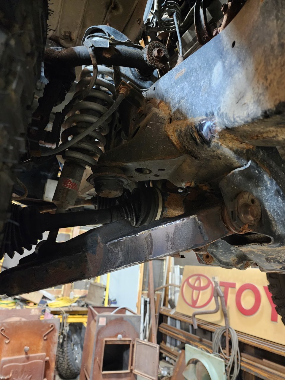

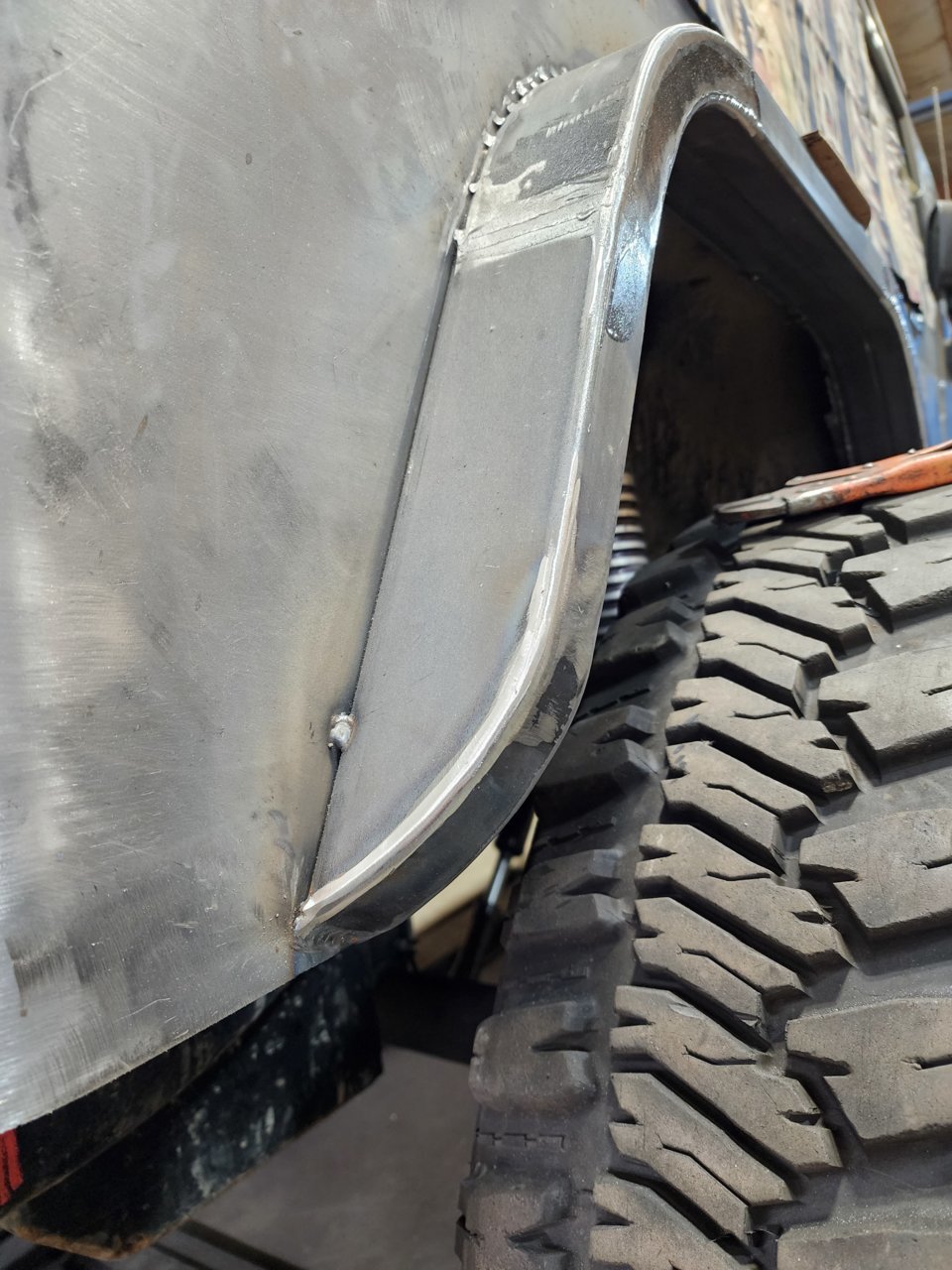

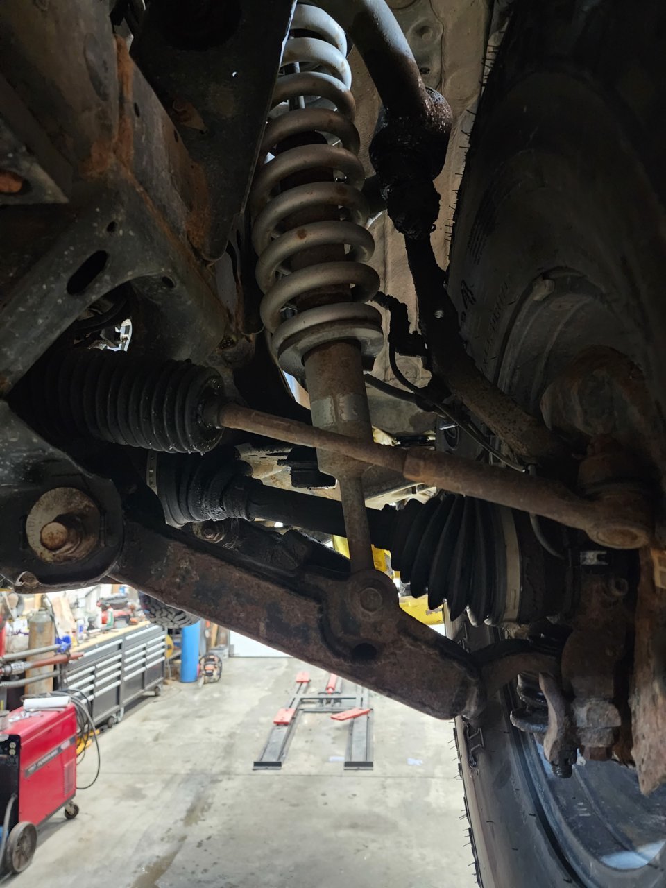

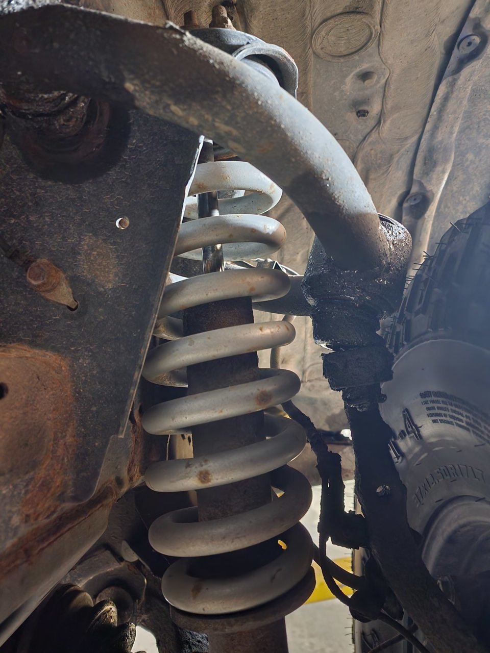

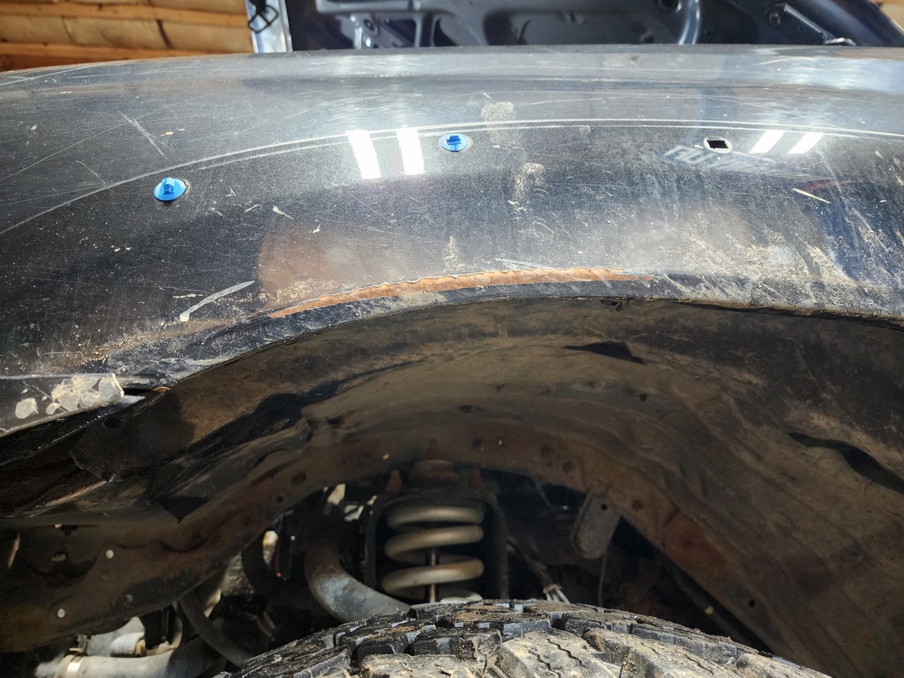

    Just figured I would give some what of an update. The jeep project left for a few months. Brought my truck in for oil change and some grease. Inner cv boots are shot but not from what I did that were almost cracked through a year ago. Still on the original tres. No noise unless the tires hit the fender and inner fender back edge of battery area or some squeak when they just kiss yhe frame rail and the lower arms(round 2 is going to be changed a bit so 35s will clear the arms, but 37s will for sure still rub yhe frame)In the rear I did end cut the bed sides for a rear bumper which I have been drawing some on it . The tires have rolled the front part of bed side in a bit if I'm loaded with fire wood and get torq . Here's some pics from the other day.

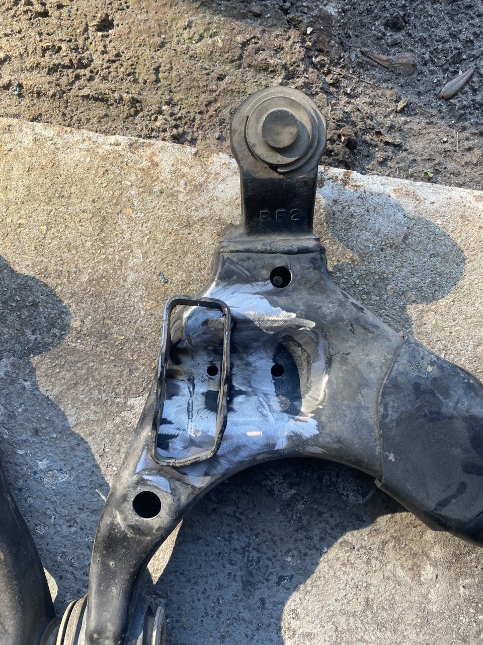

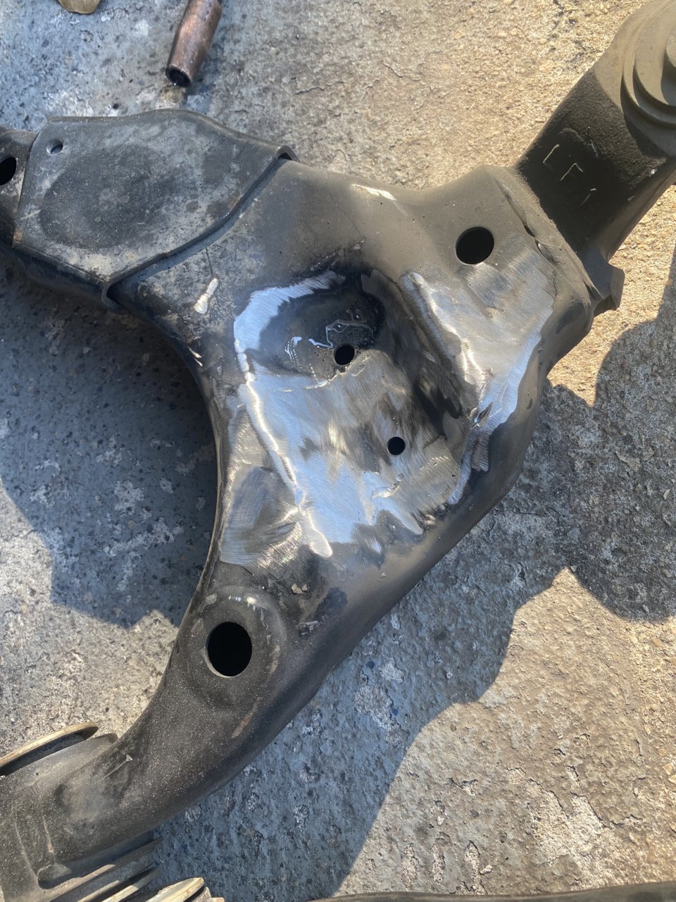

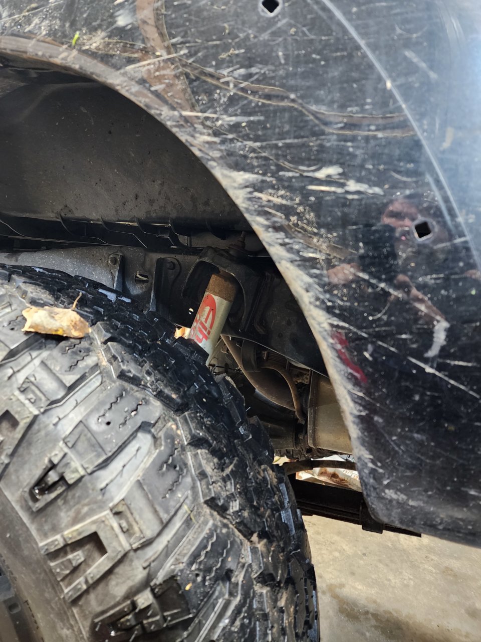

    Back side where the tire rubs. The lowers I'm also going to make 3/8" longer so when the camber is good the eccentrics are dead nuts in the middle/zero.

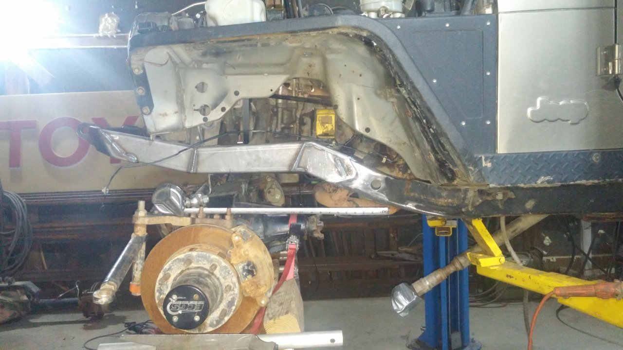

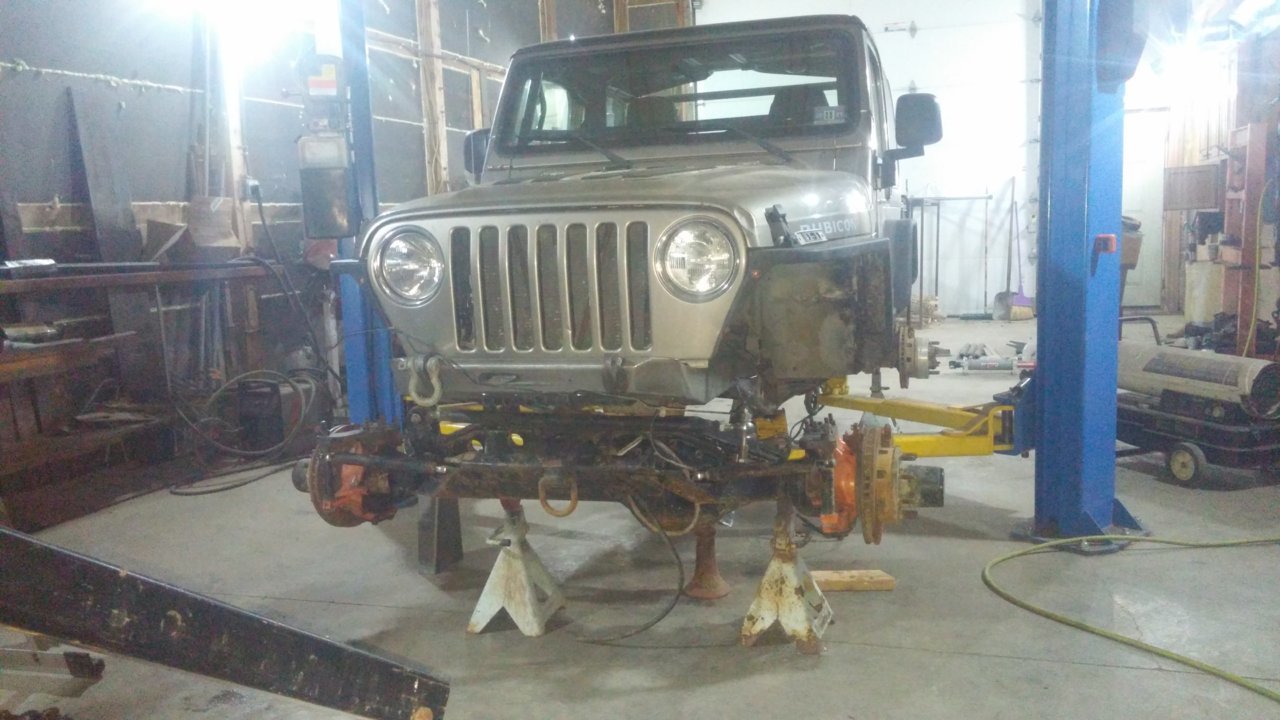

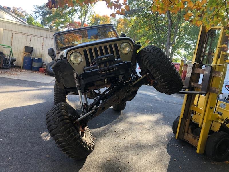

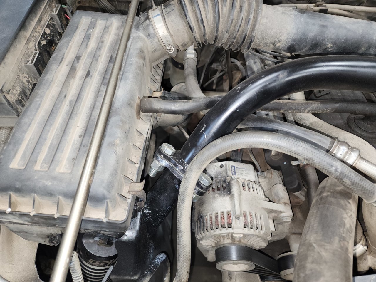

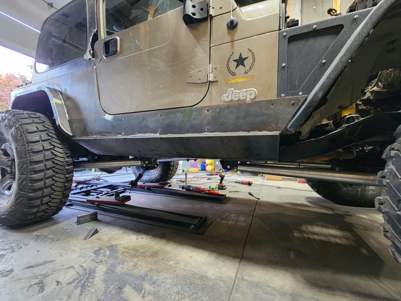

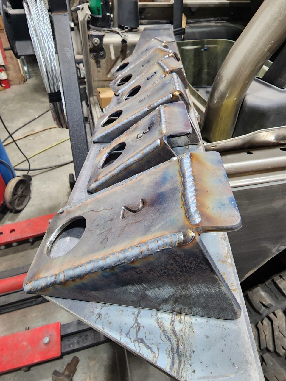

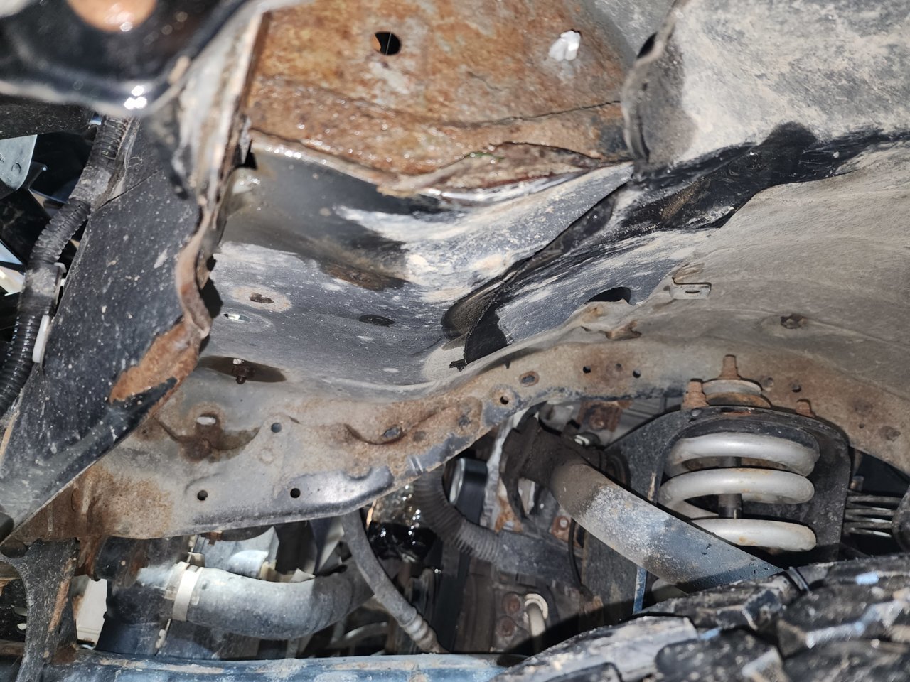

    Some pics of the crap now i have to change this jeep. Took it out for a beat down Columbus weekend and nothing broke or leaked. 0303221549.jpg
