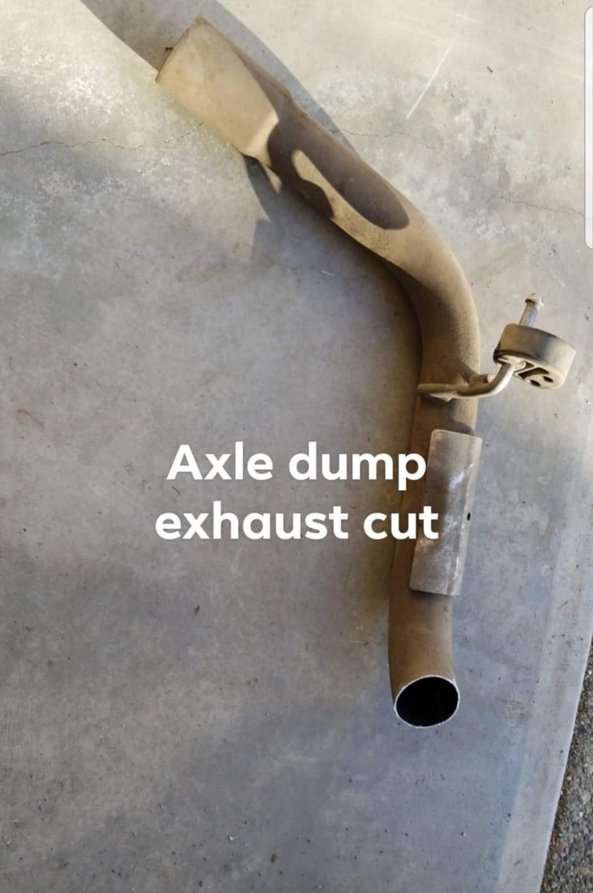

    I also wanted to axle dump the stock exhaust to improve rear clearance since I hit the tail pipe several times while offroad and to improve my clearance for the larger spare tire. I first attempted to use an axle dumped MBRP exhaust I bought used but it was way too loud for my tastes. The stock exhaust did not increase the cabin noise any that I can tell after I cut it compared to uncut.
    After some forum research, I went at it to shorten the stock exhaust and relocate the hoist an inch or so to the rear to have more clearance for the spare tire.
    Cutting exhaust
    • Supplies
      • Sharpie
      • WD-40
      • Drill with 14 mm socket
      • Cutoff wheel
      • Files
      • Gloves
      • Safety glasses
    • Instructions
      • Mark on the tail pipe where you want to cut with the sharpie, I cut it right over the rear axle after it turns facing down
      • Apply WD-40 to all exhaust fasteners, hangers, and rubber insulators
      • Remove the bolts from the rear flange of the y-pipe with the drill and 14mm socket
      • Remove the hangers from the rubber isolators and remove the stock muffler and tail pipe. It helps to have someone help wiggle it out of the rubber insulators and remove it over the rear axle
      • Use the cutoff wheel to cut off the tail pipe (my cut wasn't the cleanest but no one will see it!)
      • Use the file to clean up your edges
      • Reinstall (much easier now) by sliding the hangers back into the rubber isolators
      • Retorque the 14mm bolts

    Cutting exhaust

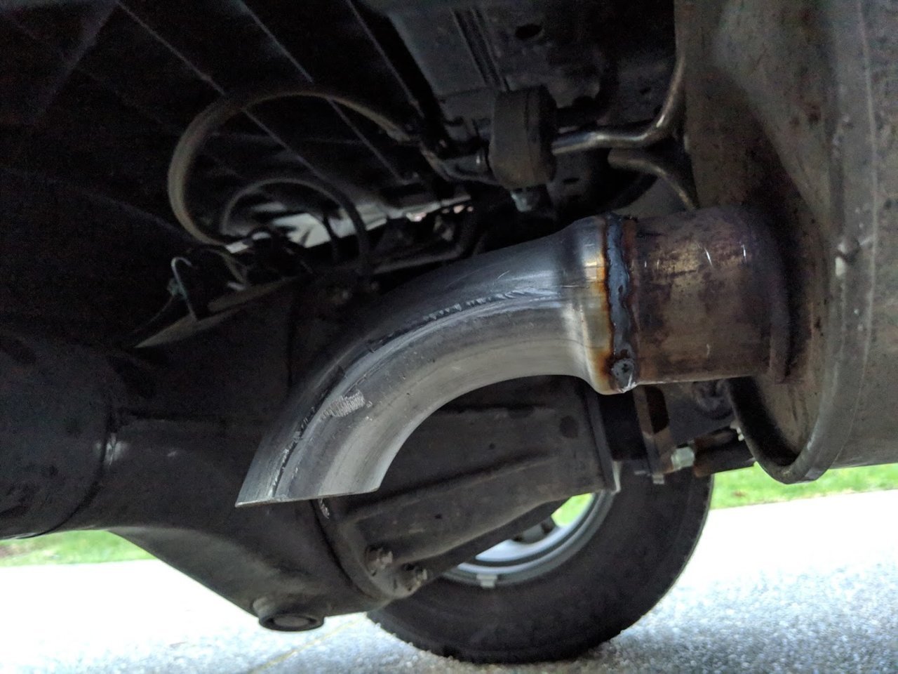

    Nice work. I cut my exhaust like that yesterday for the same reasons, and attempted to dress it up with a polished tip, but it didn't fit the pipe. So back to the drawing board on that. I was also thinking about fitting a bigger spare in there, so I'm glad you did that too.

    In the past I chopped my exhaust in the same location as your picture below(on a different vehicle) and eventually wound up having to reroute it. During sustained highway driving where the truck was at mid to high rpms the exhaust would heat up the rear axle, spare tire etc. so hot that you couldn't touch it. The rear driveshaft u-joint started burning through its grease in a matter of days. I wound up having an exhaust shop route the tip just over the axle in between the spare and the axle but at a new angle to avoid the spare but still high enough that it wasnt hanging down below everything like the stock setup. I highly suggest you pay extremely close attention to this.

    Good info. I did the same using the stock exhaust:
    I checked the axle initially, but have not checked it after long runs. I will do that.
    I did get another take off stock exhaust incase I ran into problems.
    Also, I did want a mandrel bent tip, but . . .
    I do get a bit more rumble from the exhaust, but not much. Basically, just enough that I no longer think about a cat back.
