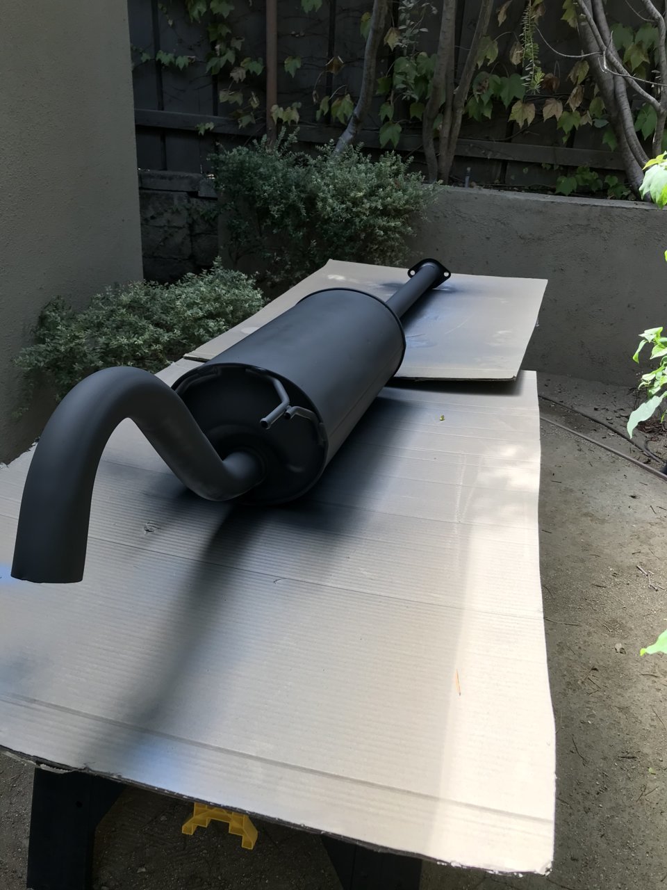

    I ended up grinding the dried AZ mud and rust off my old exhaust/muffler, cutting it, and painting it with high heat primer and then Rustoleum 2000degree high heat paint.
    Before and after.

    26
    SoCal
    Same here.

    I like your cut!
    And, this post should be stickied somewhere! :thumbsup:
    Thanks, OP!
